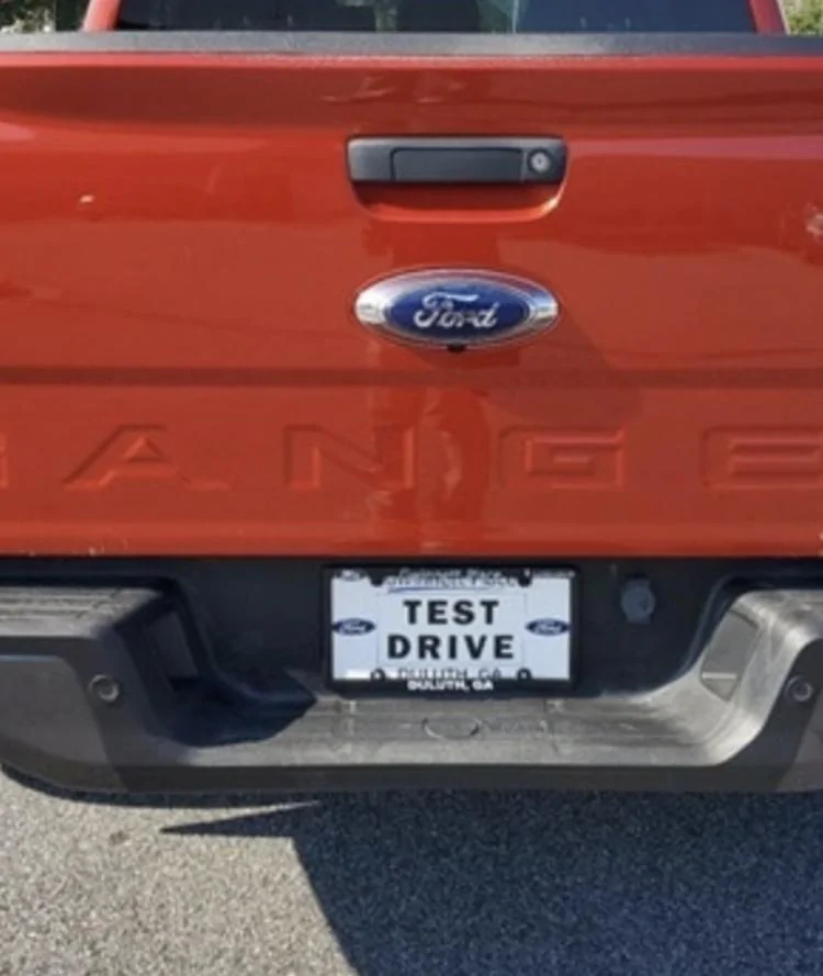

Bronco hitch isn’t really bumper mount same way as the ranger though. It’s mounted to the frame with square receiver that comes out under the bumper. It’s just mounted on a crossmember instead of bolting to both frame rails, but still mounted to a welded on structural piece. Ranger is literally just the bumper bolted on is the hitch when you don’t have the optional tow package to add a hitch. There’s no square hitch receiver. It’s just like older trucks where there was just a hole cut out in the bumper where you could mount a hitch ball, rangers got a hole in the middle of the bumper. So the bumper itself is rated to hold 3500lbs before it rips off the truck, the hitch in the tow package then mounts to the frame rails so no weight is on the bumper when towing. You can see in this pic the circle in the middle is just a cover over a hole to mount a ball hitch.
Ford Bronco Bronco towing vs Ranger, why the difference? CAF90EA4-ED4B-4B3F-B2B0-F24C7218E70D
So when ford towing guide says 3500lbs max when towing with bumper only, it literally means pulling by the bumper. But yes without a hitch that can tow more than 3500lbs the bronco will never be rated any higher. But that could literally be the only thing making the rating so low, without ford actually saying so there’s no way to know for certain if anything else is limiting it that much. If ford made a real hitch, mounted to the frame rails then maybe we’d get a tow rating based on what it’s actually capable of, then could really see if there’s anything else limiting it or if it’s capable enough even as is. Otherwise we’re just left to speculate.
