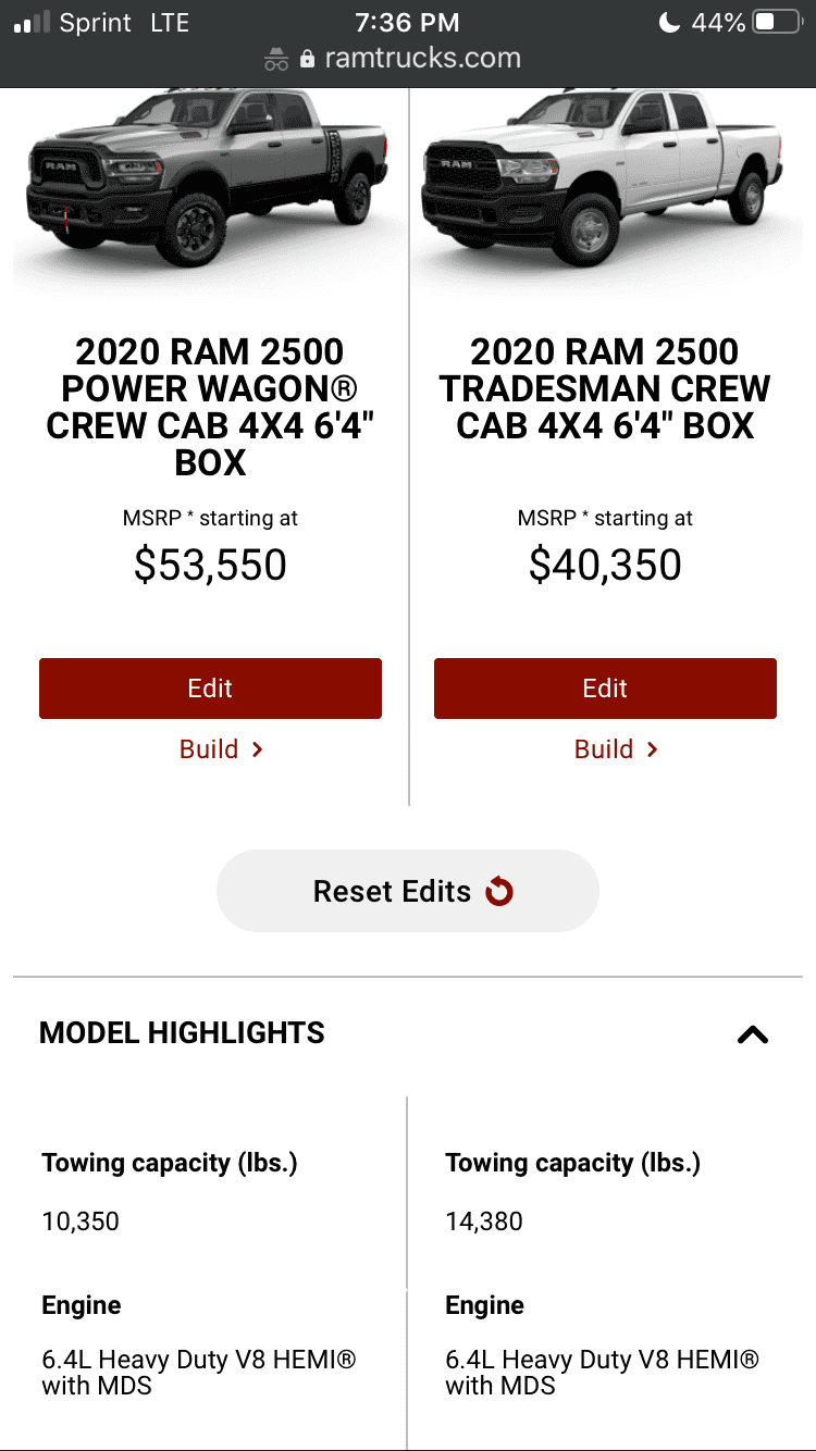

I'm gonna go with suspension. Off road oriented vehicles generally have softer spring rates for better off road compliance. For example, look at the Ram 2500 with the 6.4 hemi. The Power Wagon, an off-road "specialist" has a max payload of 1420 lbs with a max tow rating of 9470 lbs.
The other trim versions of the Ram 2500 crew cab 4x4 with the 6.4 hemi, 4:10 gears and the 6' 4" bed have max payloads ranging from 2710 to 2990 lbs, and max tow capacity ranging from 16450 to 16780 lbs. So the Power wagon has roughly half the payload and 2/3 the towing capacity of any other vehicle in their lineup in that configuration.
Power wagon only comes with 4x4 and crew cab and 6’4” bed, and on 2020 models from rams website shows 10k tow cap. Compare with any other 2500 with the same setup(4x4, crew cab, 6’4” bed) and the highest I got it to is 14k tow cap, so power wagon is just over 70% what the tow cap is in same configuration. Raptor is similarly about 70% what a f150 limited with the same engine can tow. If bronco had 70% what the ranger had for tow cap it’d be over 5000lbs. Even 2/3 would be at 5k. I’d be fine with that.
