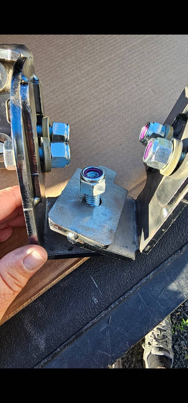

Mike I listened, thank you they have given me peace of mind. And I bet they saved me when I was winching out trees in my yard. I was anchored to a F150 and it pulled both rigs without bending my frame.
Ford Bronco Bumper Pulled Off Bronco Screenshot_20250311_222519_Photos
