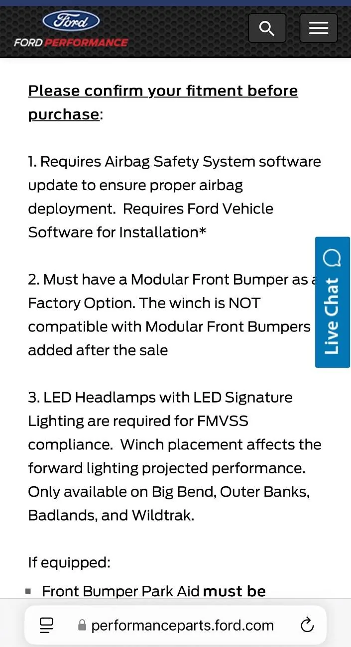

Interesting. If it was me, I'd insist they do it - for the personal liability protection. The dealership really has no skin in the game.
They do now, I made them note that airbag recalibration was not needed at this time.

Smart. Really has me curious why they would say that.
The Ford Performance Winch kit:
https://performanceparts.ford.com/part/M-1821-B
Because they only know what they know really. I was the first one at this dealership to install the factory 4/7 pin tow harness with the module that needed programming. Installed myself on a 21 then took it in for programming. You would have thought that I was bringing them a Ferrari to tune! They got it done though. Ha.
