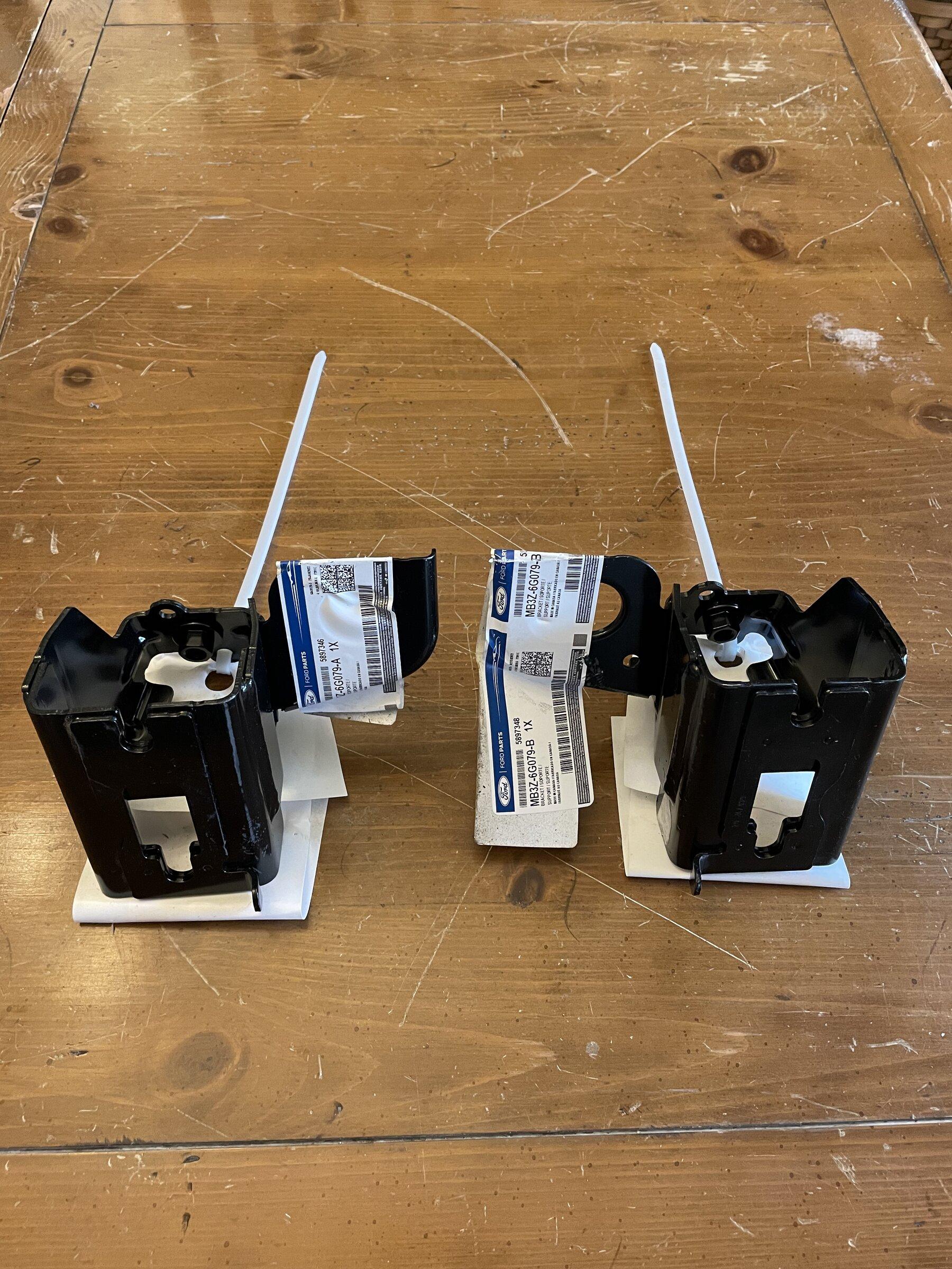

Yes. Essentially the tow hook is welded to the bracket that also supports the intercooler from the bottom. So you still need that support but the hook part sticks out about 2-3” too much and has to be cut off - or different brackets used.

Do you have the part number for the brackets? I am wanting to do the same!
Here's the part number for those brackets:
MB3Z6G079A

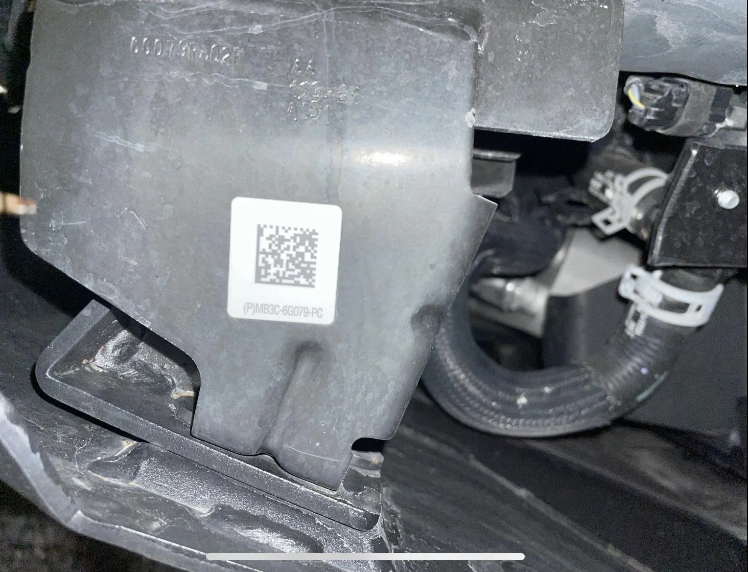

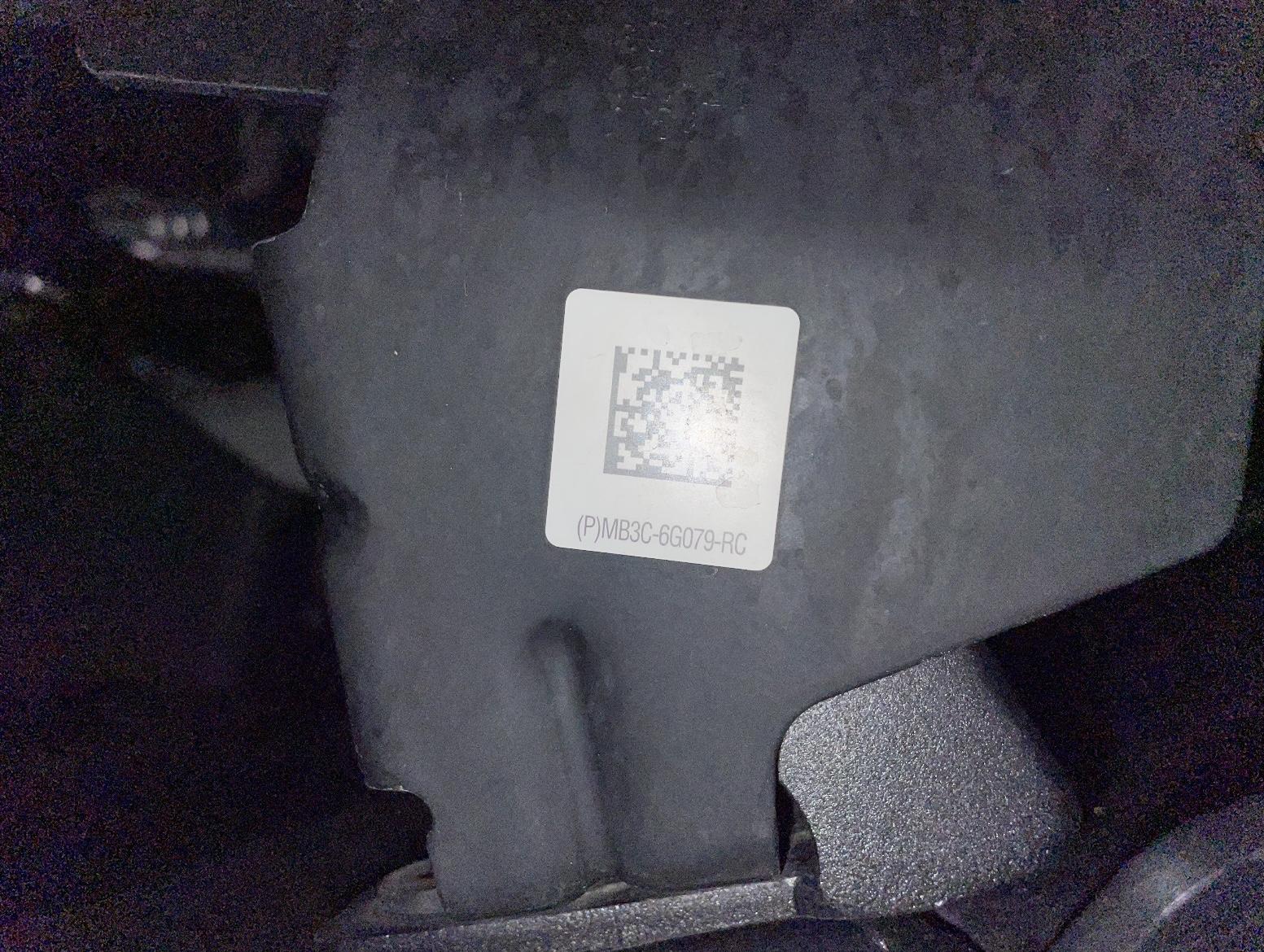

Pictures of the bracket on a factory ordered modular bumper. Not sure if this is all you’ll need, but I got pics of the part numbers for each side of the bracket that comes from the factory when the modular bumper is ordered.
My 2.7 tow hooks supported the intercooler.Not sure if other hardware would be needed on top of these two brackets.

These are the brackets you need for the mod bumper when updating from the standard plastic pumper.
MB3Z-6G079-B
MB3Z-6G079-A
