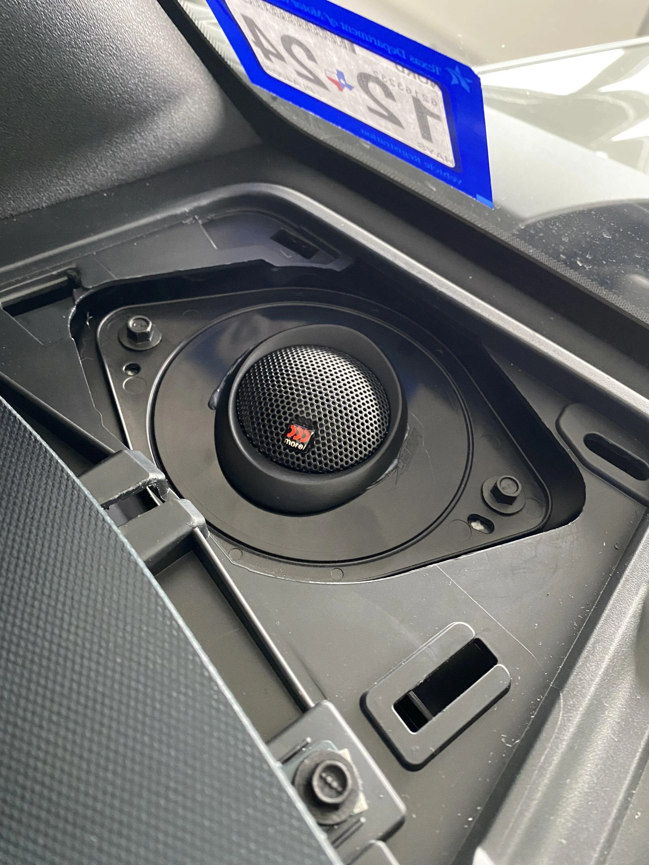

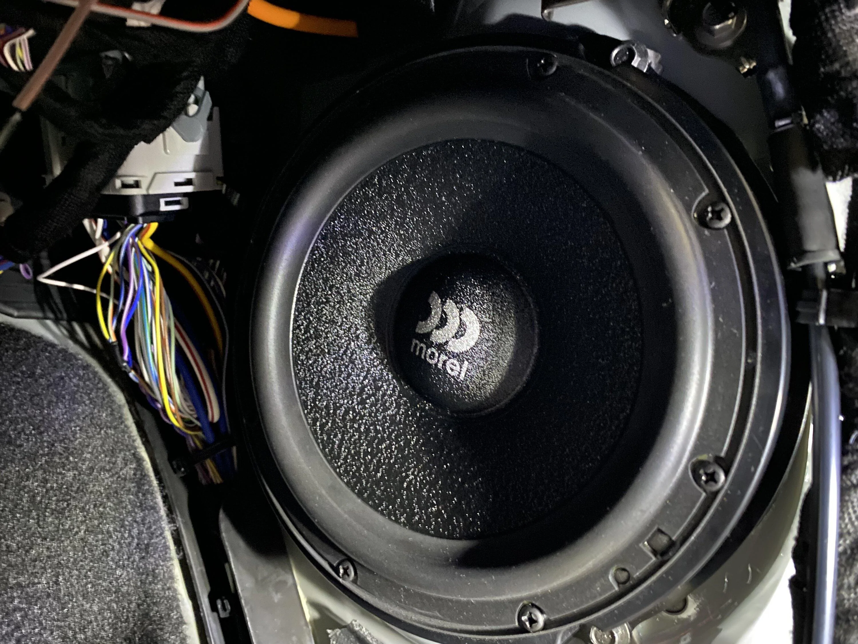

Purchased a set of Morel Maximo 6 components from Crutchfield. Included in the installation gear was a set of blank plastic plates to mount the tweeters in the dash location. Chose the Morels because they are pretty efficient at 90.5db, which I was hoping would work ok with the stock amp. They also had good reviews and price.
Install was pretty easy, basically the same as any install but you have to run some wires from the tweeters. There's plenty of open space to run wires from the dash to the crossover. I just put a flashlight underneath by the kick panel and followed the light to end up where I wanted. Wired up to the crossover and then used velcro tape to secure the crossovers to the body, up and away from everything.

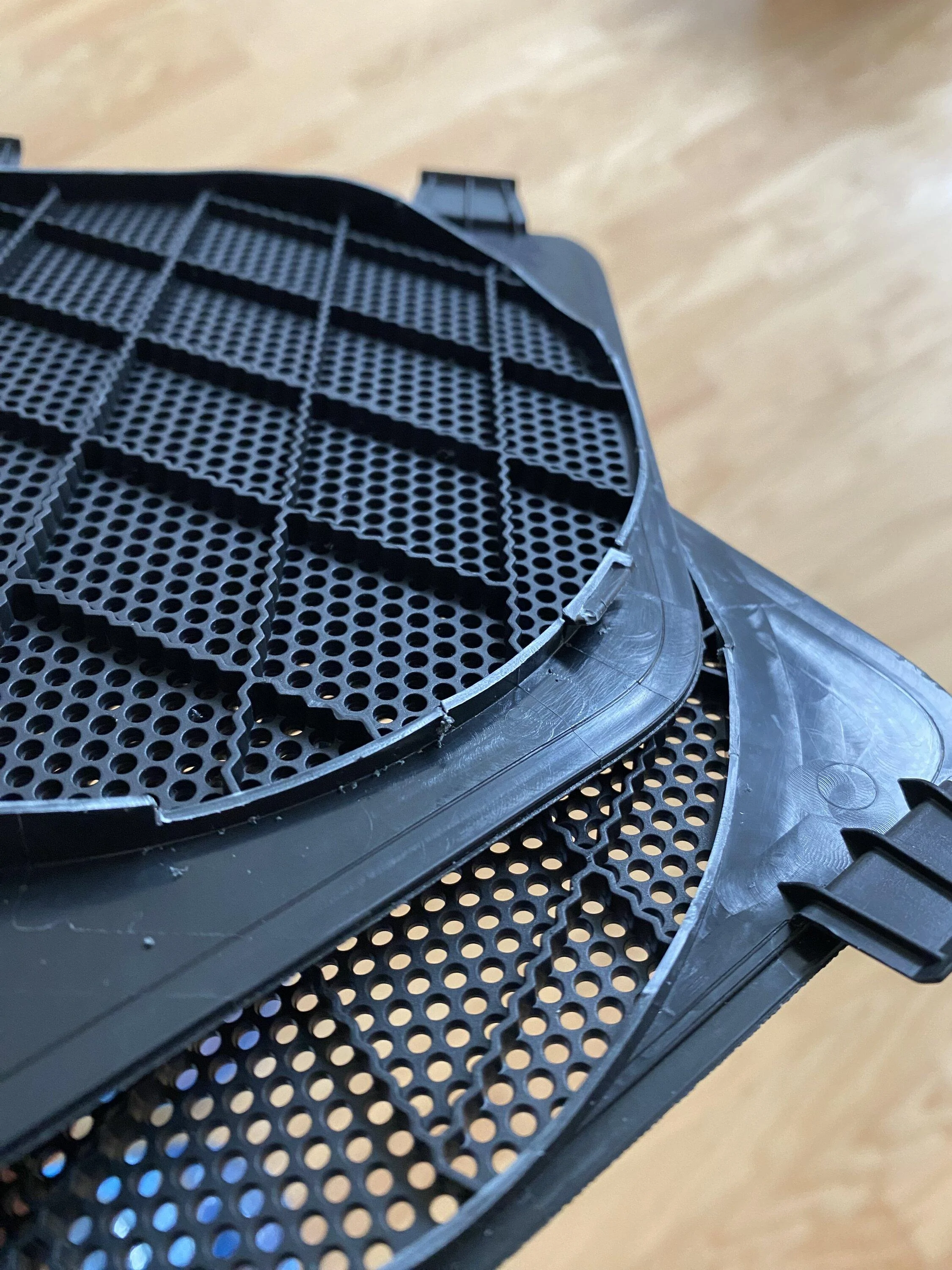

I didn't have a drill bit quite big enough for the hole I needed, so I had to do some filing down on the plate to get the tweeters to fit. I then hot glued them in to make sure they were secure and seal was good. I also shaved off some of the plastic from the kick panel cover. It looked like it was going to interfere with speakers and was easy insurance to make sure I didn't ruin the woofers.
Result - MUCH better! Finally happy with the system. Highs are more mellowed out and now it seems the rest of the system can catch up in volume. Plenty of low notes and even some nice mids now. It seems letting the Morel crossover handle the power division was an excellent choice. As of right now, I don't feel the need to add an amplifier to give them more juice. Go plenty loud and no longer hurts my ears to listen to music. If you are contemplating running actual component speakers instead of the 4" 2-way speakers in the dash and 2-ways in the kick panel, it's worth it!
