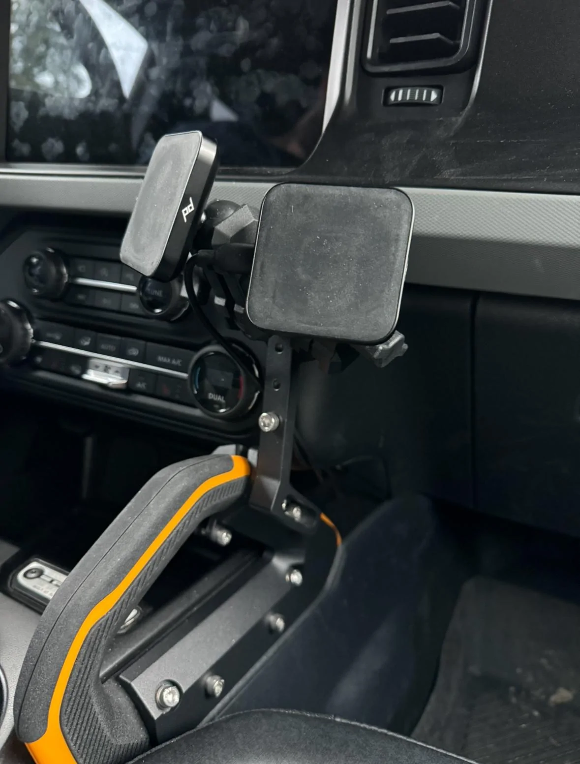

Because of the angle of the arms coming off of the dash with a rail, you get significantly more vibration and device shaking than with an arm supporting the device from below. That is my only objection to a dash rail system. If i needed to mount a ton of items, that would certainly be the way to go and you just deal w the device shaking. 👍

I don't hate it, I just don't really want my phone that high up on the dashboard. My phone holder in my cup holder has a long arm which extends it to just below the centre screen.
I think part of my issue with the rail is I haven't actually tried it or found an option I love. Something secure, but easy to remove when I get in and out of the vehicle. I'm not opposed to it, but hasn't been the top of my accessory list.
I feel the same way, especially with regard to the quick insert and removal when in and out of the truck a lot. Any arms leveraged off the dash concern me with that load transfer as you pull at the device over and over again.
What I made is so rigid that it doesnt move when i pop the phone in and out, so i dont feel the need to support the arm or cradle to manipulate the phone. Its been the first phone solution ive been totally happy with.

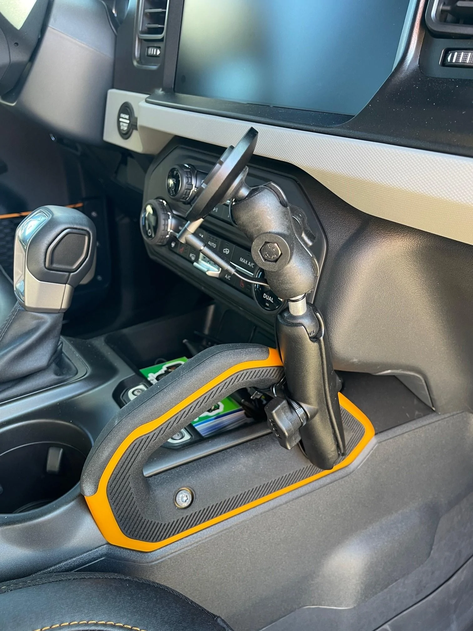

We did something similar using a motorcycle RAM handlebar mount w/ M8 screw. (I hope that's right, I dug through my spare parts bin) and a short, a long and a ball connecter, topped with a Quadlock charging MagBase. We had to use a zip tie to keep snug against the Bronco OEM handle.
Seems like alot of work, but it was perfect for my needs. Kept the phone away from the passengers and in perfect reach for me, ...and charging!
Nice.. i dont use the magbase system but would adapt mine in a similar way if i did. Looks good!
