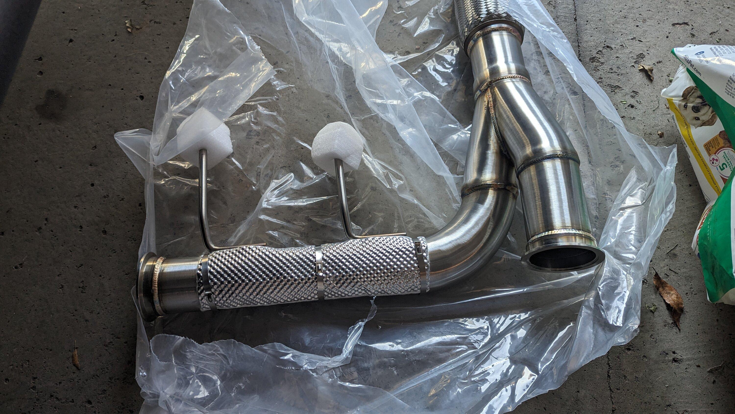

Here you can see the welds, the entire system is beautiful with zero flaws that I could find.

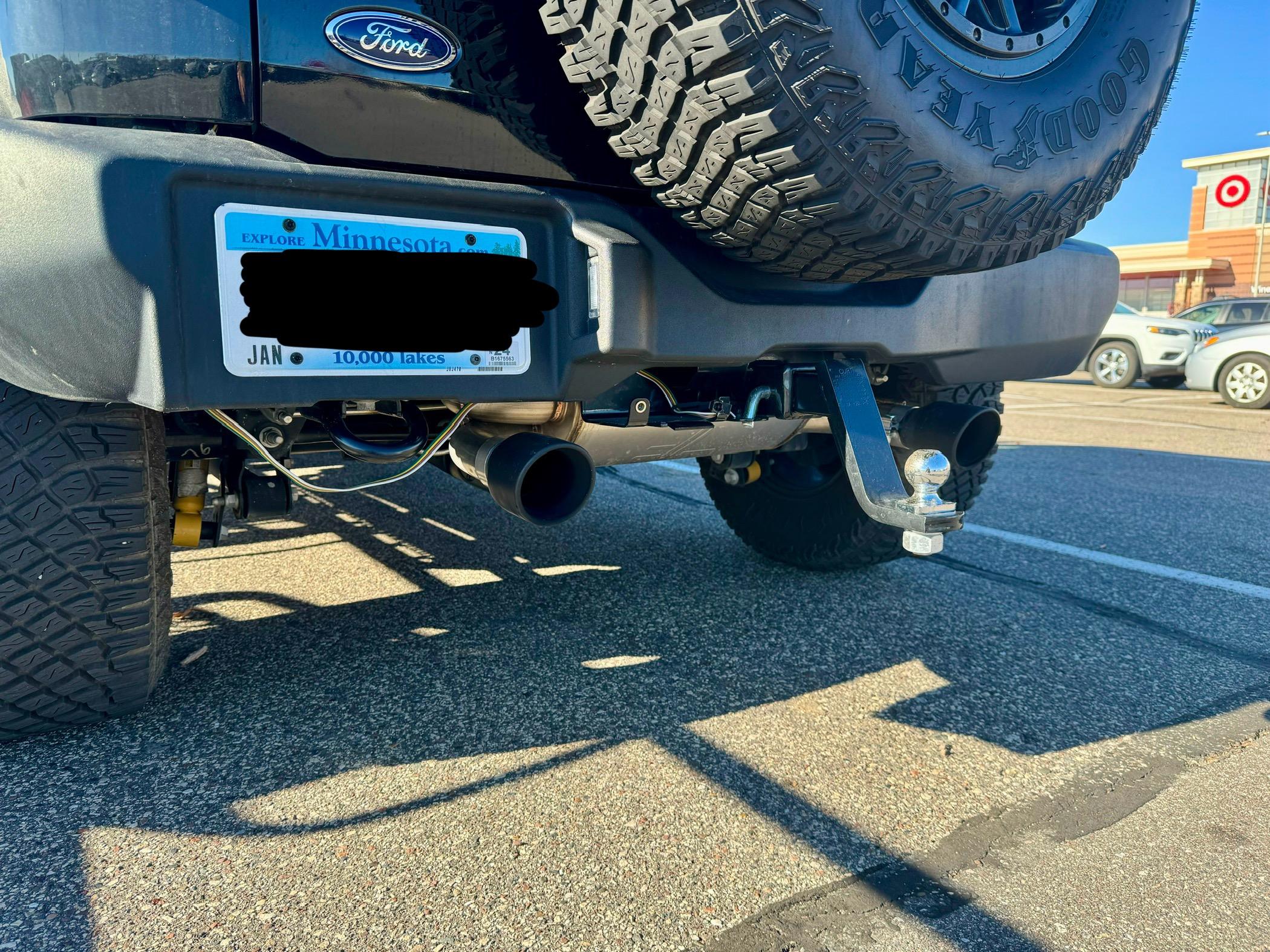

Ground clearance and exit angle are reduced I believe, here is a pic of the exhaust tips but I did not take one of the stock system at this angle so I'm not 100% of the change, good or bad.
