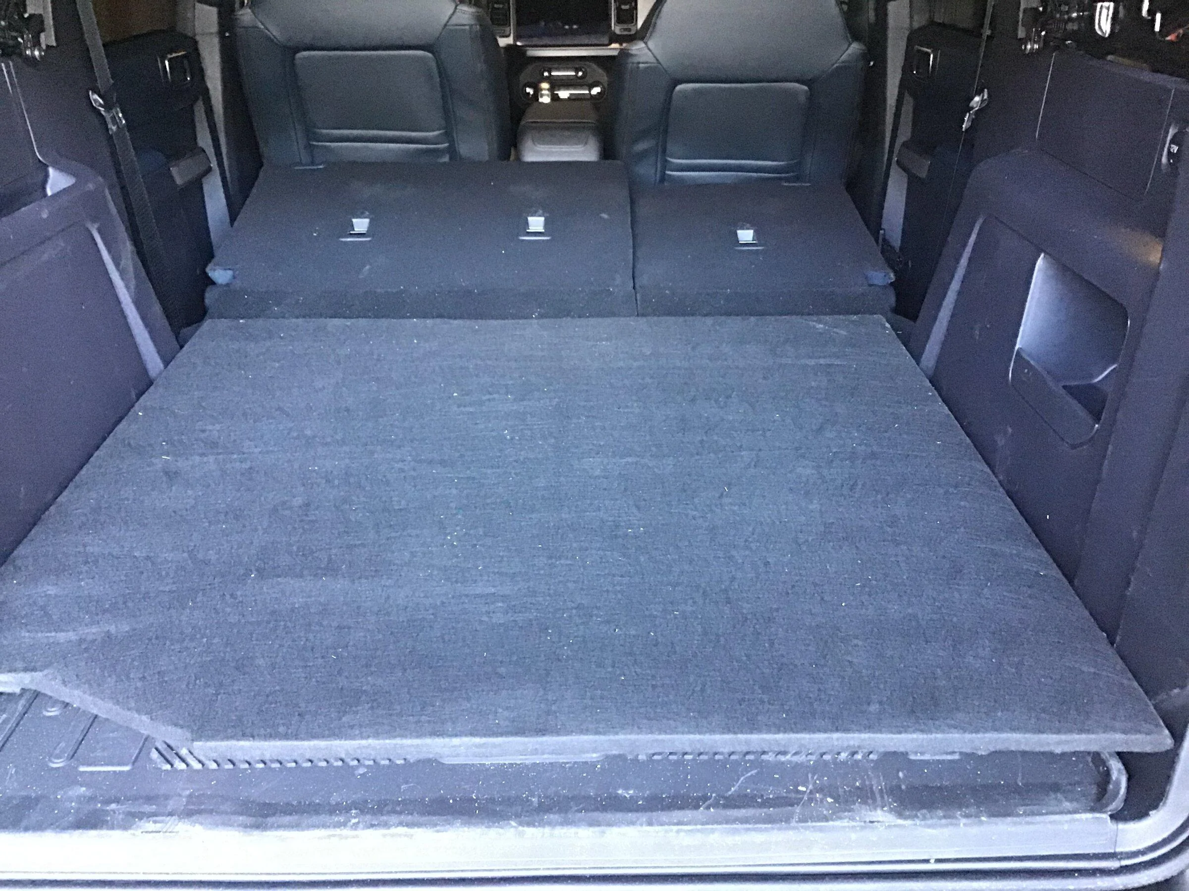

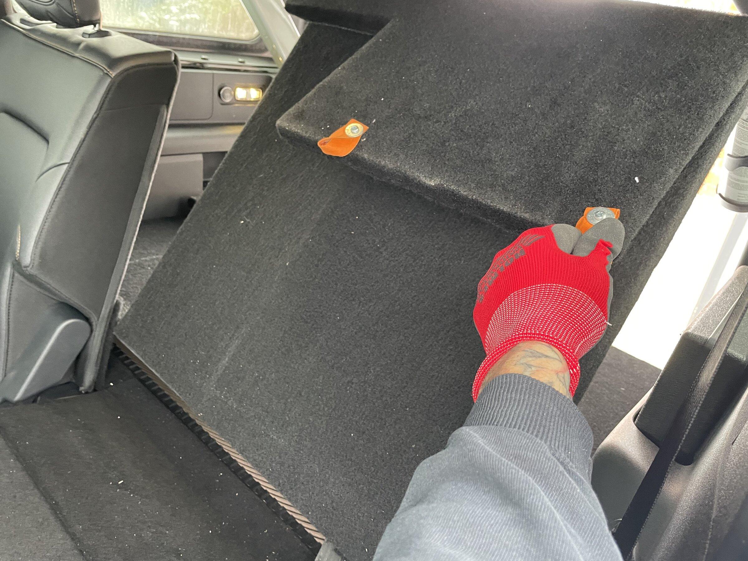

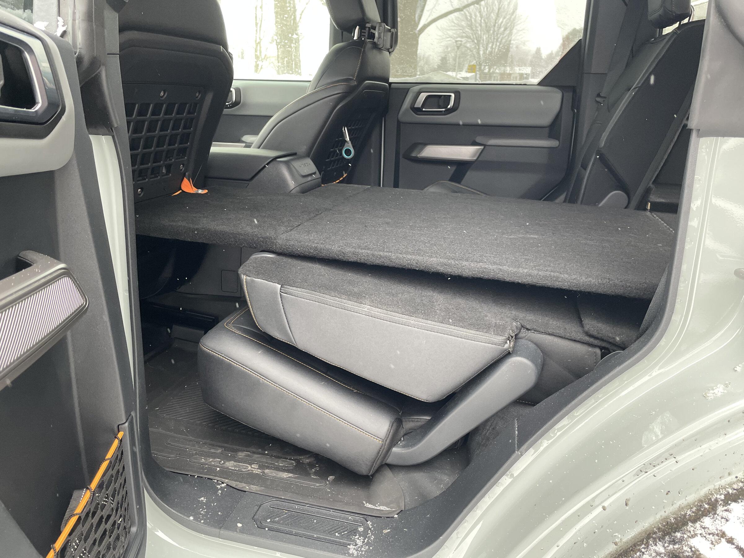

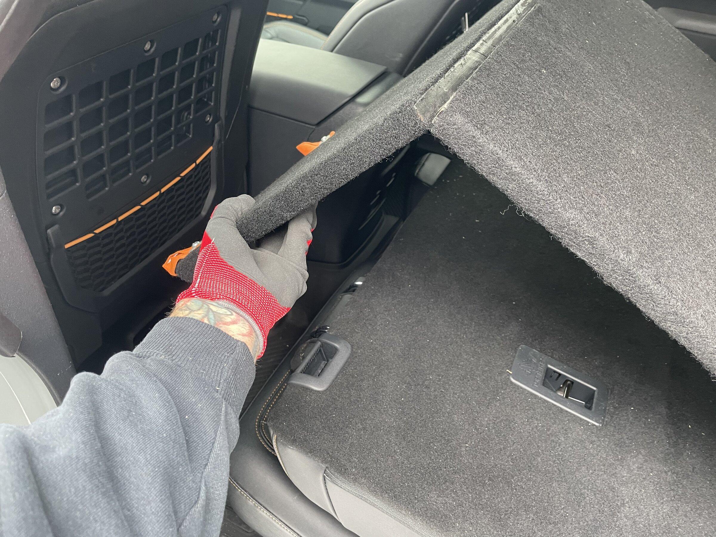

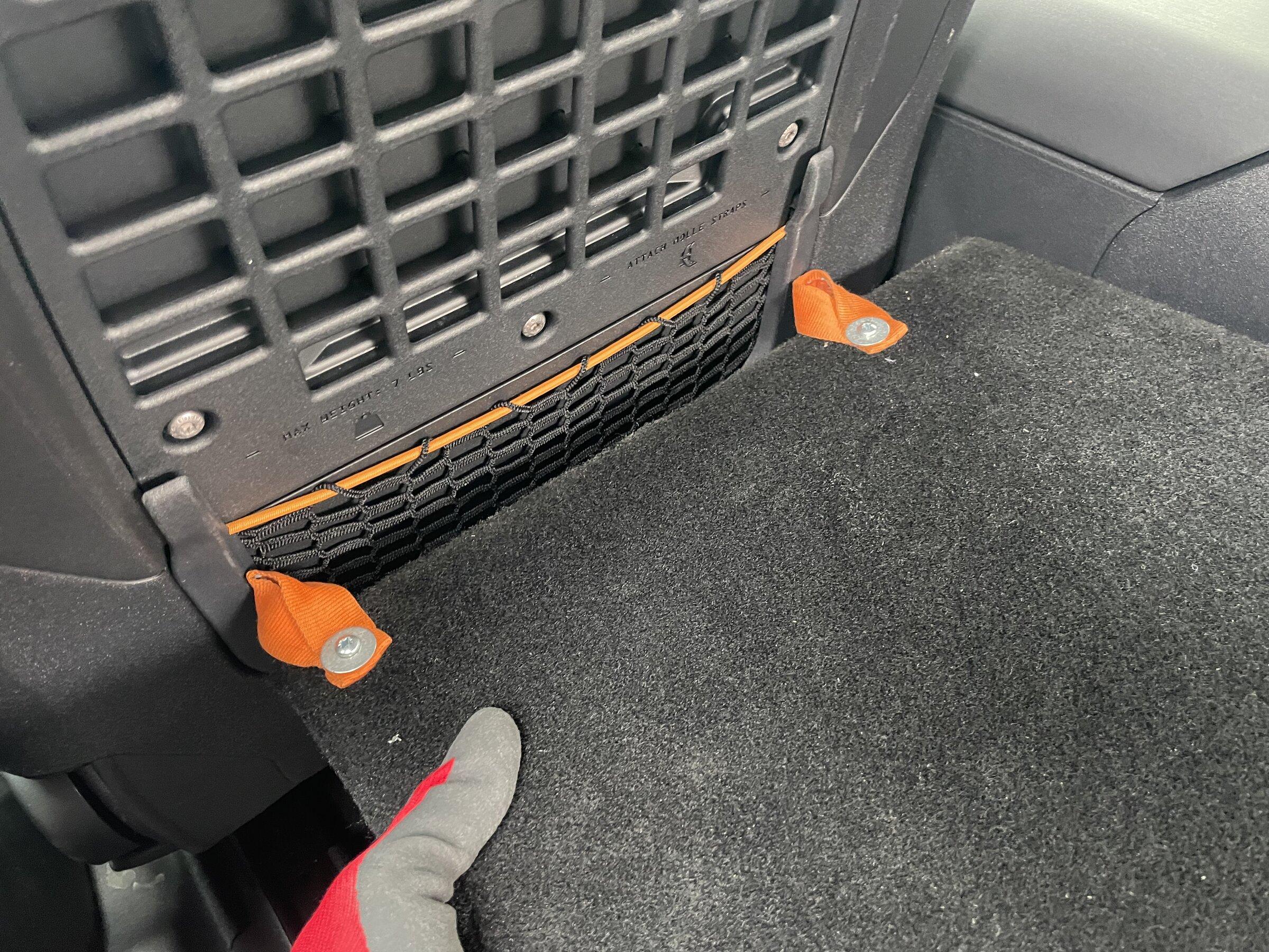

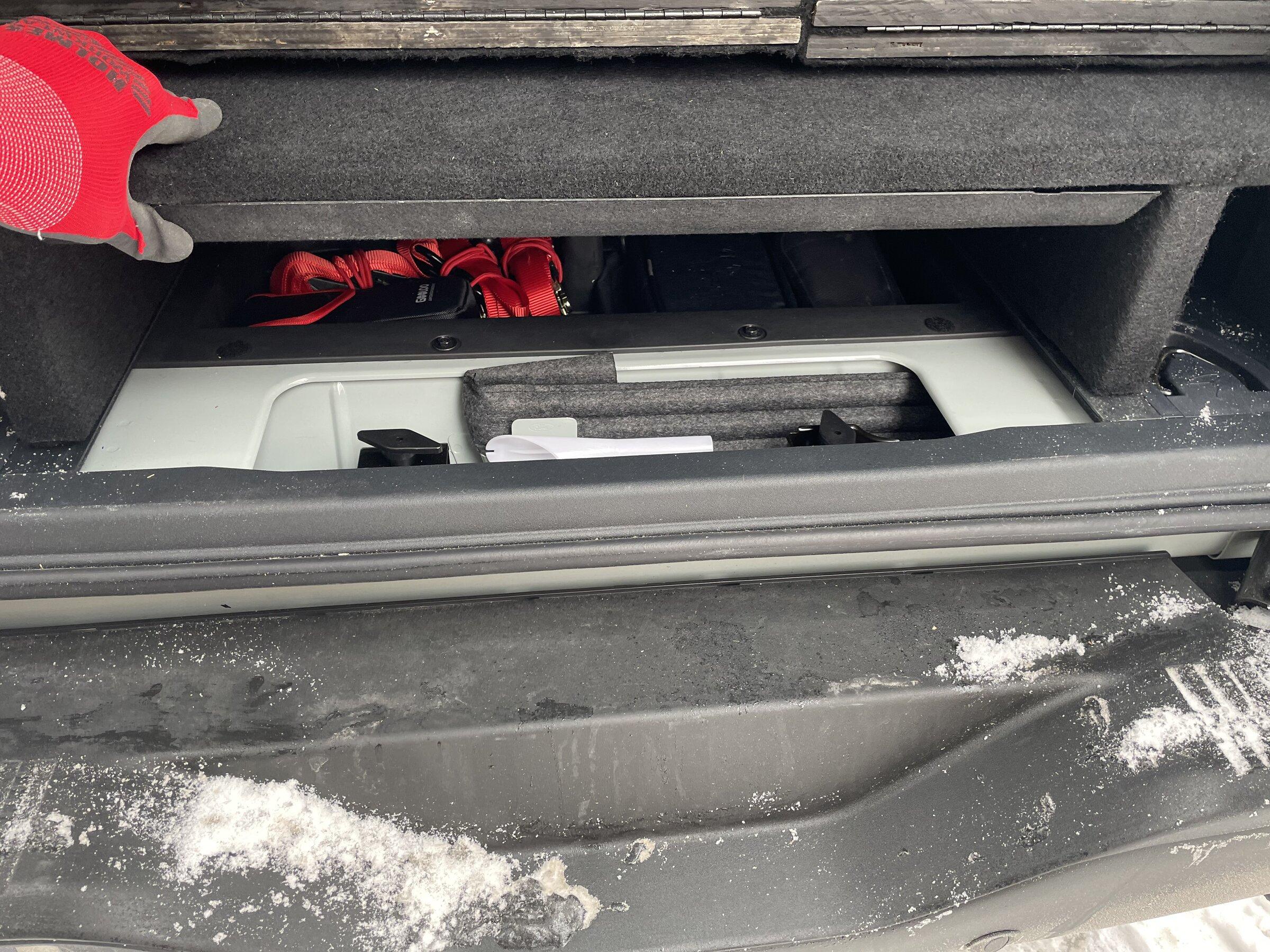

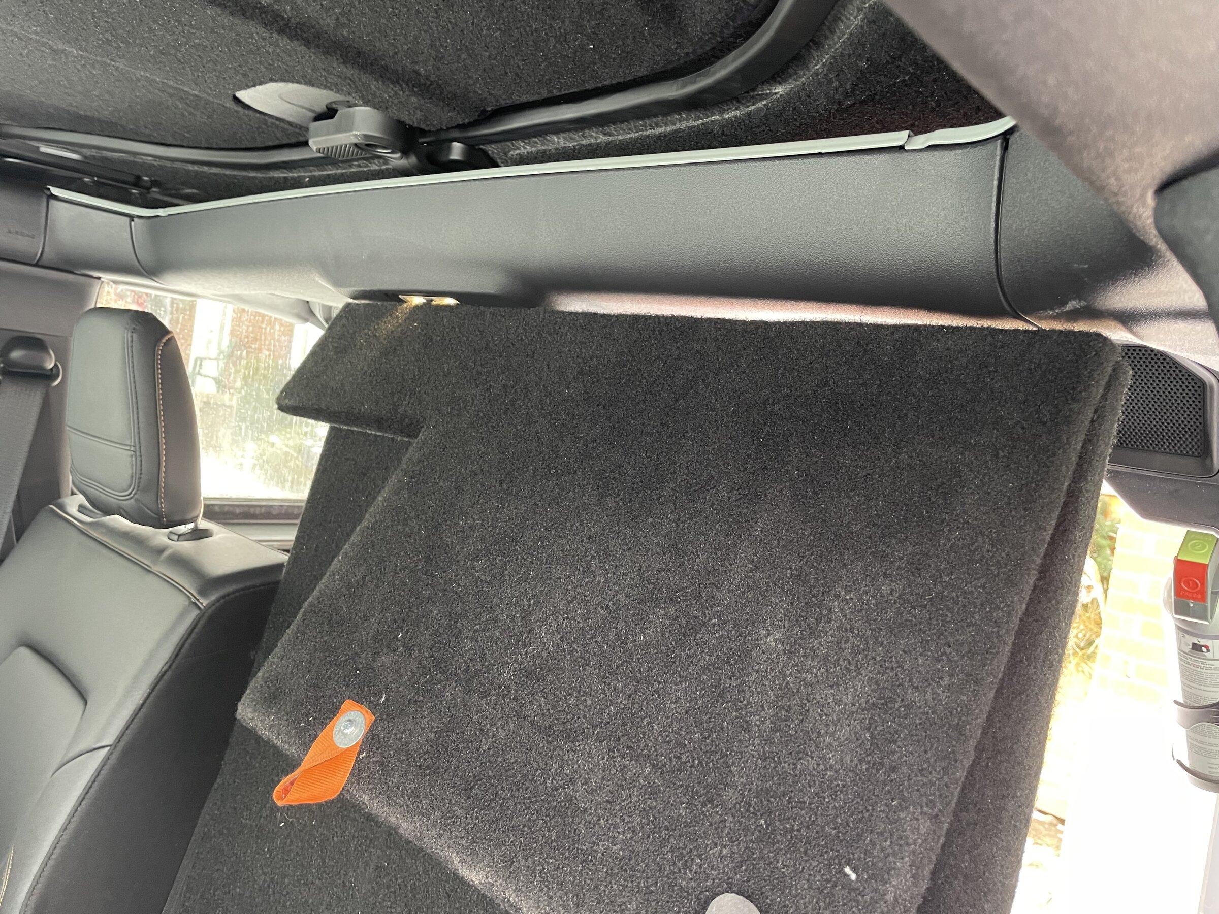

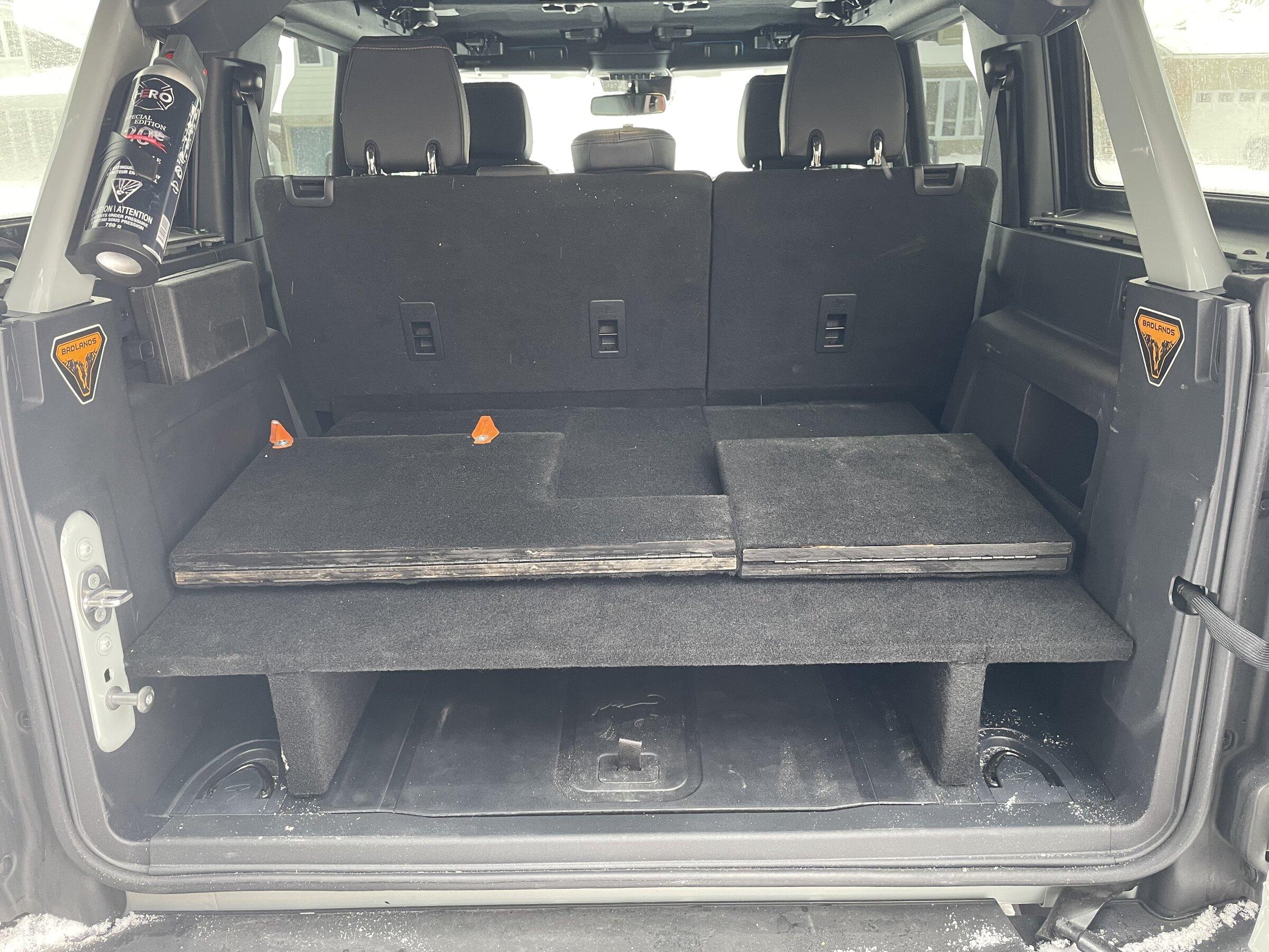

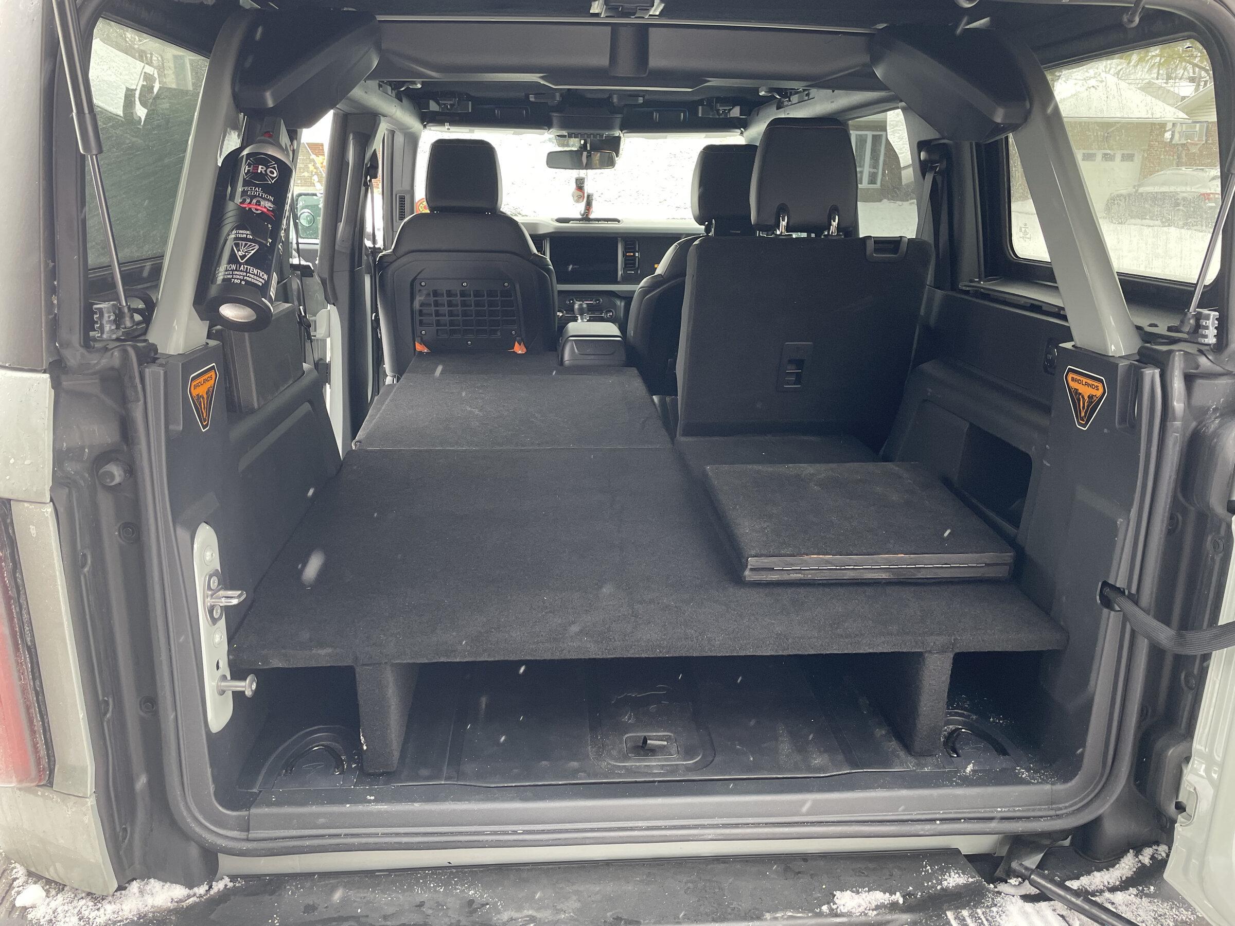

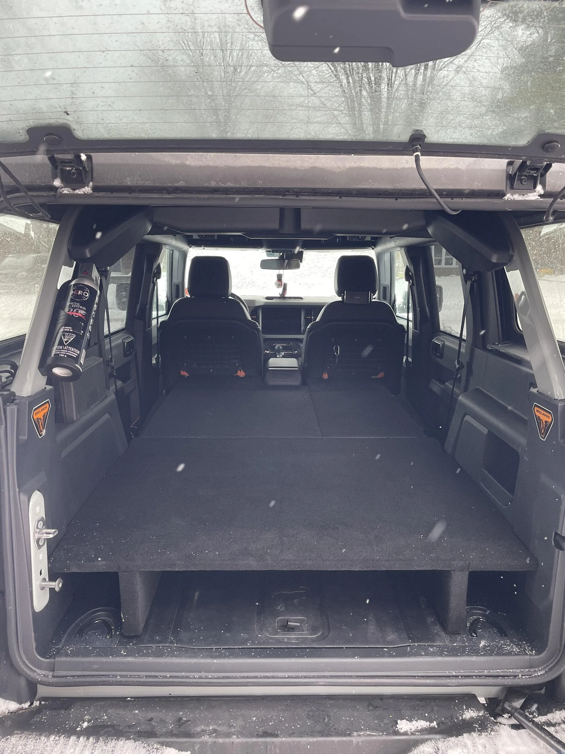

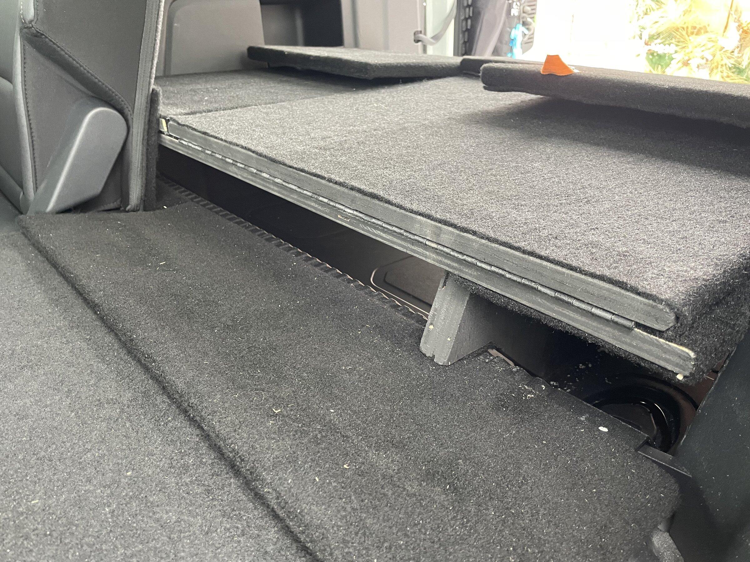

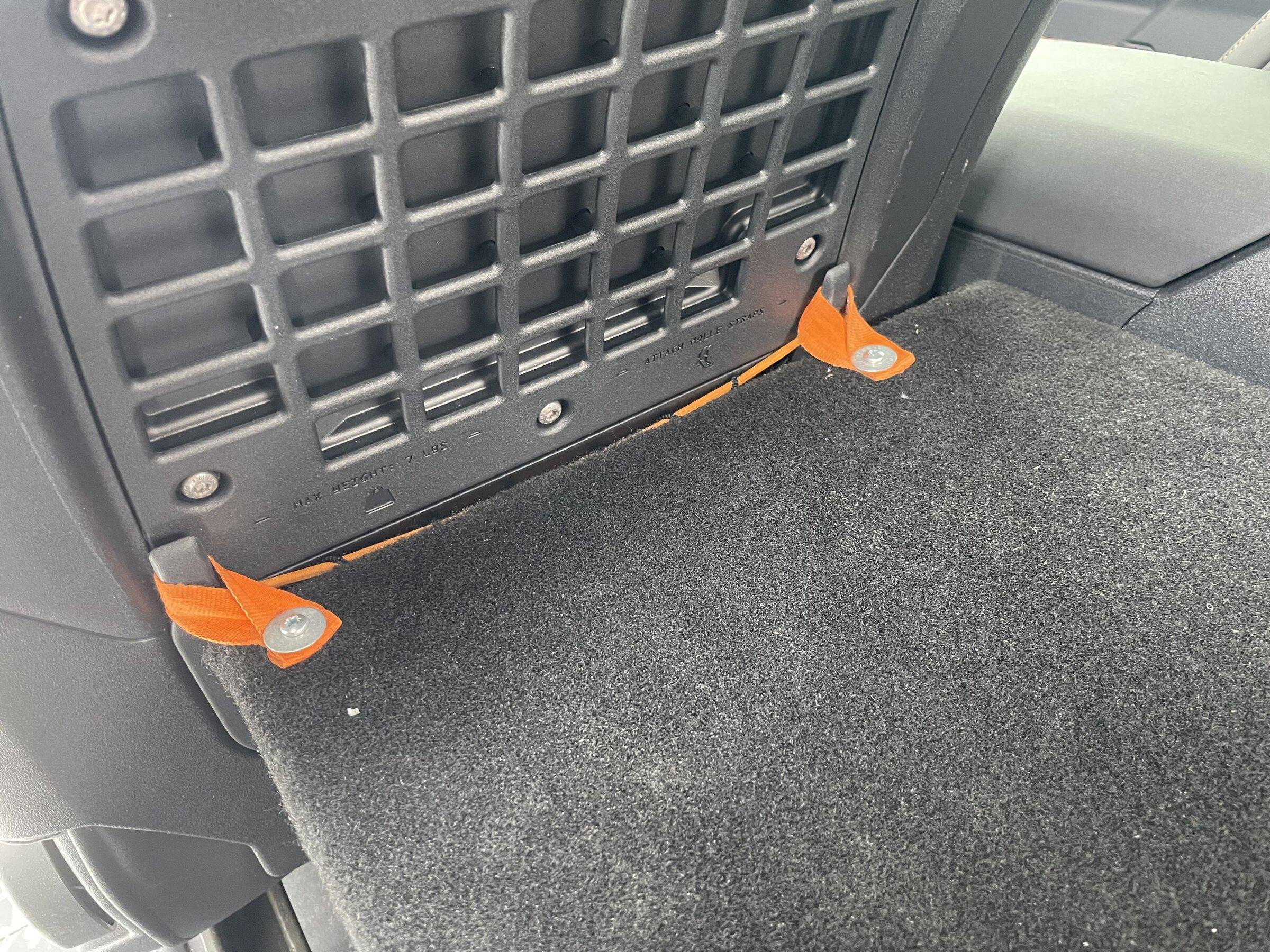

So I’m about to embark on a little road trip 😉. Roughly 4300 miles. I’m going to spend a few nights in the Bronco (roughly 5-6 total) and wanted a flexible and easy solution that would provide me adequate space, comfort and ease of setup. Although I’ll be going it alone this time, I wanted my platform to match the 60/40 seating and give me the option of going single or double.
I decided to use 5/8” plywood to keep things fairly light. I also decided on only 2 supports, allowing me access to my floor compartment. The supports are 6” tall and the platform ends up perfectly flat. I’m really happy with the result! I’ve also installed some Velcro tabs around the vehicle and have blackout curtains that surround the entire sleeping area. It takes me about 5 minutes to be completely ready to sleep (platform unfolded, curtains installed and air mattress filled). This option leaves you with an uneven trunk space when the platform is folded up and stored - but that wasn’t a big deal to me. It takes me about 10 seconds to put it in the Bronco or to remove it. I don’t have a scale but this thing’s pretty light. Maybe 35lbs. I also love the hidden storage that it provides if going topless.
I’m 6’2” and 230lbs and I fit without a problem. With my previously made (and posted) window vents and a battery operated fan/light that hangs from a roof latch, as well as my headrest mounted iPhone/iPad mount - I’m all set up!!!
Before anyone comments - I’m gonna replace the orange webbing with black - but I already had it and at least it matches my Badlands trim 😉. Hope this inspires some even better ideas.
Looks very nice, I like how you left the access to the storage area.

Very well done! I like that you can pull it all out pretty easily when you're not doing an overnighter so it makes it that much more flexible.
It literally installs or removes in seconds. It fits snug and doesn’t rattle under normal conditions. As mentioned previously- I’ll see how it holds up during the trip and off-roading soon!

Awesome build, I am in the middle of one similar, and wanted to use piano hinges but am worried about how they hold up over time with plywood plus the weight of 2 humans and 2 dogs. Have yours held up?
