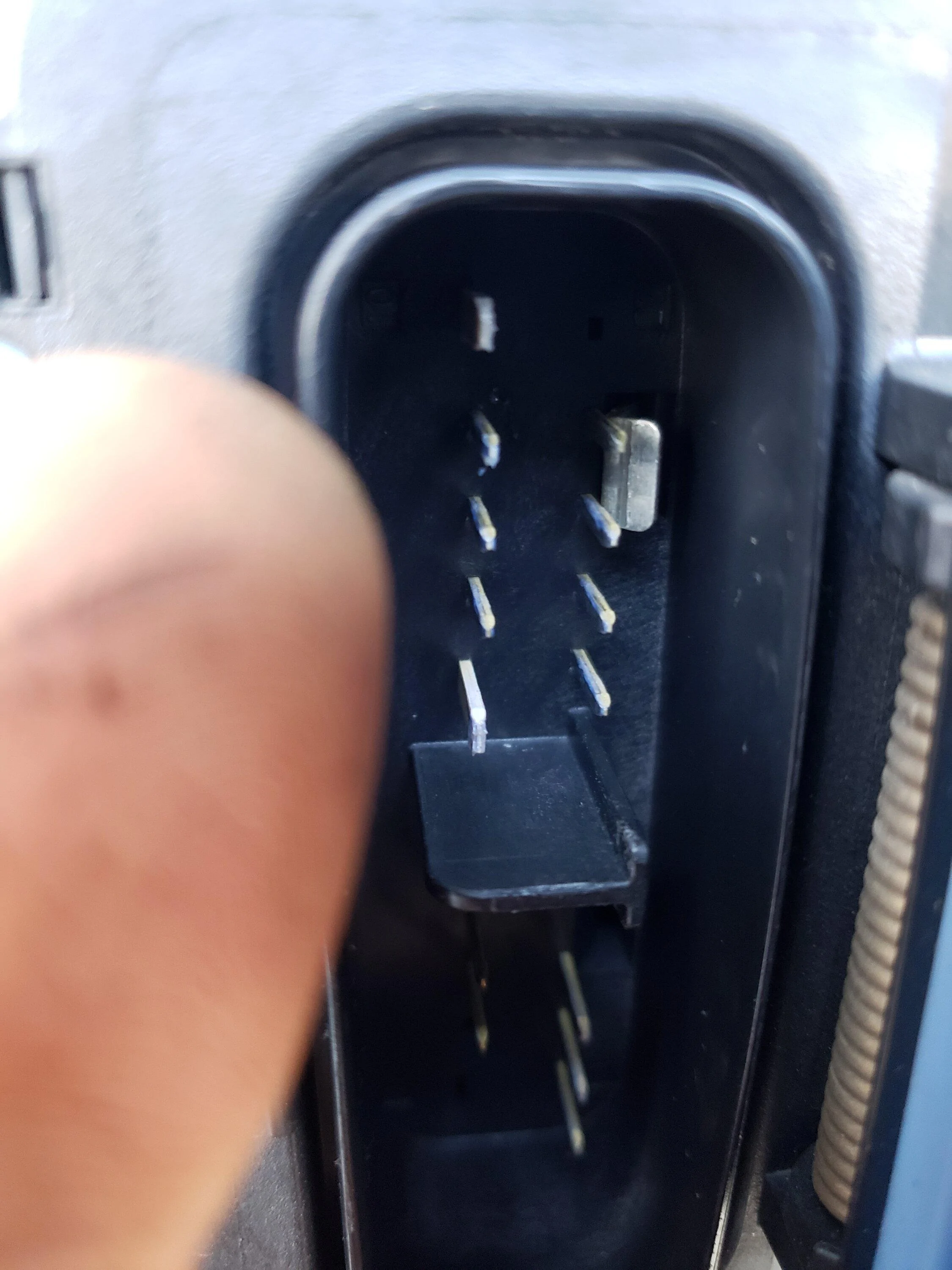

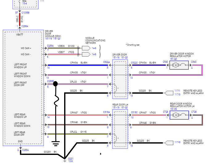

Each door connector contains a "shorting bar" like the one you can see above. It shorts pin 7 to pin 8 in that connector when it is disconnected. One pin is purely a sensing circuit from the door module, the other is the door's ground. Don't remeber which, and not important at this point. What is important is that the door module MUST see ground on this circuit to flag the door as "removed by customer". Otherwise it will assume electrical faults exist. When it barks those faults over CAN every other module in the vehicle takes a bite and starts whining, and nannying. So no big deal right? 20 years from now when this thing is rusty and used it will be that guys problem...well my Bronco is brand new, and it spent 123 days in a "climate controlled storage facility". My passenger side doesn't work. Corrosion? Bent pin? Doesn't matter to me. I live in Wisconsin, and if the shorting bar doesn't work after 123 days of climate controlled storage, it won't work after a Wisconsin winter...so I figured out a workaround! Mine isn't the only way...you guys out there feel free to experiment!
My solution:

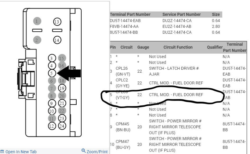

Ford Bronco Doors off gremlins explained, and an inexpensive DIY solution! broncoddmexpl

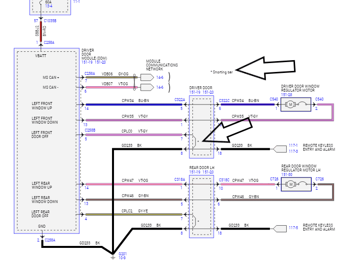

In this diagram you can see i have pointed out the shorting bar for the drivers door. It connects the VT/GY wire coming from the DDM to ground (VT=violet, thats purple in "non metric" colors. GY=grey, thats the same, standard or metric). Note that wire occupies pin 5 of c258B. This is the grey connector on the DDM. Also note that the "door off" sensing wire for the drivers REAR door is pin 4. Mine is a 2dr so I don't have to worry about that one, but "moar door" folks will.
Passenger side:
Ford Bronco Doors off gremlins explained, and an inexpensive DIY solution! broncopdmexpl

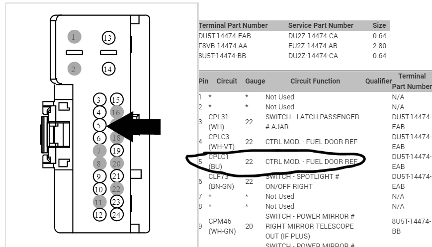

Passenger side ia a mirror image of the drivers. Front door sense wire is again pin 5 of the grey connector, only this time the wire is blue. Rear door (if I had one, which I do not) would again be pin 4 of the same connector. Heres connector views for the DDM/PDM
DDM:
Ford Bronco Doors off gremlins explained, and an inexpensive DIY solution! ddmconnectorexpl
PDM:
Ford Bronco Doors off gremlins explained, and an inexpensive DIY solution! pdmconnectorexpl

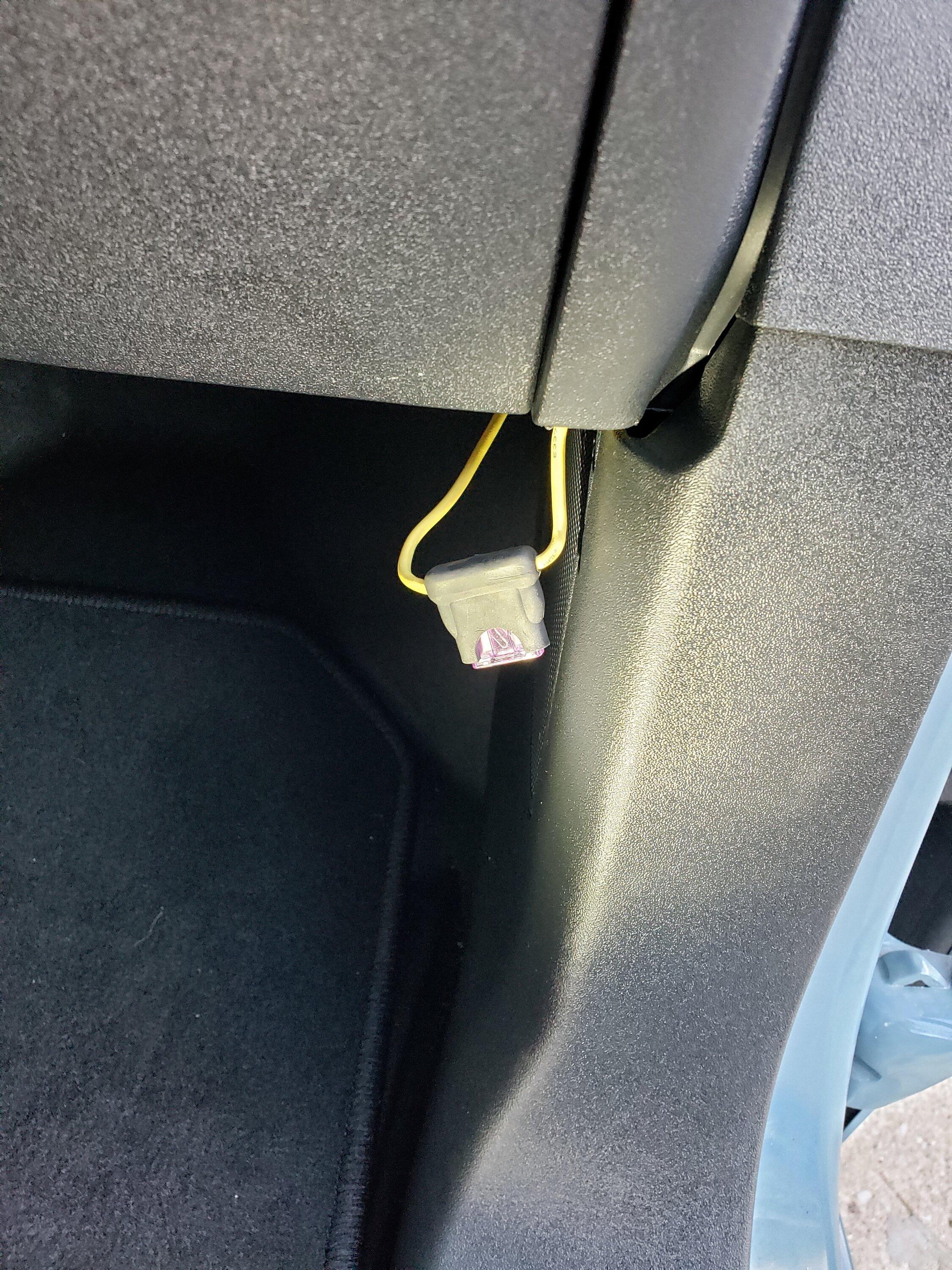

So here's what I did:

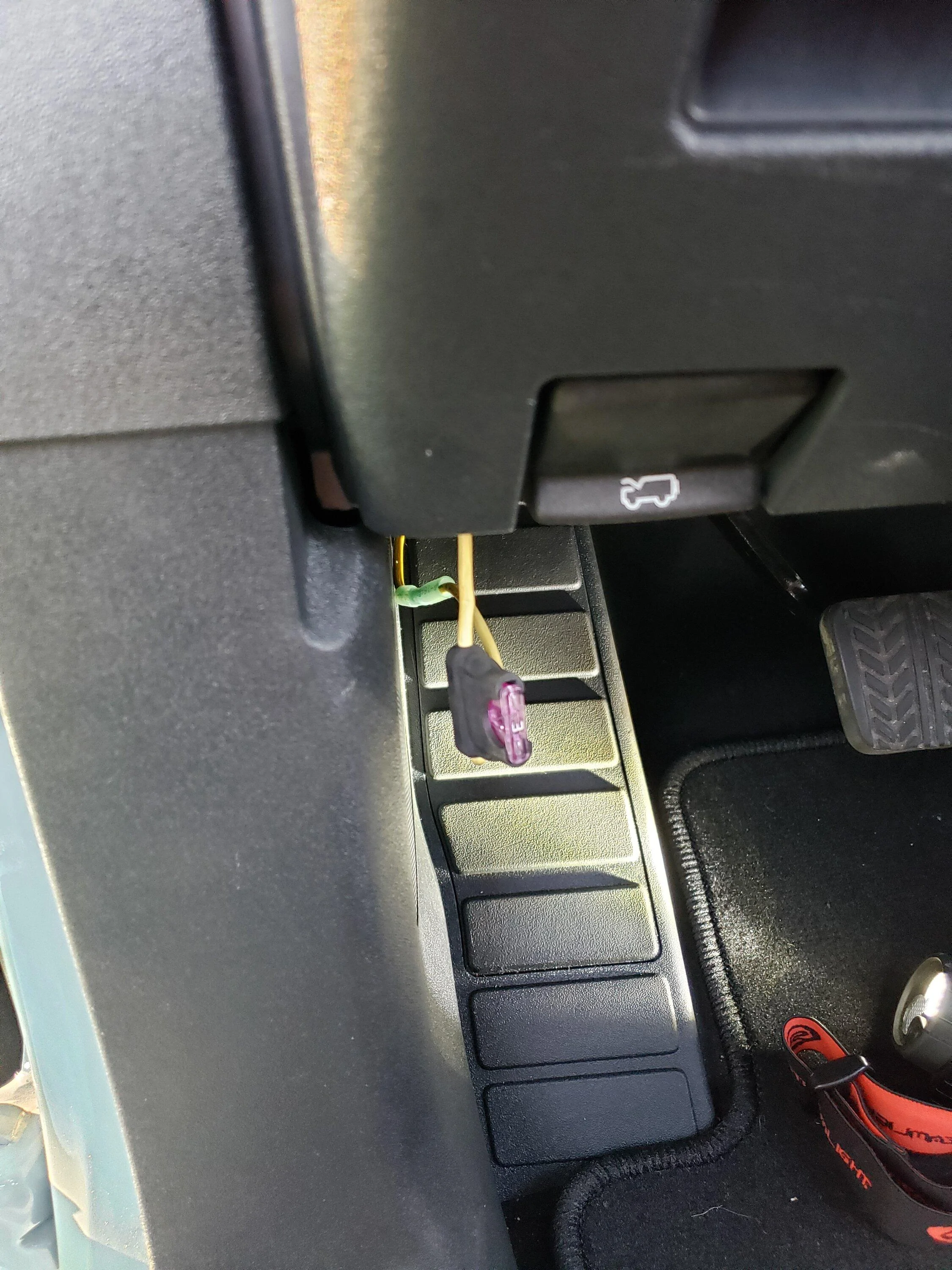

Ford Bronco Doors off gremlins explained, and an inexpensive DIY solution! broncoddmmod

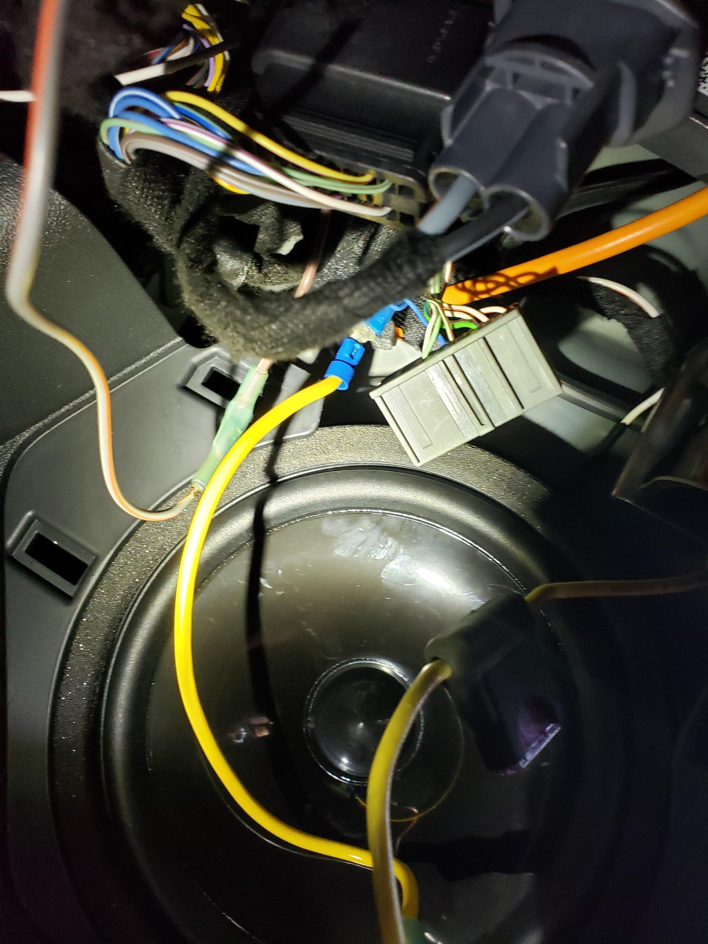

I thought about wiring some kind of toggle/rocker/dip switch in there...far to elaborate for my purpose, and if within reach I might accidentally flip it while the doors are off, or whatever...thats just overthinking it. I think Ford had a good concept w/the shorting bar idea, just unreliable execution 'cause they had to make it something that didn't require an extra step from the customer when removing the door. So I figured I could use a readily available fuse holder. I used a wire tap like alarm guys use, hooked a ordinary in line fuse holder to that, then grounded the other end to the main dash ground, that is conveniently located right under the left, and right kick panel:
Ford Bronco Doors off gremlins explained, and an inexpensive DIY solution! 20220719_190749
Passenger side shown, because it's easier to take a picture of, but drivers side basically the same. Then I left enough wire that I could pull my fuse holder out of the kick panel, but still tuck it back:
Ford Bronco Doors off gremlins explained, and an inexpensive DIY solution! 20220719_191020
Ford Bronco Doors off gremlins explained, and an inexpensive DIY solution! 20220719_191106
So then I simply insert the fuses when removing the doors, and remove them when reinstalling. The fuses fit nice and tight and its secure enough that its not going to come loose if I take my Bronco over any "sweet jumps"
Ford Bronco Doors off gremlins explained, and an inexpensive DIY solution! sweet-napoleon
I now get no errors/warnings at all w/doors off. When starting the vehicle i get a single notice that doors are disconnected (duh). And if I remove my seatbelt w/the engine running, it warns me that the engine is running, just like it would if I opened the door w/the engine running, so it must use the seat belt switch in lieu of a door ajar switch...I would consider that "normal operation". As I said above, mine is a 2dr. Maybe a 4dr owner will try this and leme know the results?​
