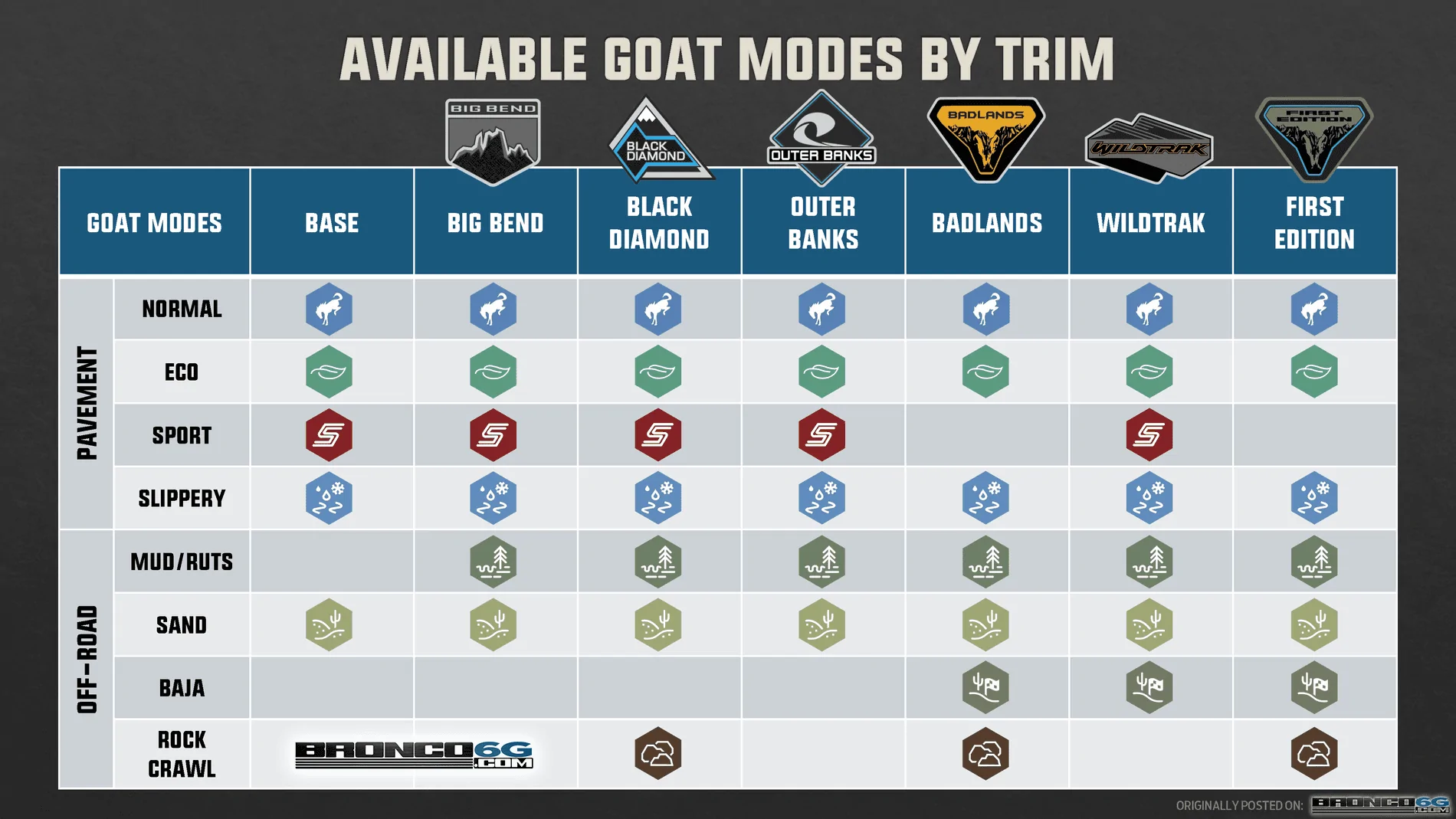

The icon also looks like it has rain drops.
I'm guessing here, but if Ford has a slippery mode in any of their other SUV's, it's OK to use in the rain on pavement.
I believe these icons reflect what is displayed in the Bronco. Slippery looks like rain, snow, sand/mud.
*I don't know who made this chart, so disregard the Pavement/Off-Road categories.
