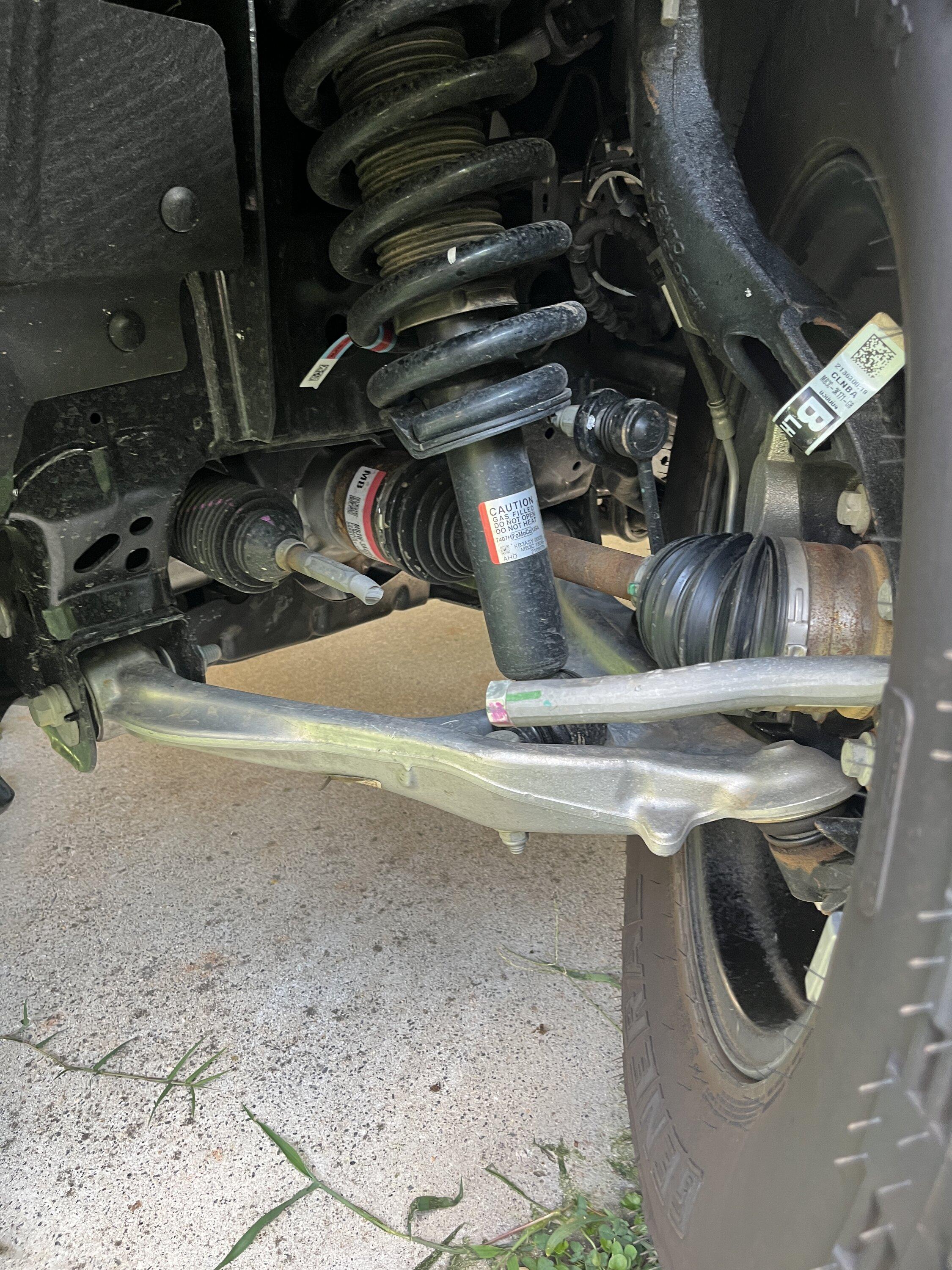

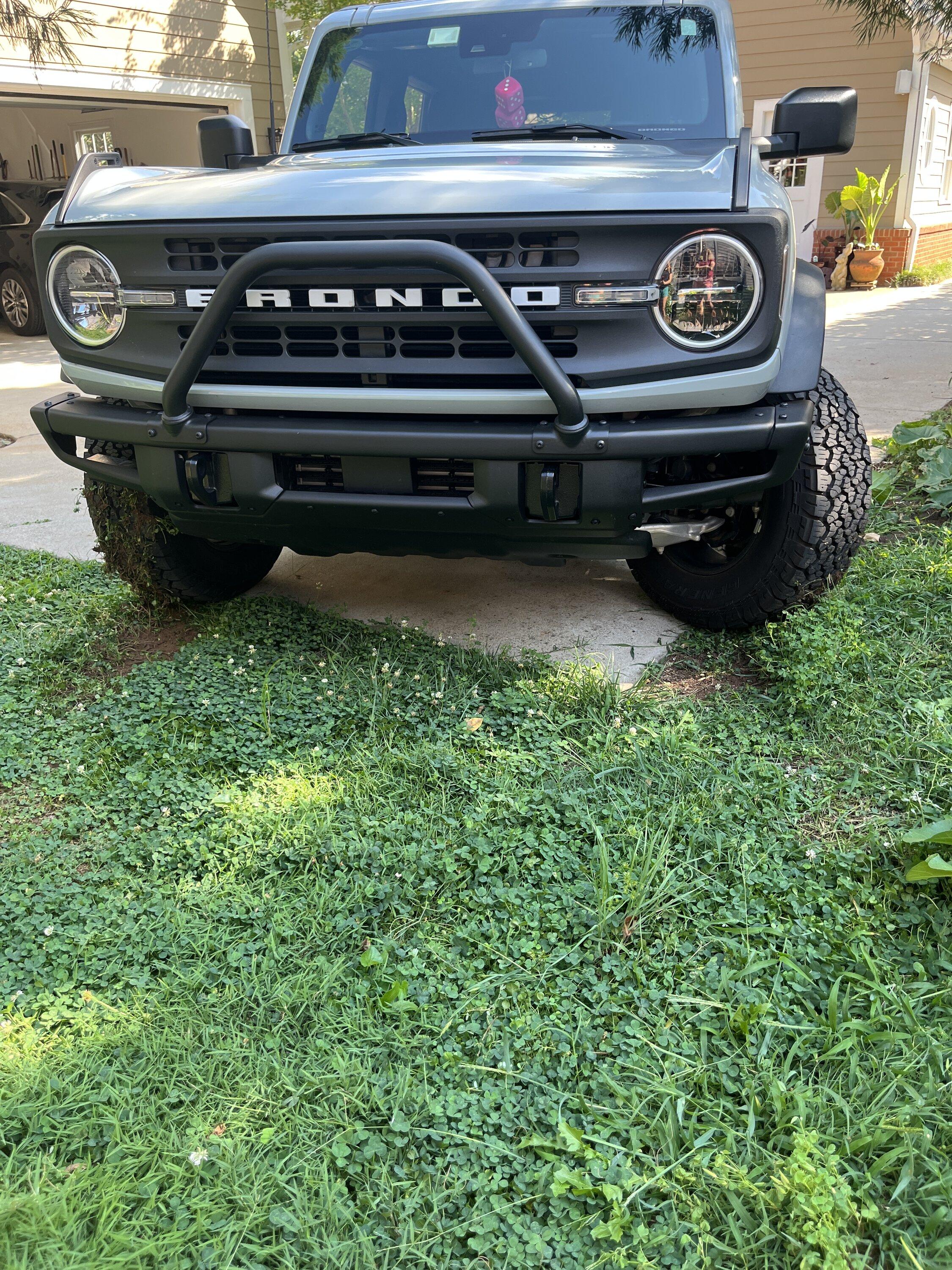

Well what I thought would never happened happened.
I just got my babe back from getting the recalls done on it and literally not even an hour after having it back I was turning around in my driveway and the tie rod snapped . Iām completely stock with 33s!
I thought tie rods were only snapping on off roading conditions but I guess not! This sucks

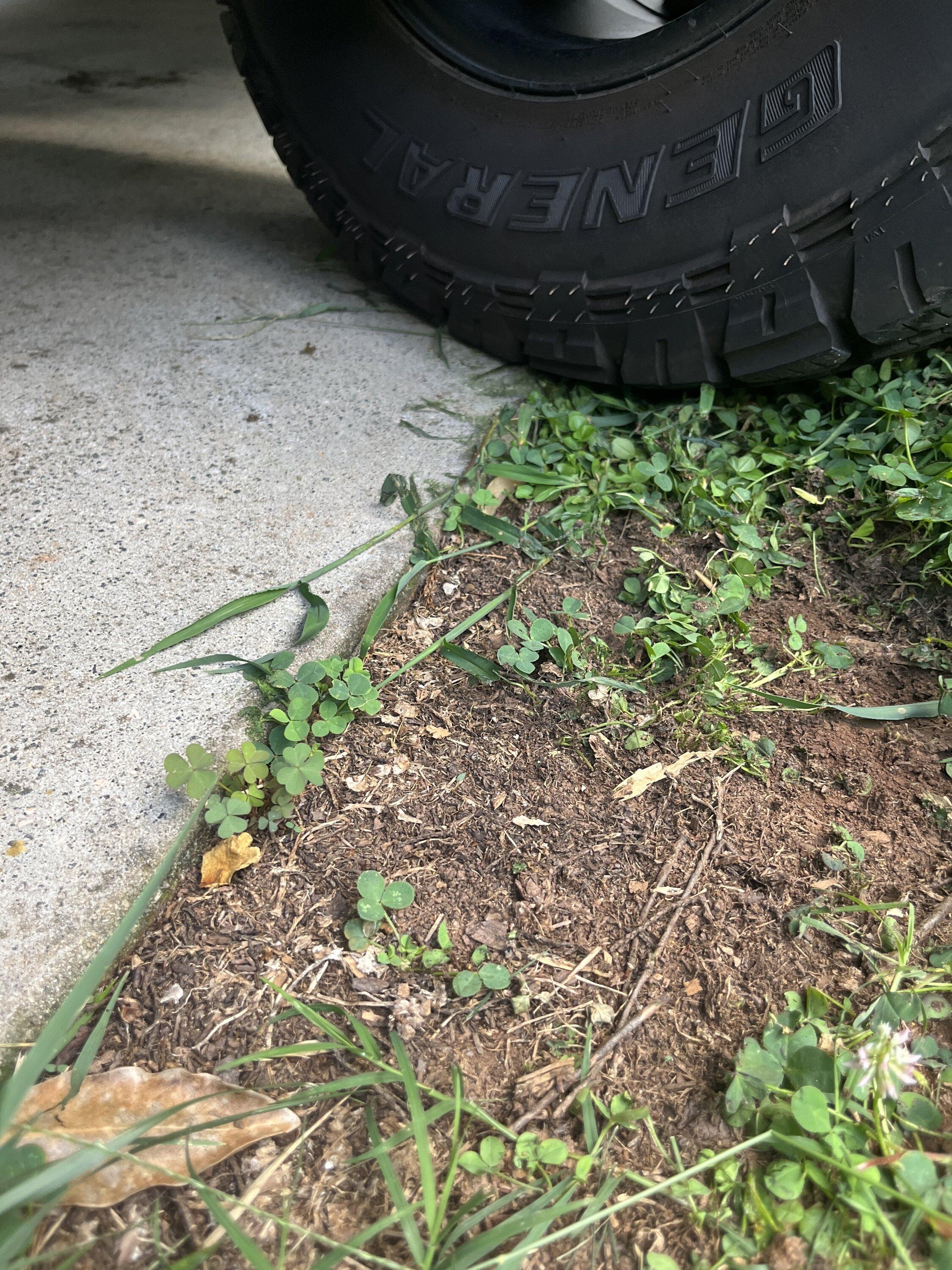

as I said earlier Iām being completely truthful. No curb smacking has happened unless someone stole it in the dead of night and took it for a joy ride. The dealership idea might be correct though, they did do an inspection so maybe they lifted it up and something happened? Iām not sure but I am sure that Iām telling the truth.I agree with an earlier post. The tie rod was subjected to earlier trauma. Anyone else drive this Bronco? Not fessing up to smacking a curb rather hard? Did they test drive it at the dealership or lift the vehicle for the recall work? The bend in the tie rod occurred before it snapped in your driveway. Fortunate it snapped then and not on the road.
