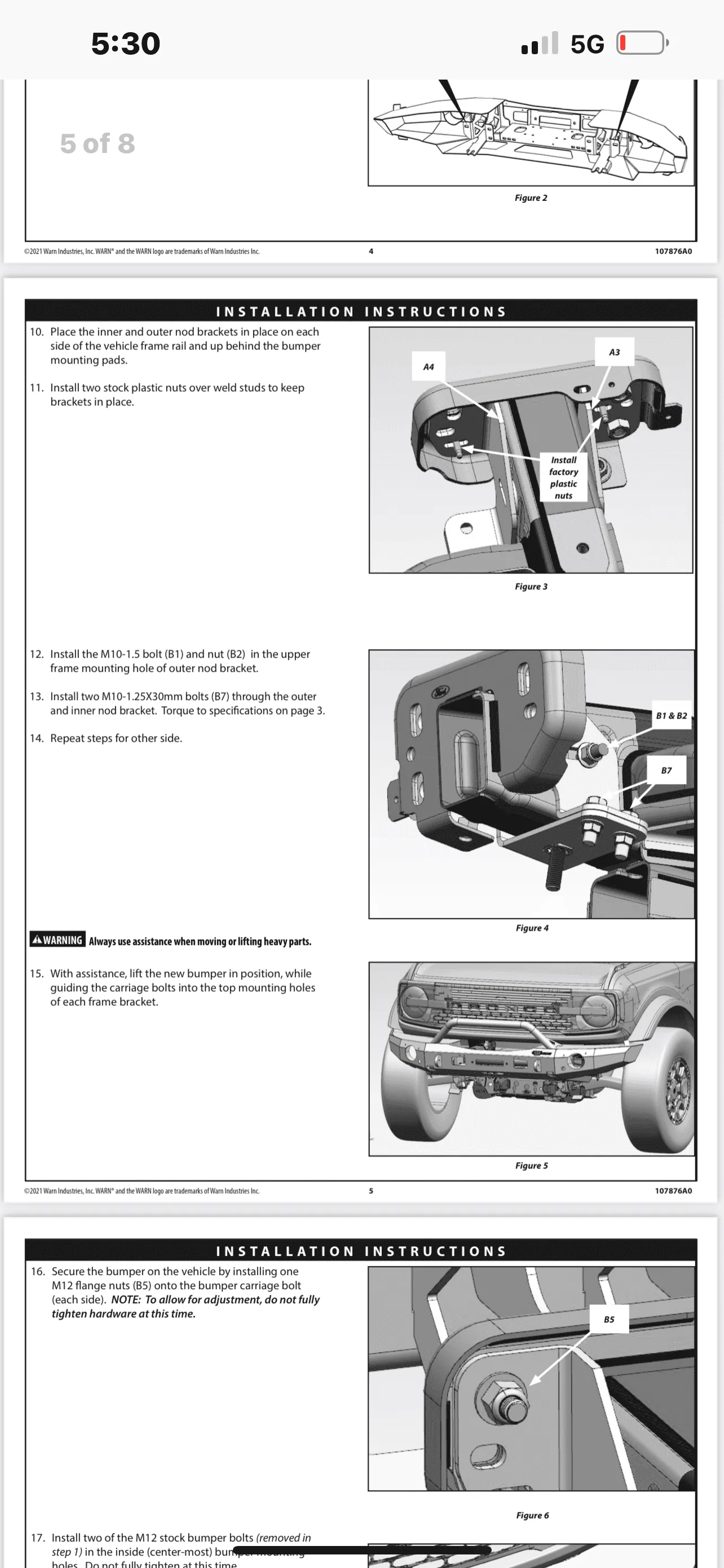

Did we watch the same video? The front bumper twisted and pushed the winch into the grill.
While I love DV8 products, and I have first hand experience with their great customer service, this was not a good look for the bumper. It absolutely should not be used for lifting the front end in a recovery.
EDIT: DV8 has corrected the record. The frame mounts bent. The bumper is fine.
And that is why the Warn bumper, Factory winch mount and LOD have frame stiffeners behind the front bumper mounts. All winch bumpers should get them.

Our bumper held up to the test with no issues! Fords frame horns were the weak point that bent.
I'm no expert, but lets be fair or think this through. Ford's mounts were not designed for the Torque created from lifting attachments on the front edge of a specialty bumper that protrudes an extra foot(?). When disigning a bumper, then putting lifting points on the outer front end, instead of where the OEM shackles meet the frame . . . I dont think its reasonable to place all the blame on Ford. This is an unforseen design flaw of a very nice bumper, IMHO. That is, as others have said, use stronger attachment hardware for that bumper.
