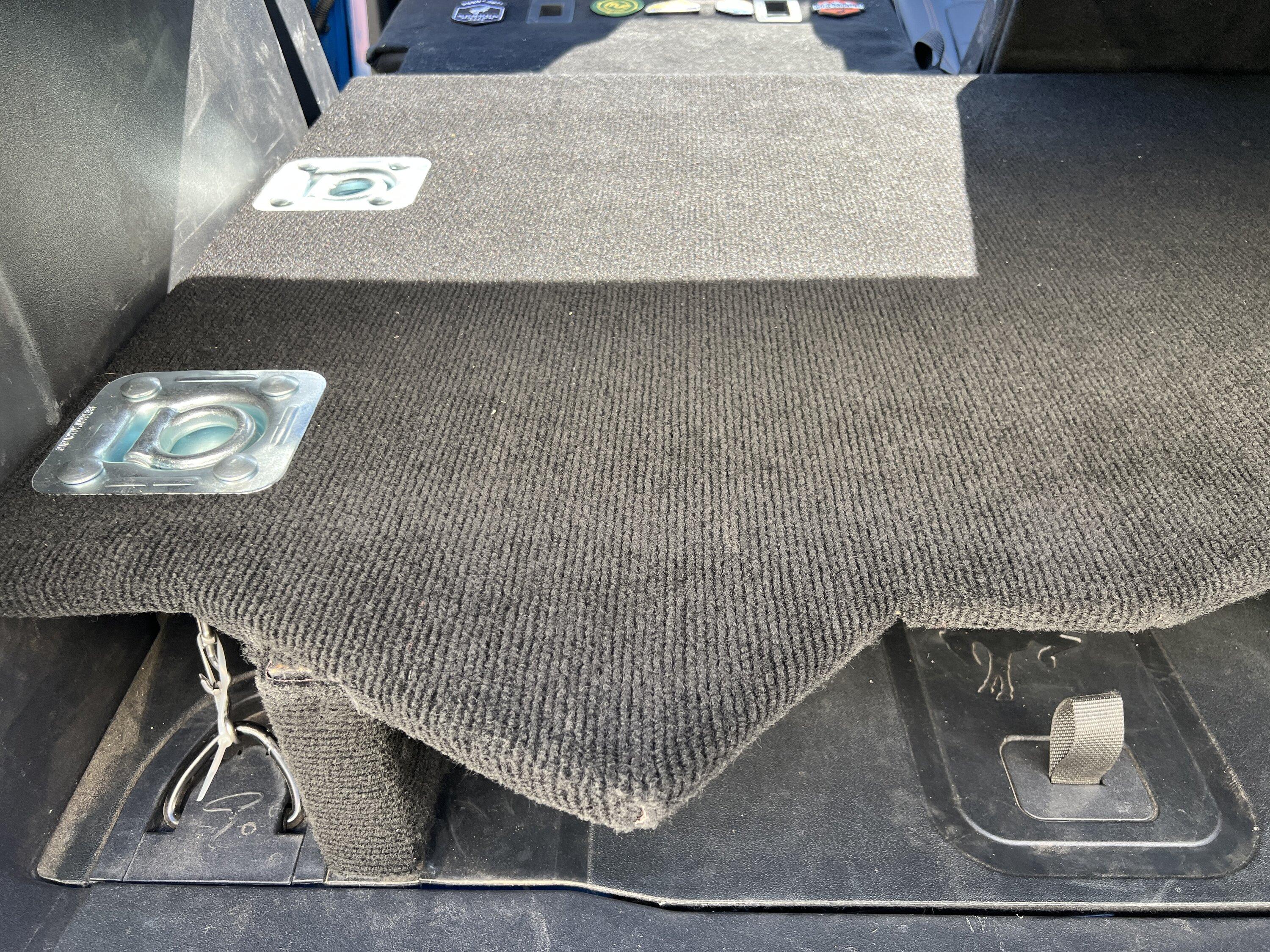

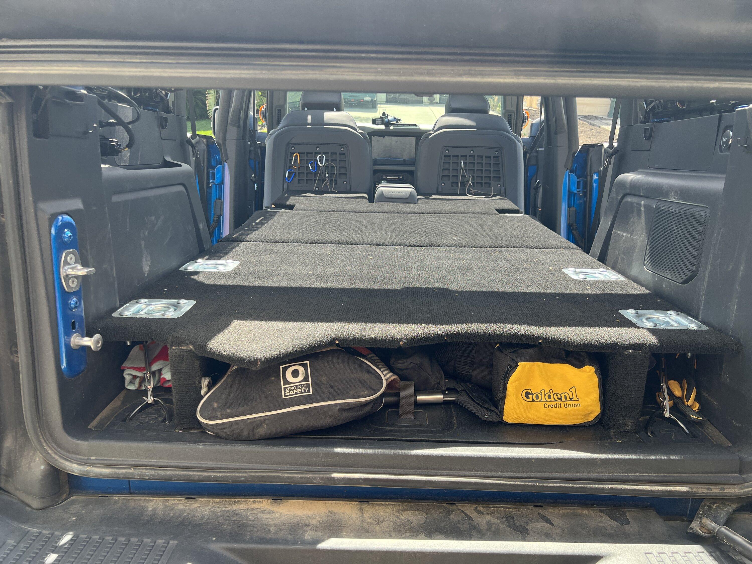

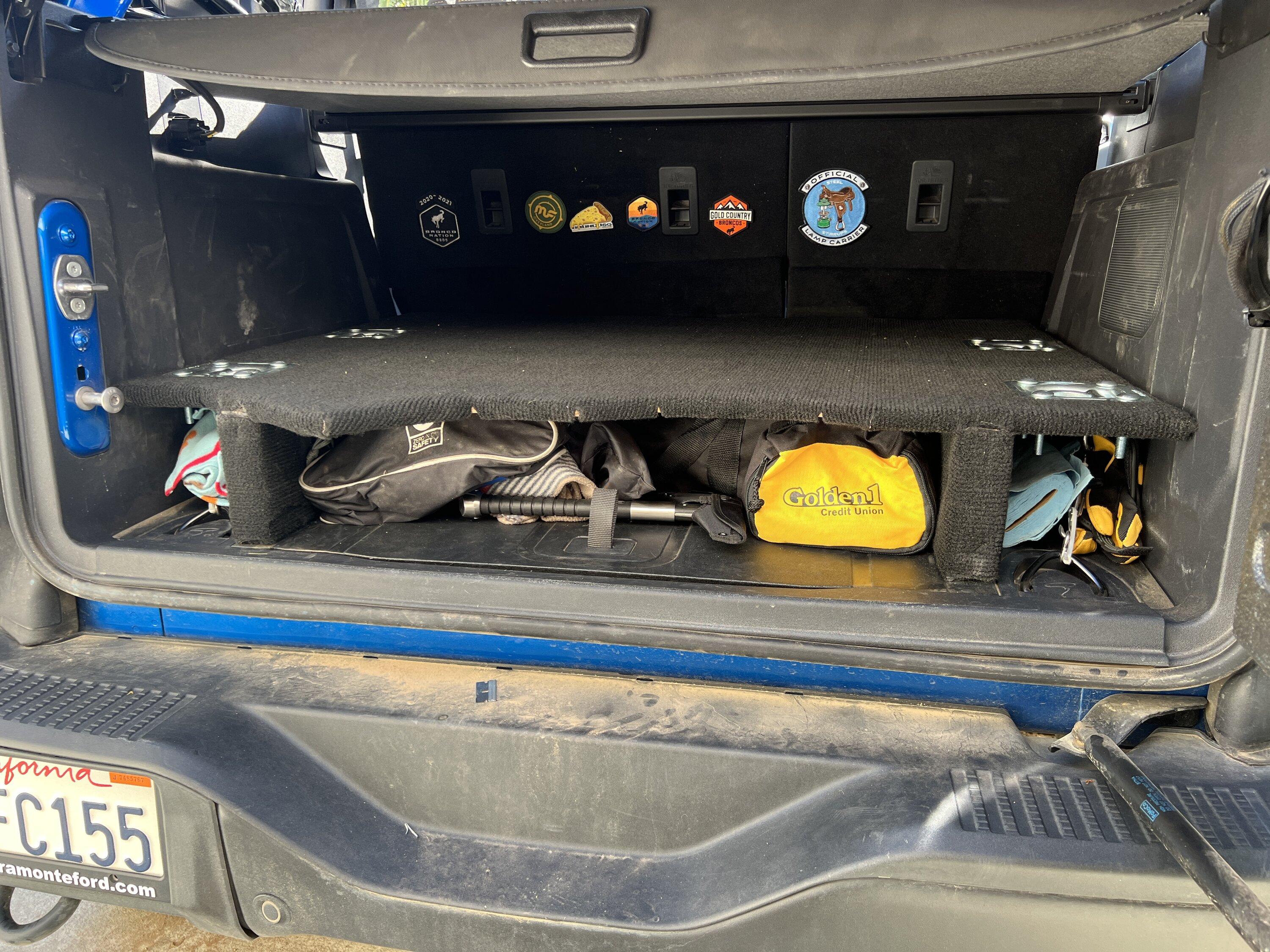

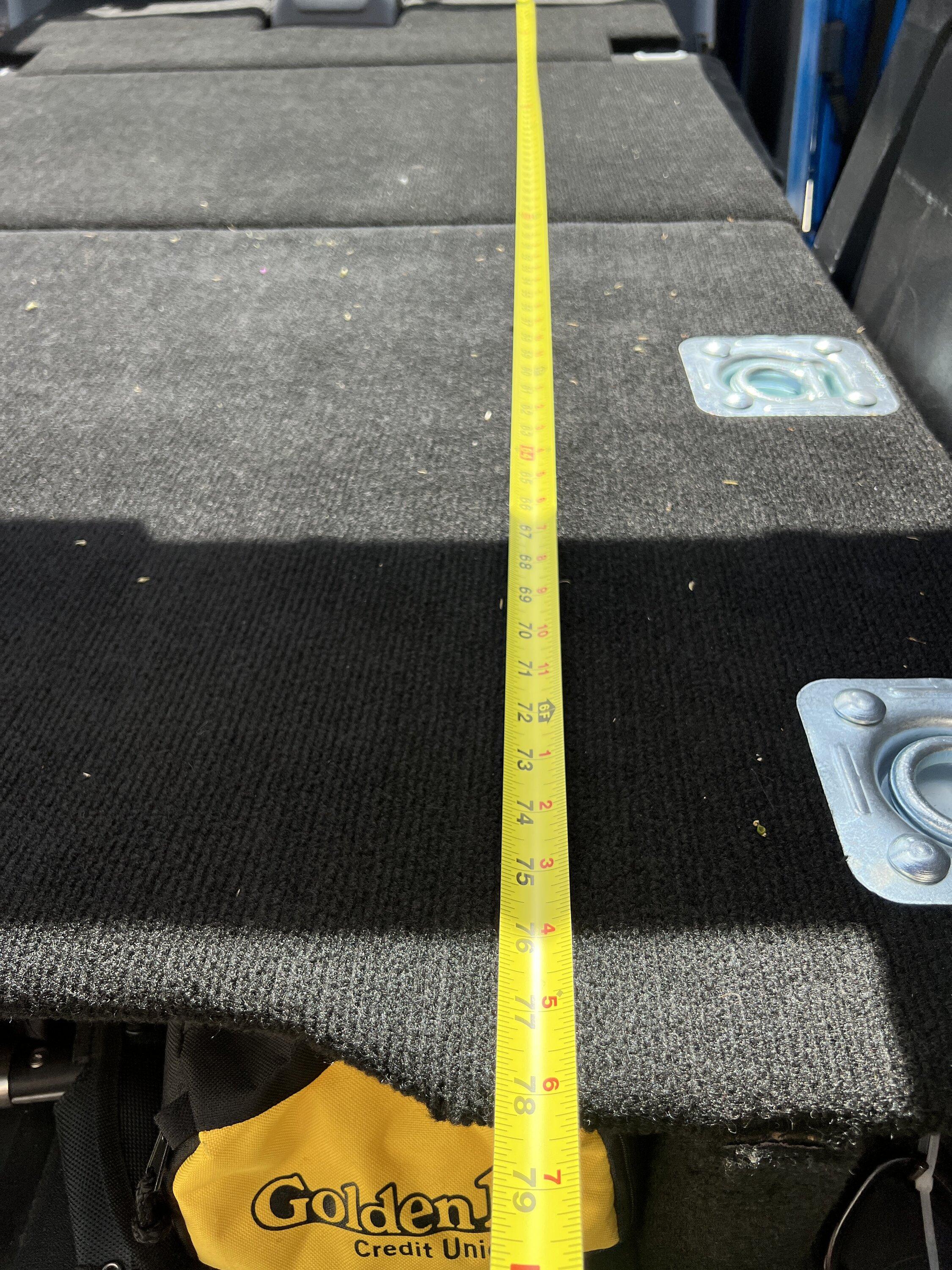

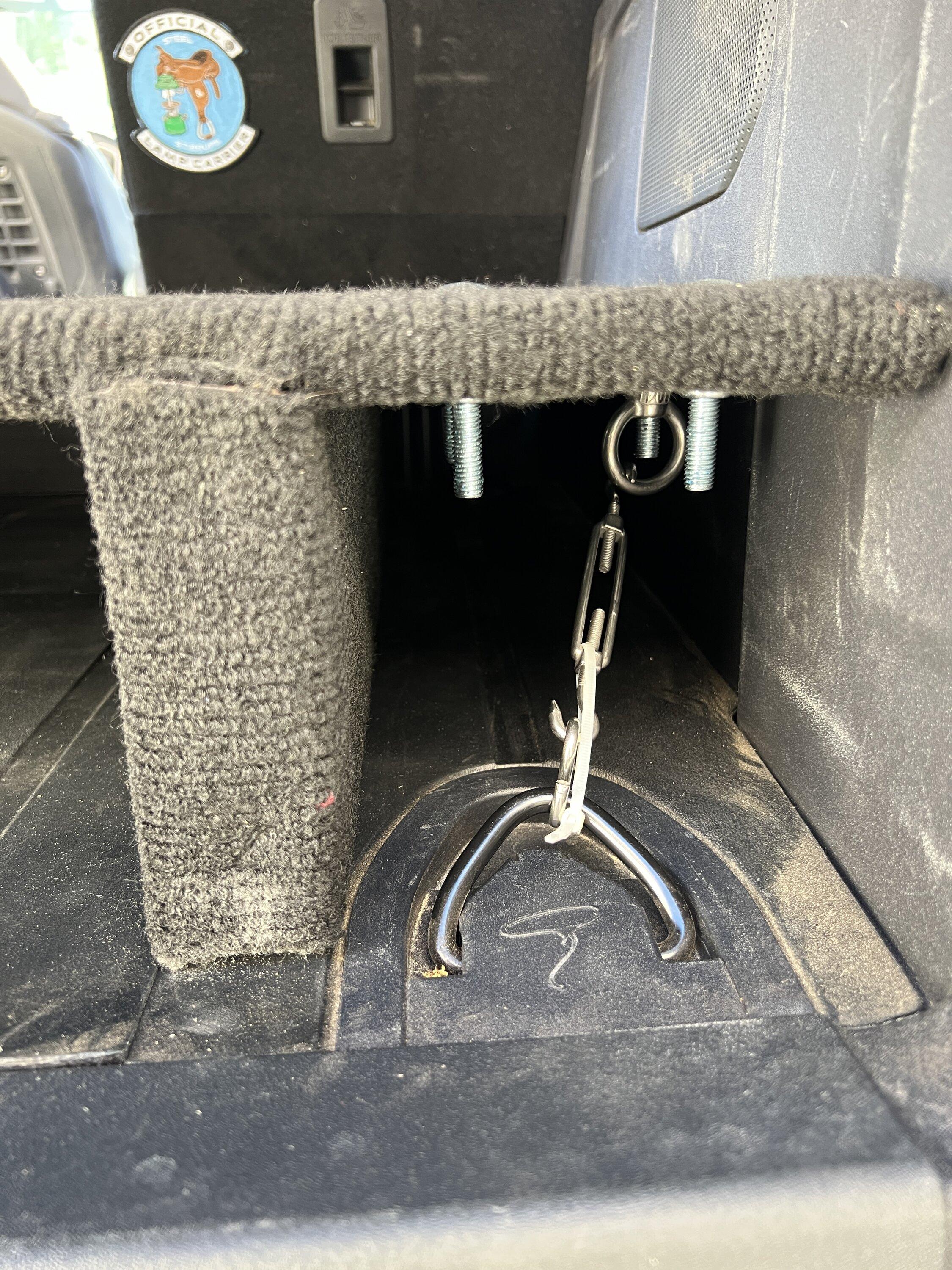

Made some more progress this weekend ... wrapped the main platform in marine grade carpet (used Gorilla glue spray adhesive and staples), and secured it to the stock tie-down points with turnbuckles so it doesn't move/bounce around. Because of how closely I cut the edge against the tailgate, it has created a secure storage space underneath that can't be accessed without opening the tailgate - so I have stored my Morrflate 4-way system, kinetic rope, soft shackles, first aid kit, gloves, blankets and more underneath it, out of view when the tailgate is closed.

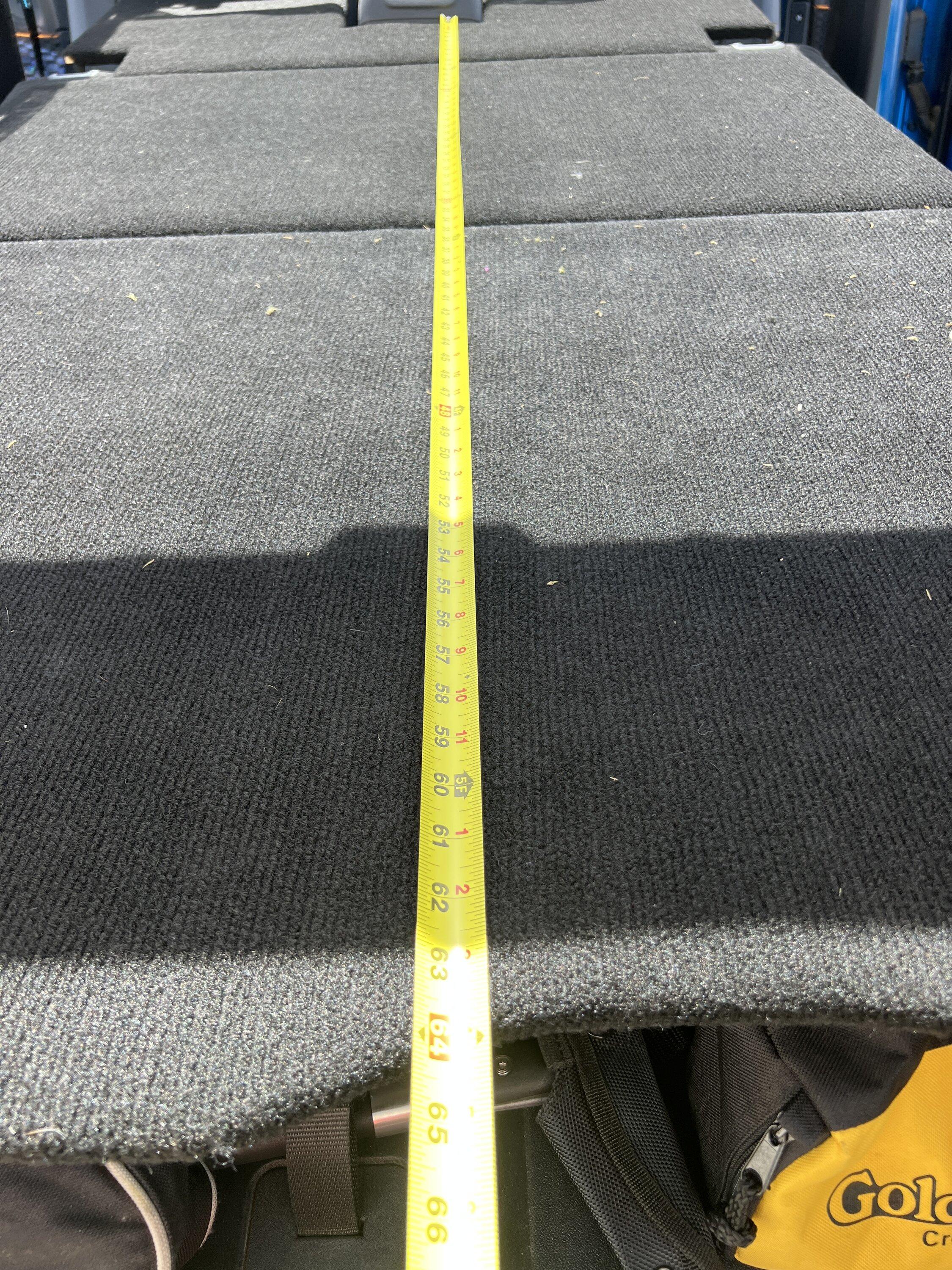

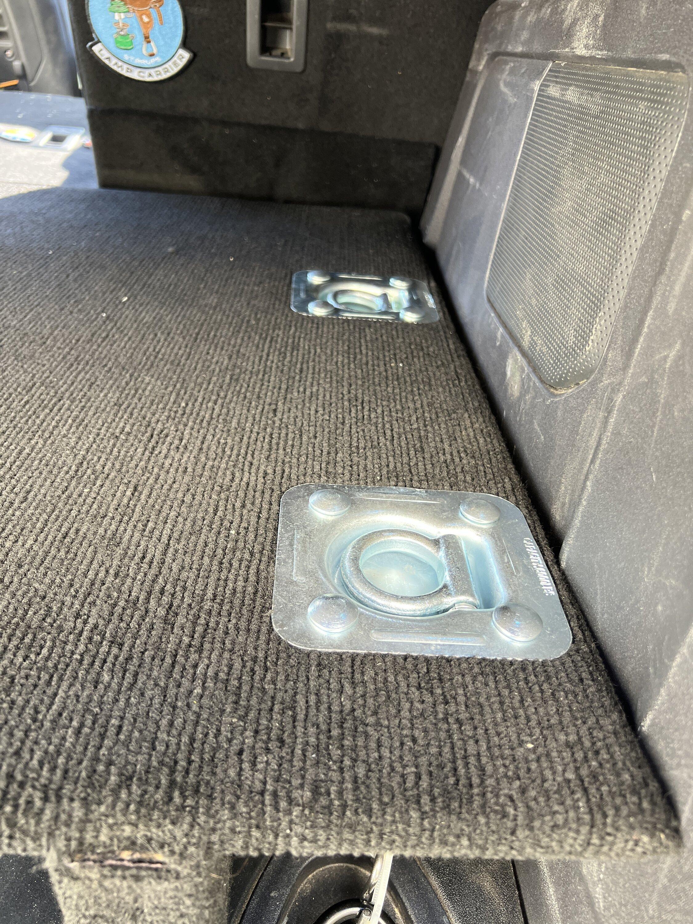

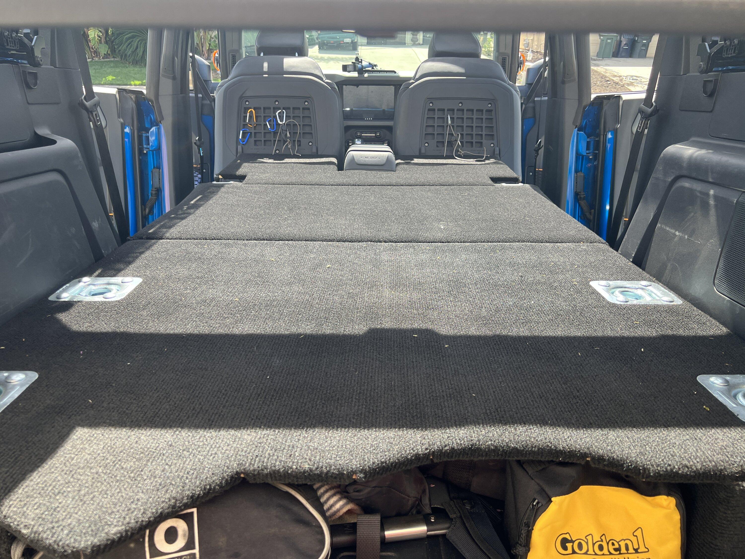

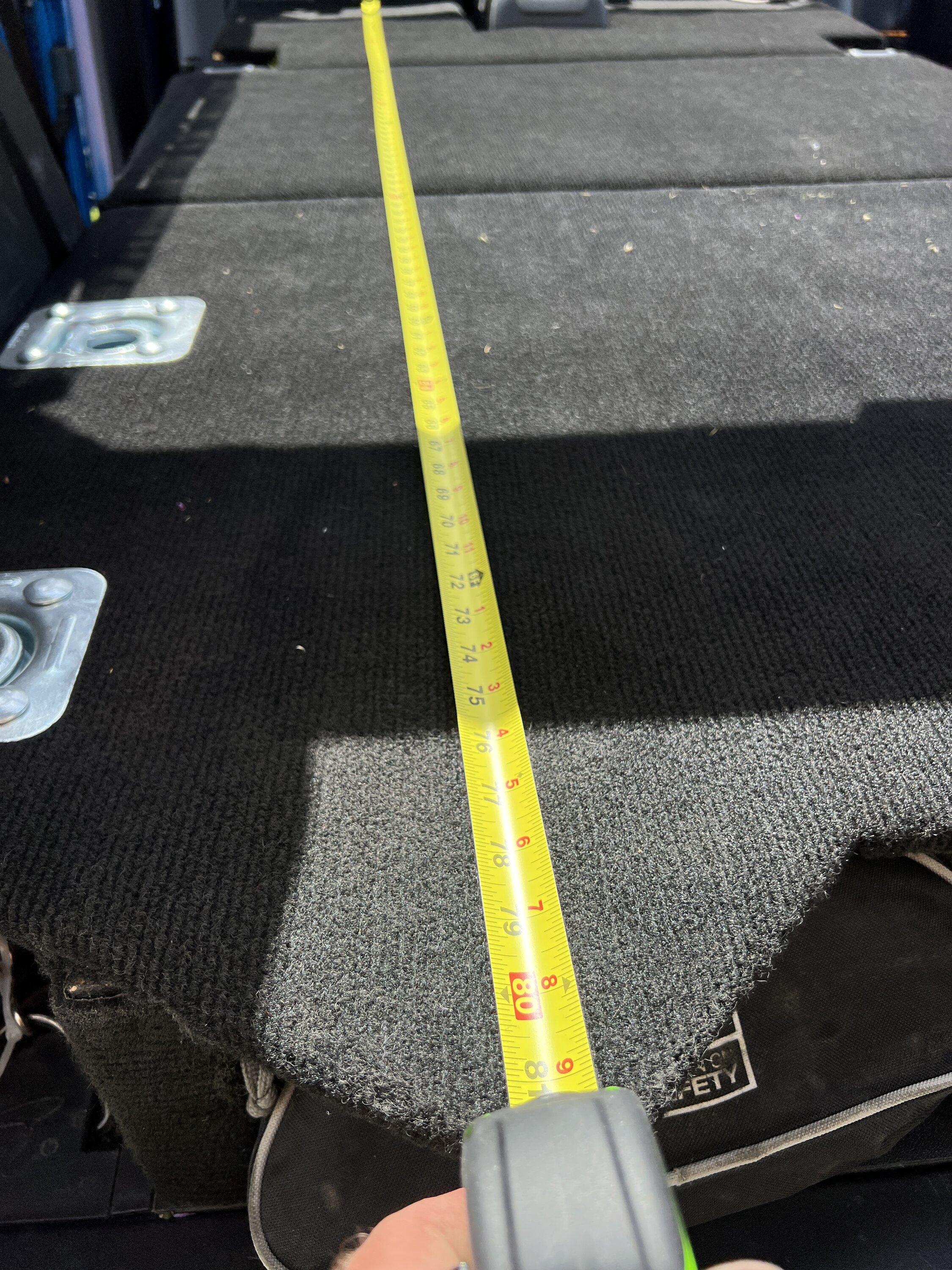

got the other two pieces carpeted and installed today - I laid down back there with plenty of room (I'm 6'0, 205 chunky pounds) ... very happy with how this came out, and I get some nice secure storage underneath as well, that can't be seen or accessed without opening the tailgate :) .. I've got my kinetic recovery rope, Morrflate 4-way inflation hose setup, emergency roadside kit, first aid kit, gloves, blankets, hatchet, and more stored under there.
