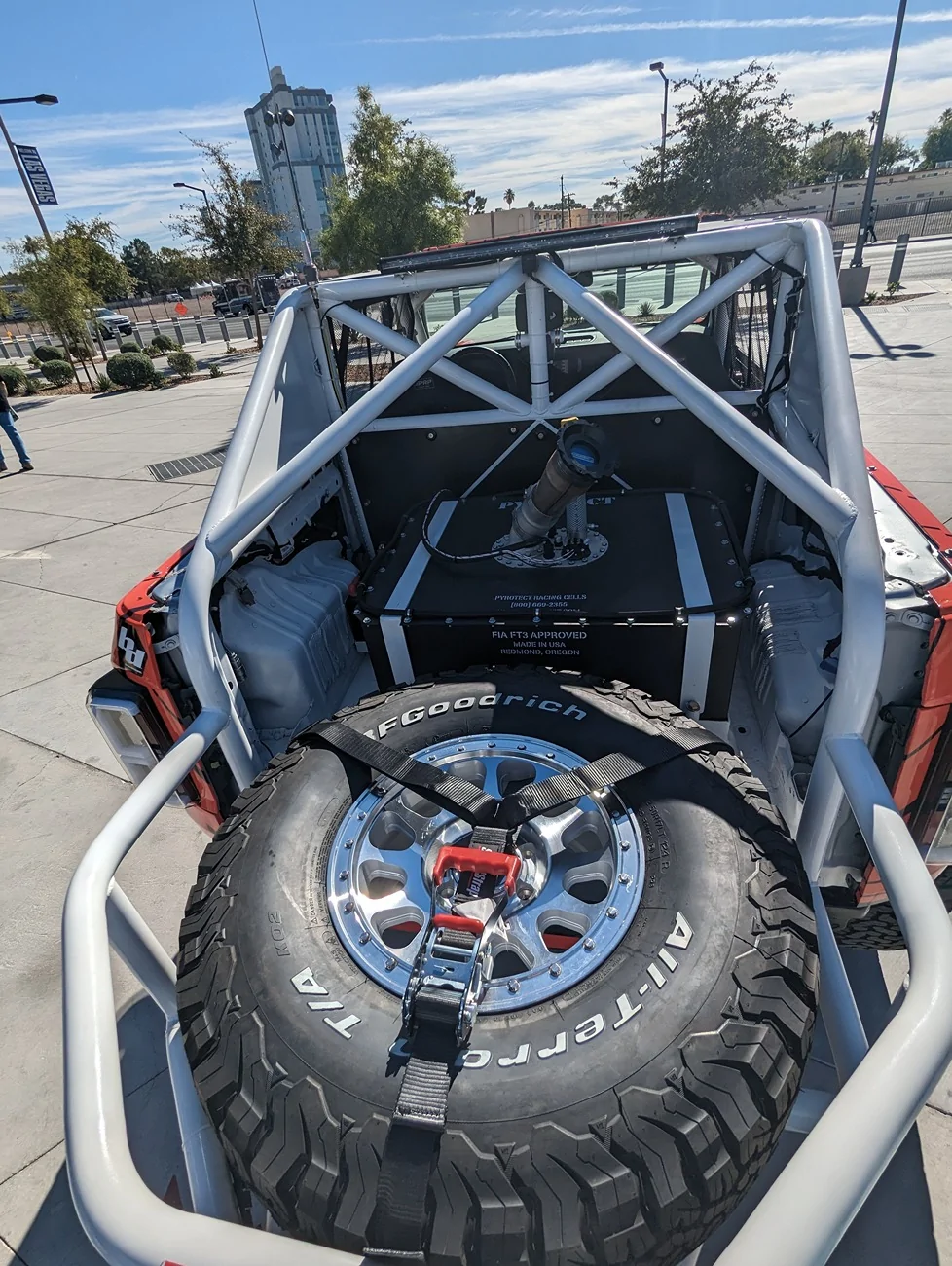

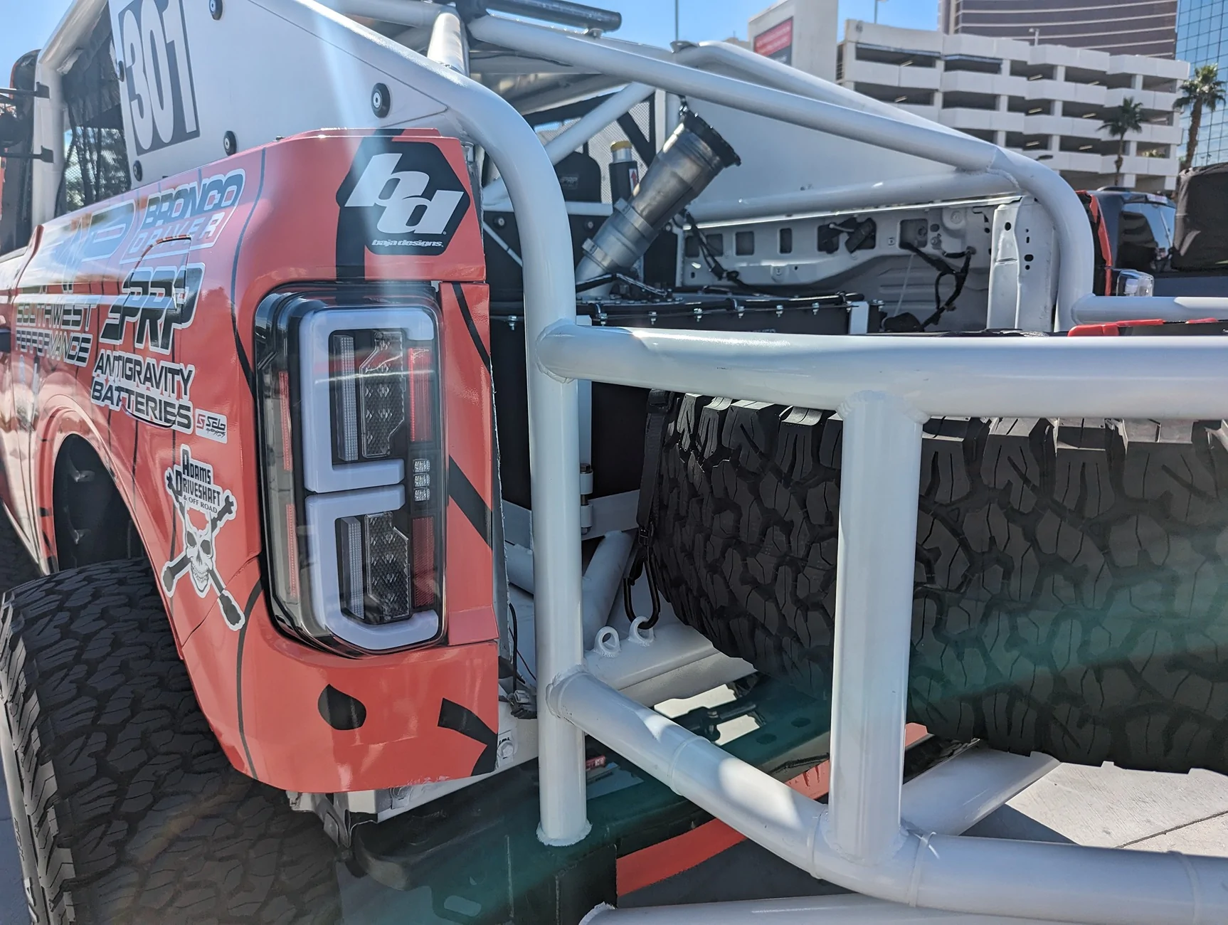

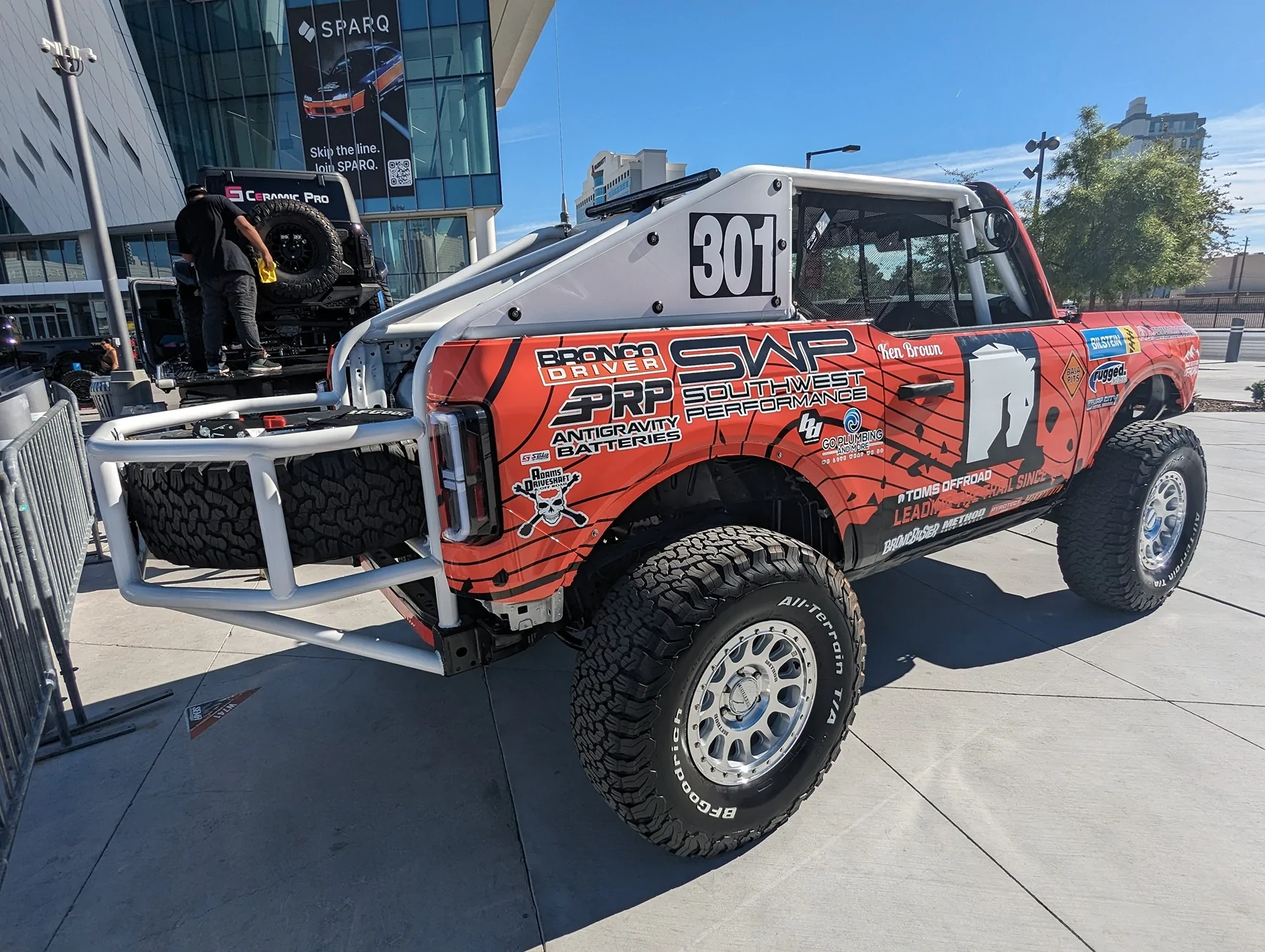

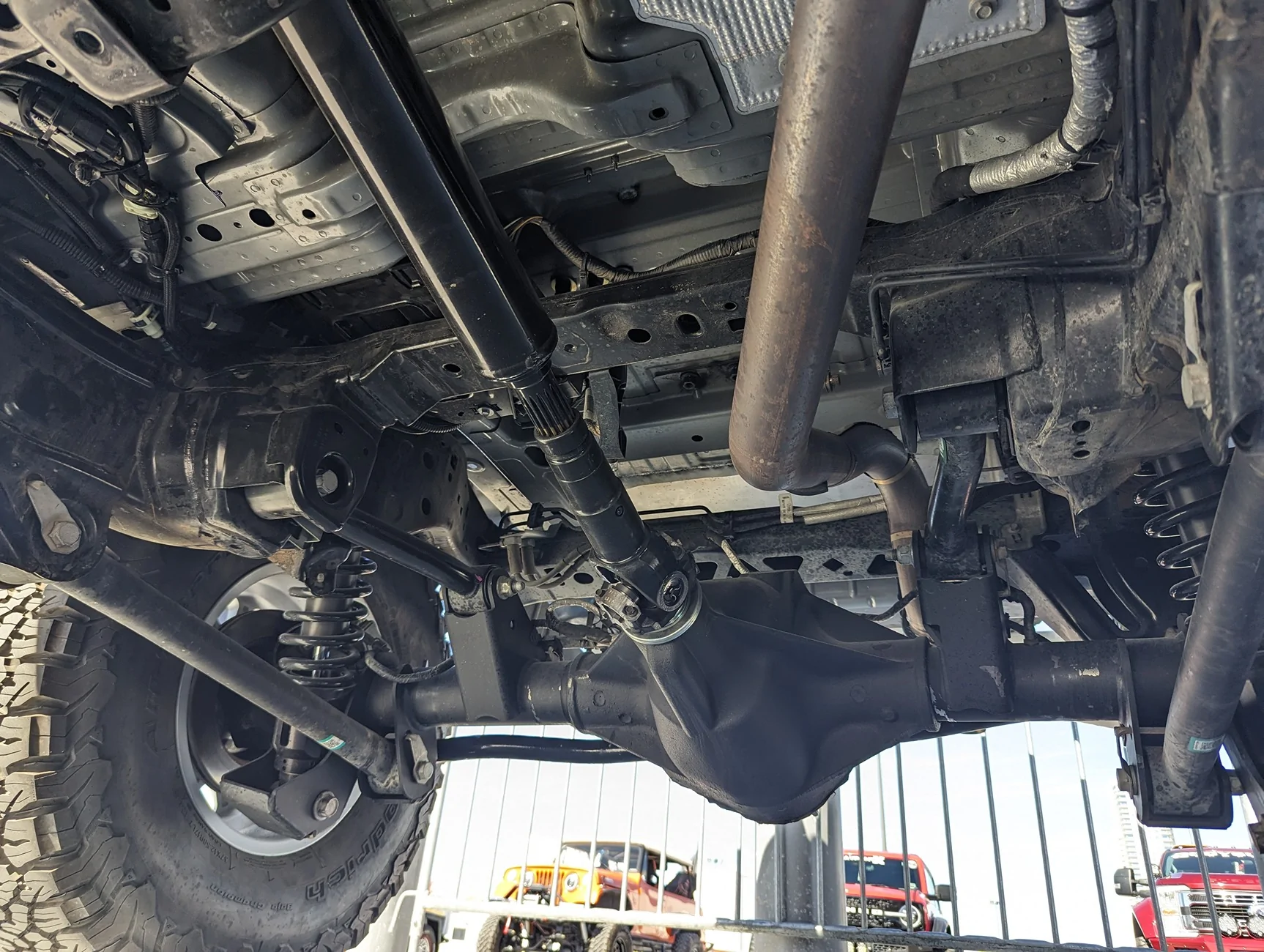

Fuel fill NEEDS to be extended to side of vehicle. In its current location any spillage from refueling ends up IN the racer.
Hopefully the spare carrier has room for two.

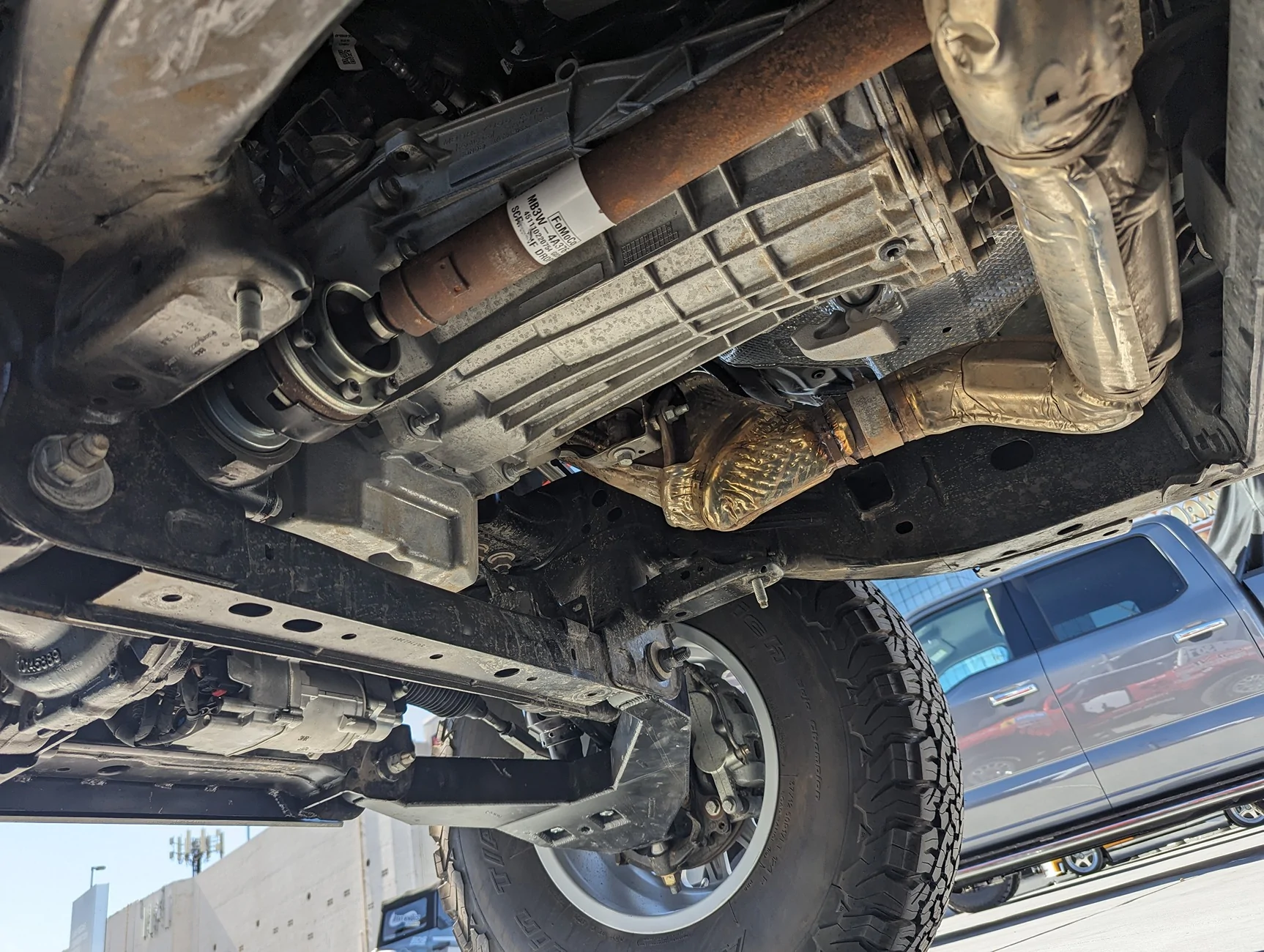

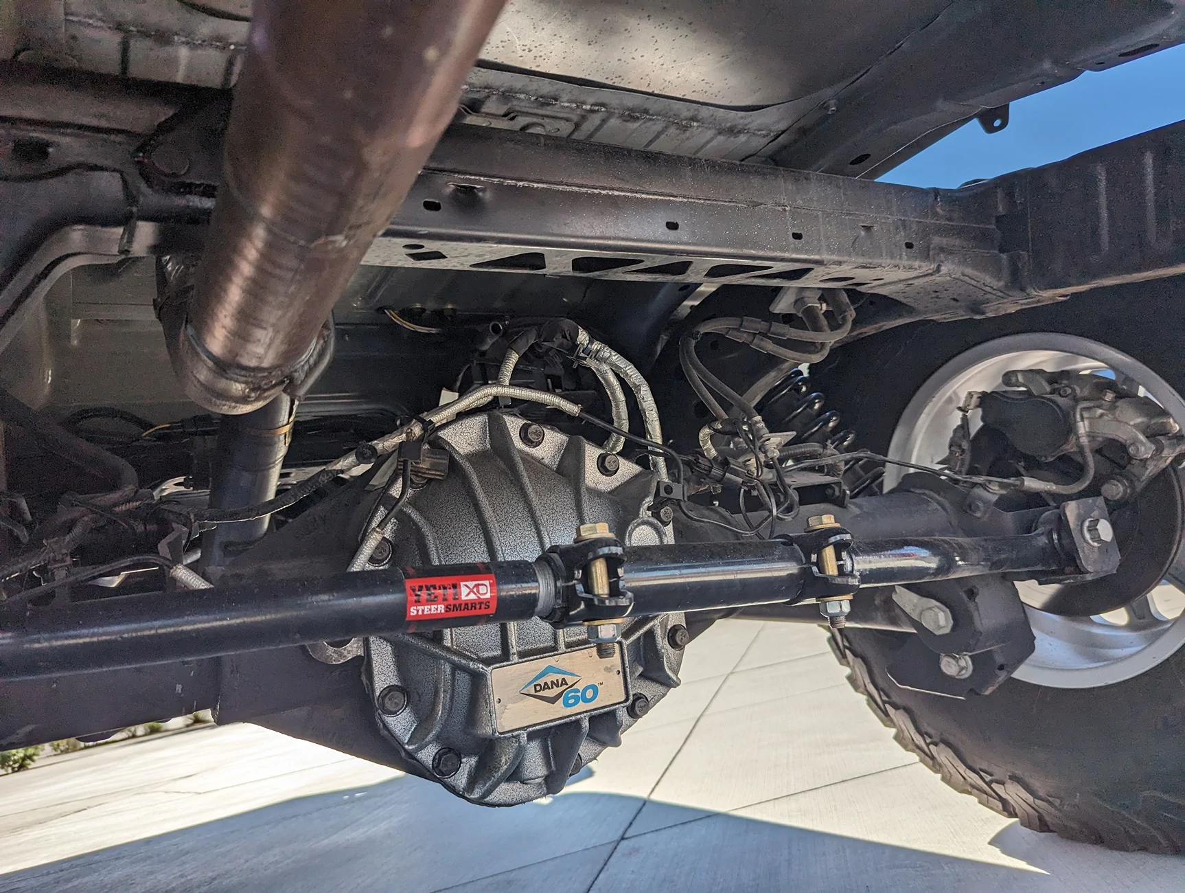

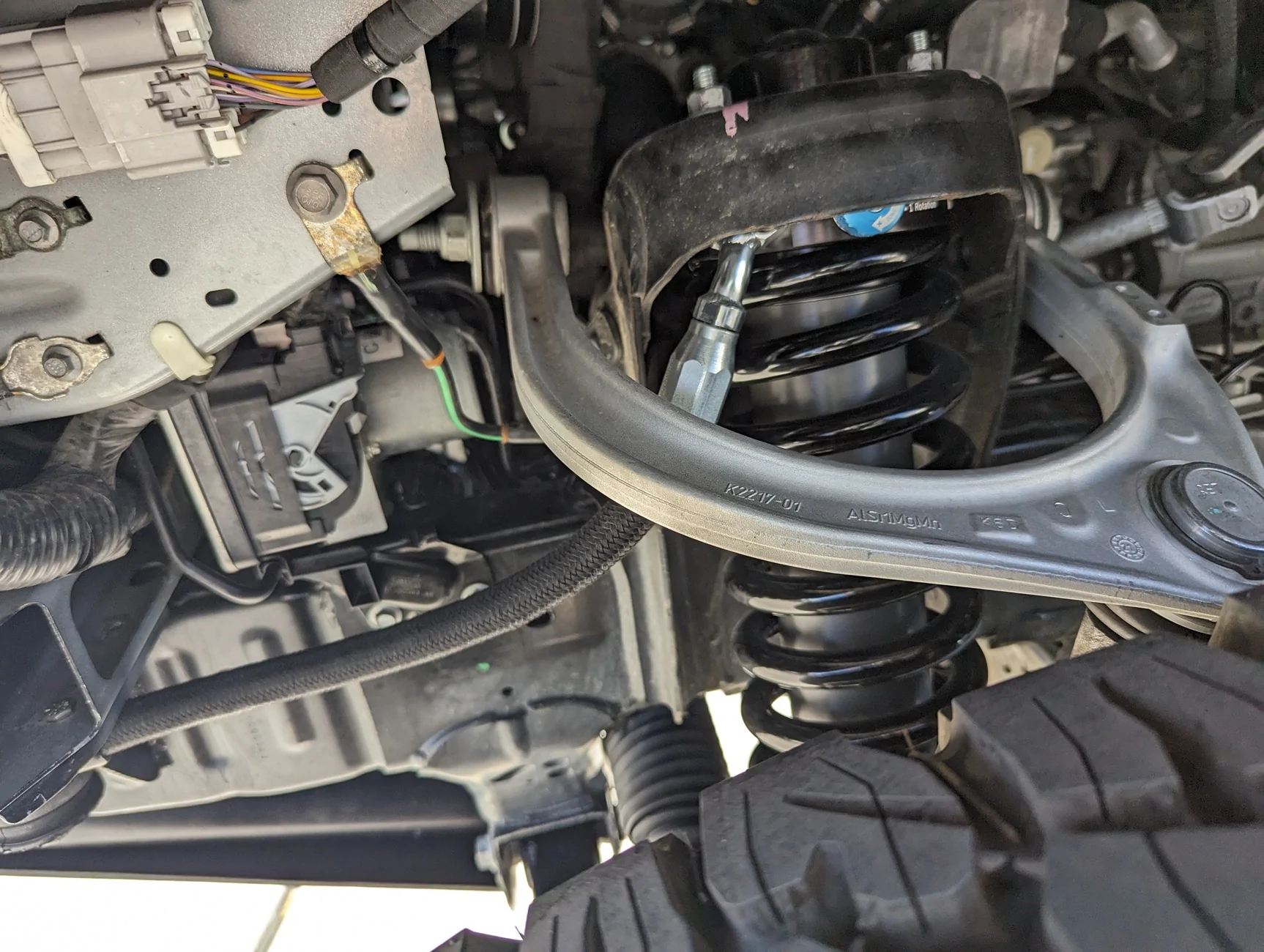

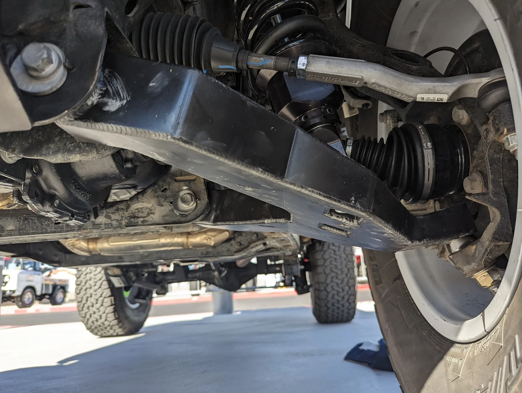

2 things I see that I believe should be considered. The adjusters for the lower control arms should be locked into place better than stock. I saw a kit from someone (can’t remember who) that does this. And the upper mounts need the added tabs to be double sheer. Very cool truck.

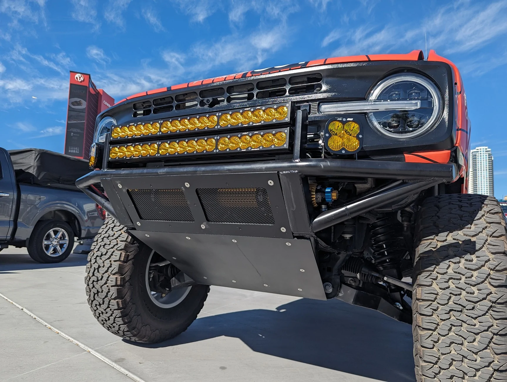

Is it normal not to run protection underneath for a Baja truck? I assume the weight slows you down too much?

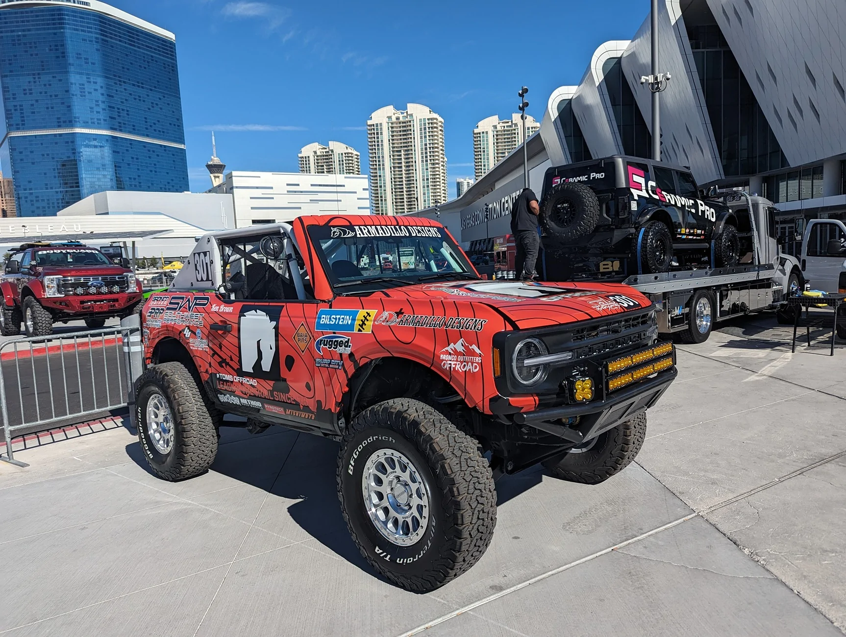

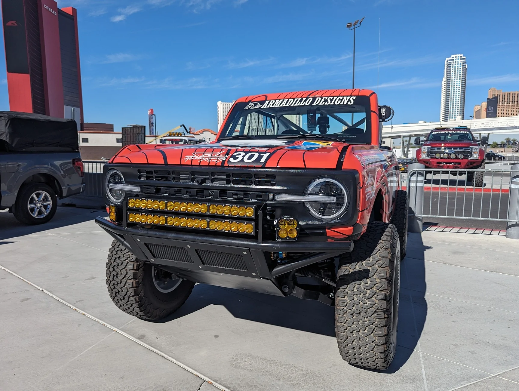

I really like what's done...minimal lift, maintaining some OEM suspension and steering components...adding what's needed to meet Class 3 eligibility without going over the top in beefing up every little part. Looking forward to seeing this rig complete the run! Will be good to see what OEM parts held up and what parts didn't.
Yes, I would (did) definitely make this inexpensive upgrade. BDS Suspension - Alignment Cam Lockout Plates.

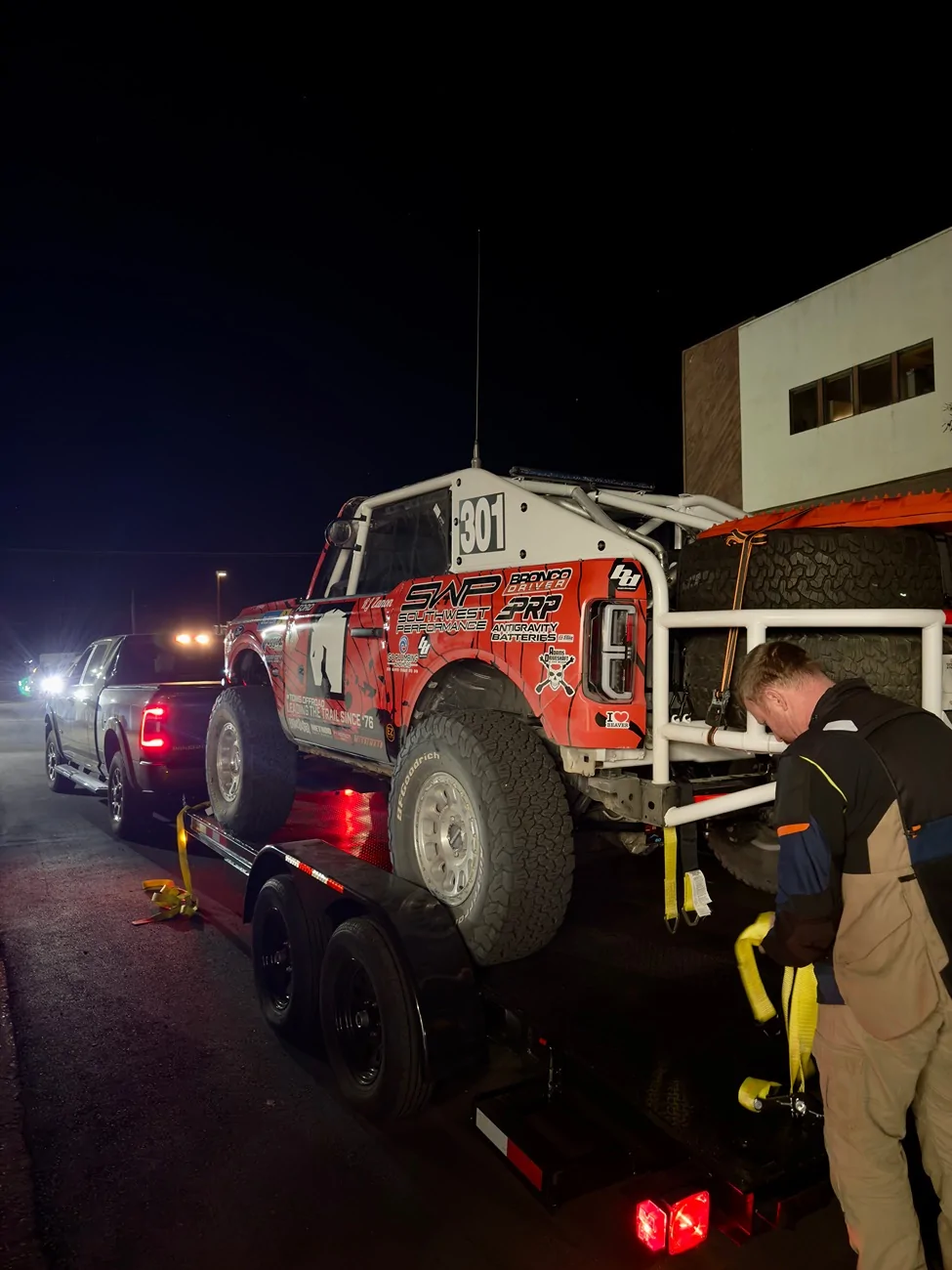

Pictures are hard for me to upload where I’m at but the team is ready for tech in morning! Steve, you would be happy to know that the rack does indeed have two tires mounted, skid plates installed and fuel cell finished :) between media, chase vehicles and the race Bronco. Our grassroots, non paid race team (#301 btw) has more Broncos in our entourage then Ford Racing. The team is made entirely up of volunteers from the bronco community that want RJ (the driver), to succeed in finishing and maybe placing a top spot. There are only 2 other vehicles racing in the Class 3 spot including an older Bronco that is way more modified then us and a Toyota as well with hefty sponsoring.
