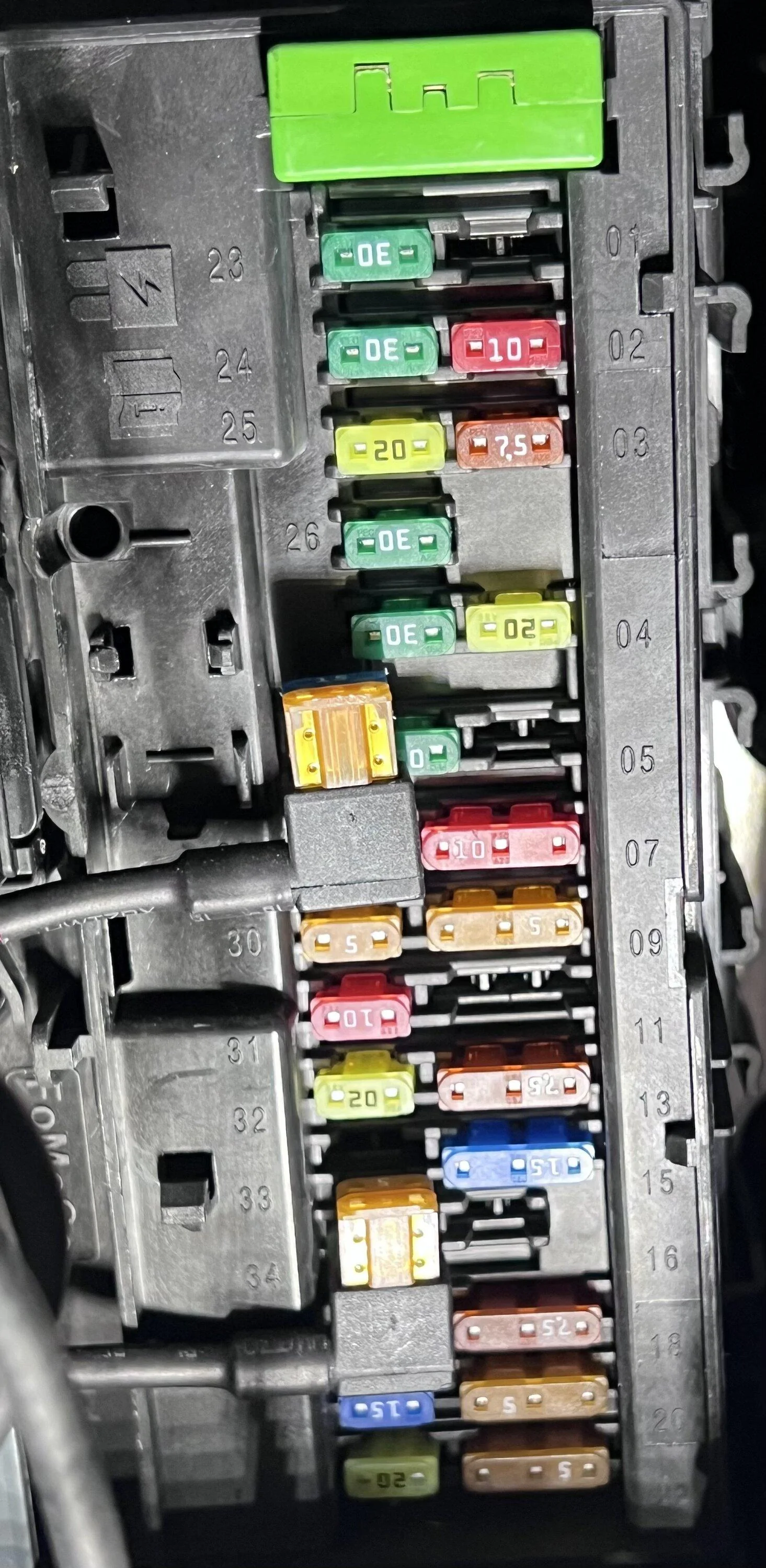

Wiring Question:
Anybody have any tips / input for wiring the fuse tap to the red wire (with the 12v adapter removed)? Not sure what gauge the @ORACLE Lighting wire is, but it’s much thinner than the 16 or 18 gauge fuse tap wire…having a hard time getting a crimp to keep the smaller wire connected.
Fuse Tap Question:
I’ve previously hardwired a dashcam and dash usb port & not sure where to install this fuse tap. Any suggestions?

Usually, what I would do is twist the wire tip, then fold it down over the wire casing. That way you give the butt connector more to bite onto.
