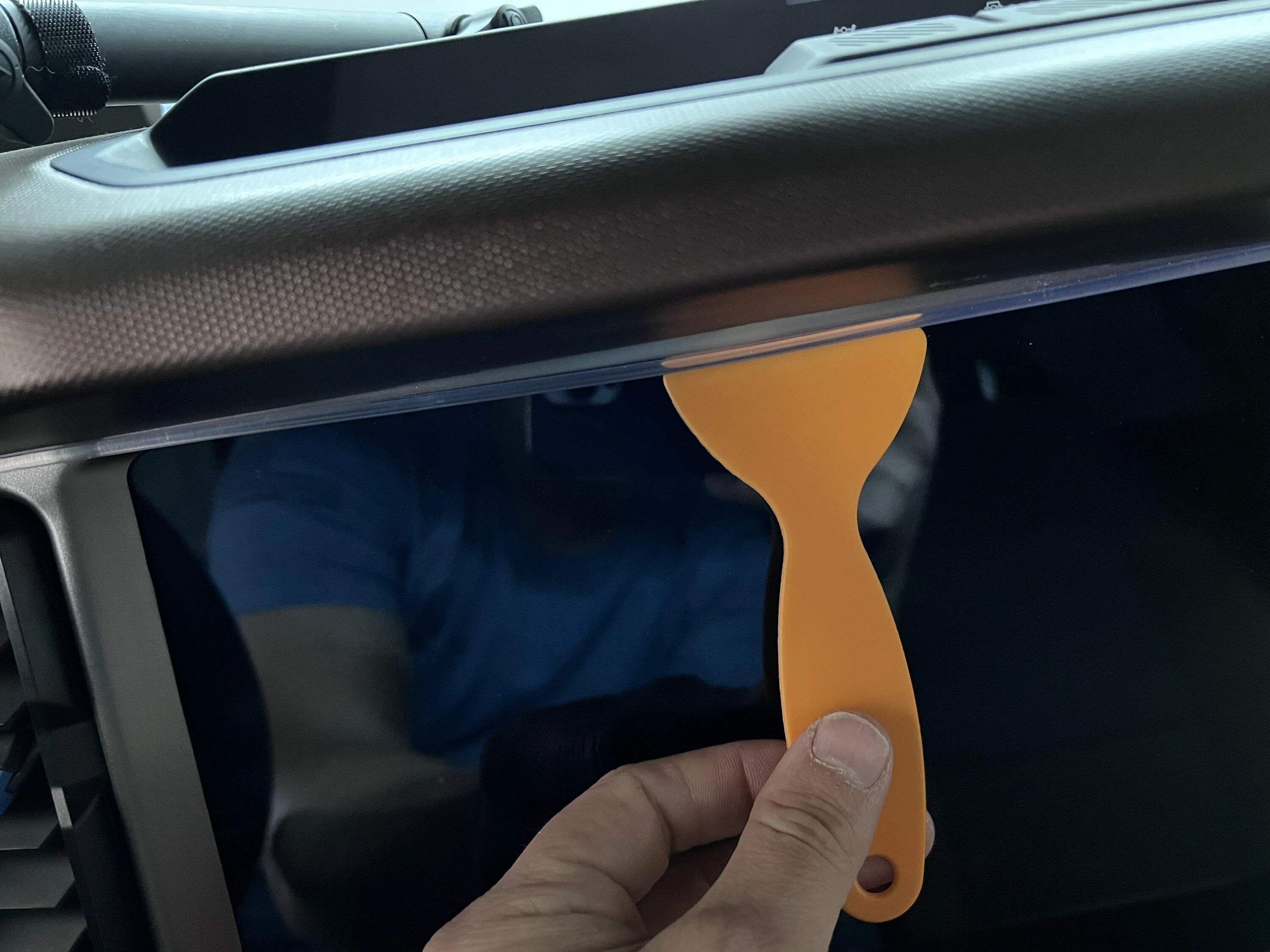

@ORACLE Lighting how’d you feed the strip below the driver’s side vent? Instructions make it sound like it’s no big deal, but after initially getting it wedged half an inch…it runs into a wall. Did you notch it in this area?

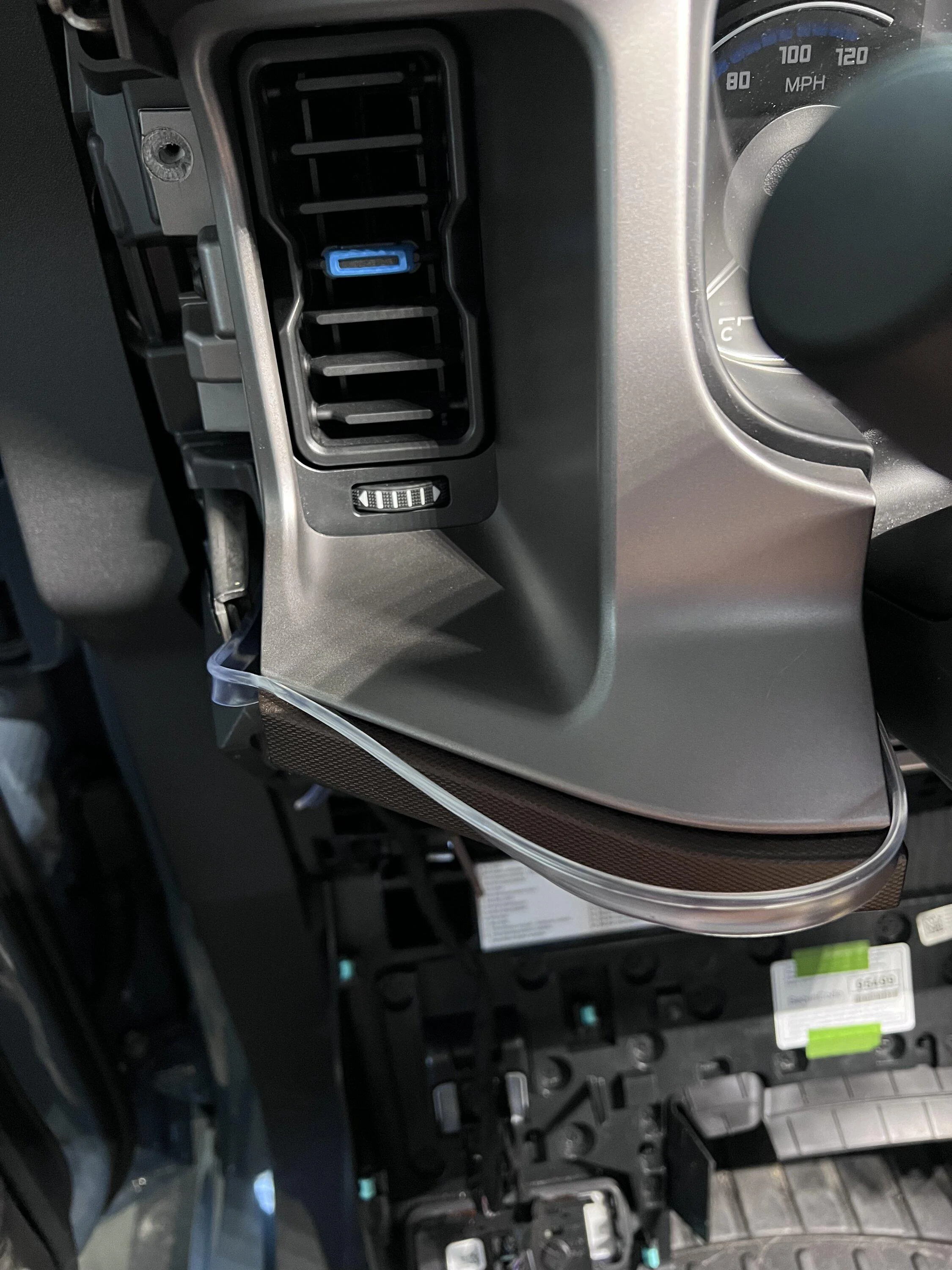

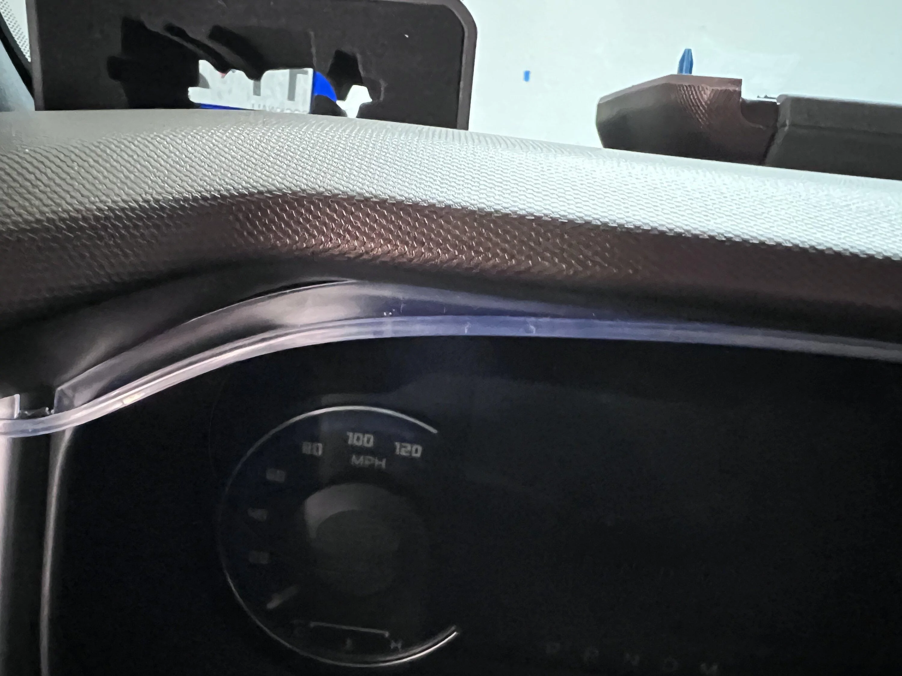

Any recommendations for fixing this sag @ORACLE Lighting ? There isn’t enough tightness to keep the strip from sagging over my 12” display. Have tried pulling the end tight, but the problem persists.
Similar issue with the strip over the the instrument cluster. Too loose to stay in place.
Ford Bronco First Look: ORACLE Lighting accent lighting for Bronco Dash 95FA89B0-F9FC-4A04-BBBF-886F6C3320A4
Ford Bronco First Look: ORACLE Lighting accent lighting for Bronco Dash BDEAC386-2142-4759-BBDF-125743667CA5
That particular panel is pretty tight. You should be able to use the included panel tool to help feed that fin into that space. Essentially creating a slightly larger gap to push into as you go.
We did not encounter this on our install. However, in normal cases when trying to put this PMMA cable into an opening that is slightly larger, some adhesive on the fin goes a long way!
