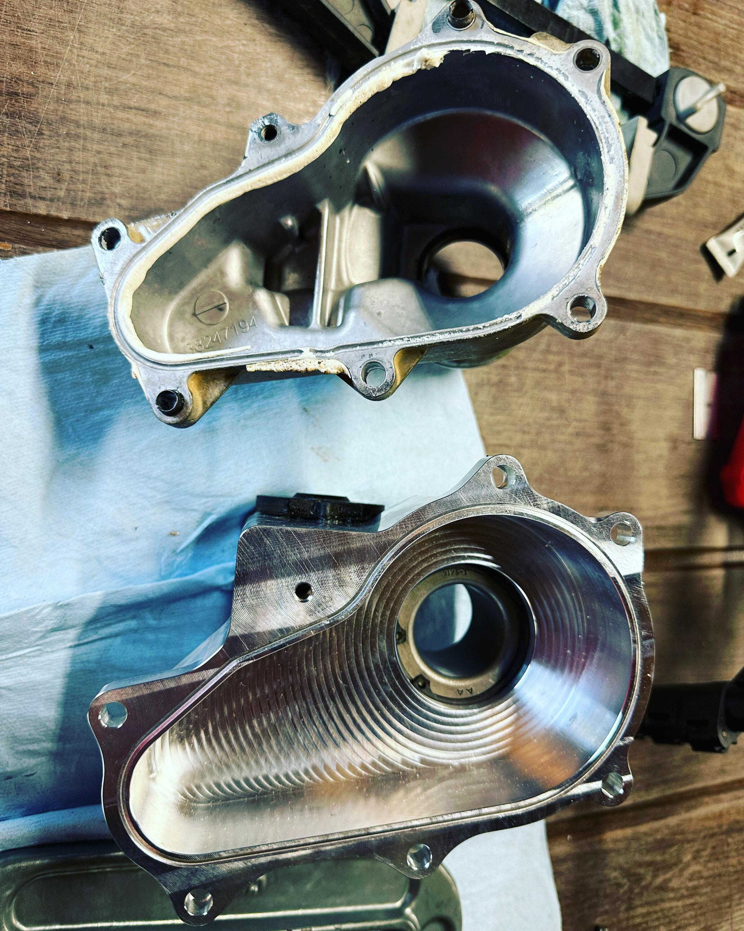

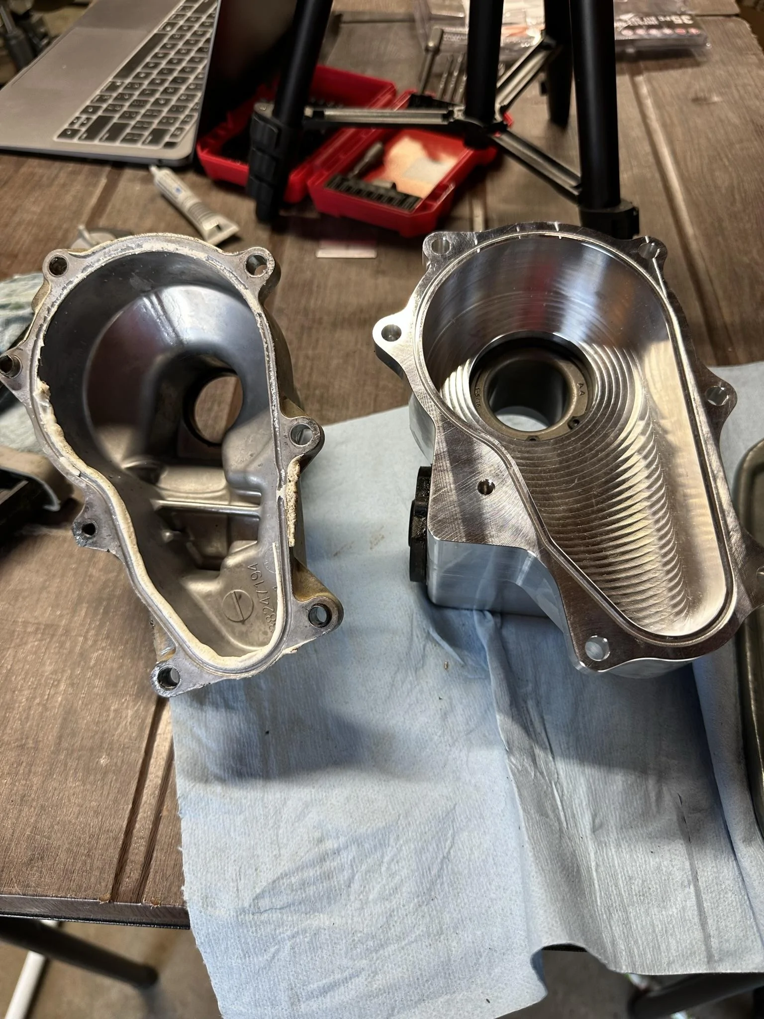

I opened up my stock housing and found that even though I’ve only been lifted a little over a week with only a few minutes of flexing at my local OHV park for tuning. The OEM housing had the bushing elongated already. It was slight, but visible. The edge of the rubber was toughened and tearing up a small bit and I also had a “polished” spot on the housing in line with the elongation that was being worn by the steering screw.
The biggest surprise was dirt on the steering screw. My clamp apparently hasn’t been doing a great job of keeping it clean in there.
The difference between the OEM housing and BB’s housing is HUGE. Both in weight and feel, the high quality is apparent.
I can tell by looking at the difference, the BB housing is going to give the steering way more support and strength at my new angles.

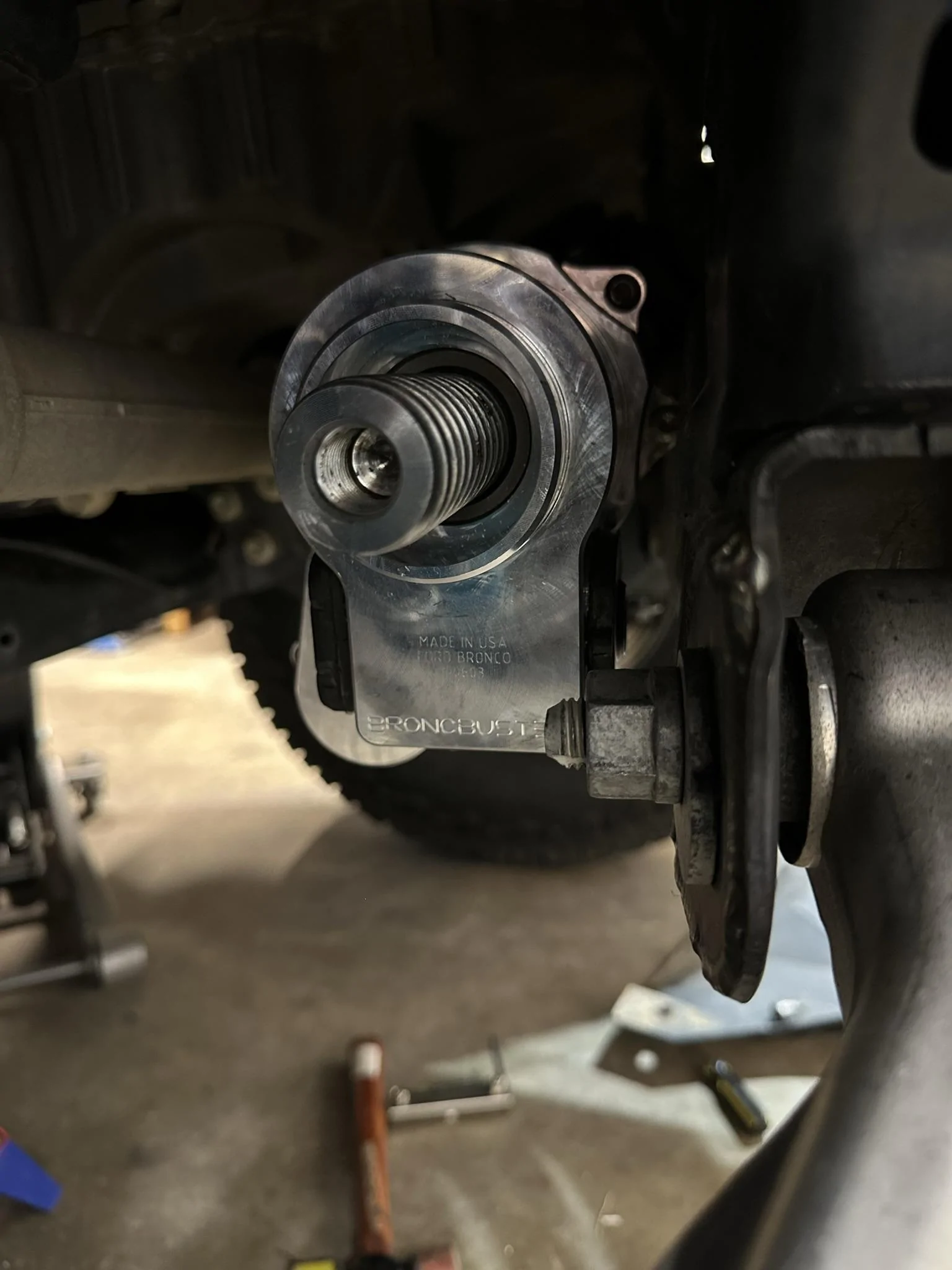

After installing, the difference was very noticeable. The steering “binding” and heaviness was gone and my steering felt responsive and fresh again. It honestly was a difference felt right away.
Now I need to go get an alignment and I’ll post my final thoughts after that this Tuesday. I’m stoked for the assistance from the housing and thank you BB for this awesome product!
Some things to note, this does NOT solve issues from improper alignment, bad tires nor too much steering angle on your tie rods. Those are other things you’ll have to deal with. This does offer way more support and prevent any steering binding on your housing and gives that peace of mind you’re not going to blow your rack in the trail!
