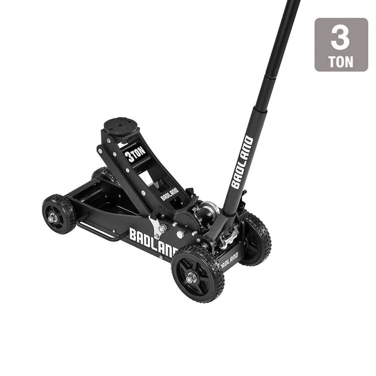

I am now a 100% garage family, and my old sedan hydraulic floor lift/jack simply won't work. I'm looking at a couple of brake jobs in the spring for the other two SUV's in my family and curious what floor jacks for SUV's you guys are using or recommend that you've seen, within price reason of course. Just a rolling jack is all I need, one wheel at a time. Many thanks!!!

Although I used to ridicule Harbor Freight, they have REALLY stepped up their game in recent years. Their BADLAND 3 Ton Off-Road Jack is incredibly well made and well finished. I've easily boosted my Raptor up on to 4 jackstands with this jack. I believe I posted elsewhere here on the forum with some additional comments on this jack.

I like the low-profile, rapid pump style floor jacks. I DESPISE the steel wheel & bushing jacks; they eventually freeze up, and no one wants to drag 75-100 lbs around on the floor. I toss them and put on packed bearings, and new wheels if necessary. The HF 3T Off-Road is a nice jack, and the right one for the Bronco (vs. 1.5T). But I don't know if that is adequate for your other vehicles.
How much weight your are lifting is the key. It's not just the GVW. It's GVW+ all the other stuff in/on/and added at the moment you are going to jack up the vehicle. Also, front to back does not distribute 50/50. Same with side-to-side (like an awning mounted on the right side). So, GVW+added stuff weight = lifting weight. If you are doing corner lifting (per tire), most recommend multiplying by 0.525 (30% of the weight plus 1.75 safety factor). Then choose then next highest tonnage rating. For example, the Bronco Sas on average comes in at 6,250 with 56% weight in front. (6,250 x 0.525 x 1.06 = 3,478) or rounded up to 2 tons.

Another vote for the HF Badlands 3 ton.
It’s been awesome and I have used it a whole bunch between working on my Bronco and buddies GX.
I scored mine with a 20% off any item coupon a couple years ago. Zero regrets.
The Badlands 3 ton off road jack is great. Easy to roll even in gravel, comes with an easy to detach/install height extension and lifts the entire rear end of the Bronco with ease.

Off to Harbor Freight I go! Many thanks guys!

I have a HF Badland 3T “LONGREACH”. My old Jack could not get the wheels off the floor using the jack point. And, I read “somewhere” that the badlands jacks are manufactured on the same factory line used by Snap…🤷🏼‍♂️
