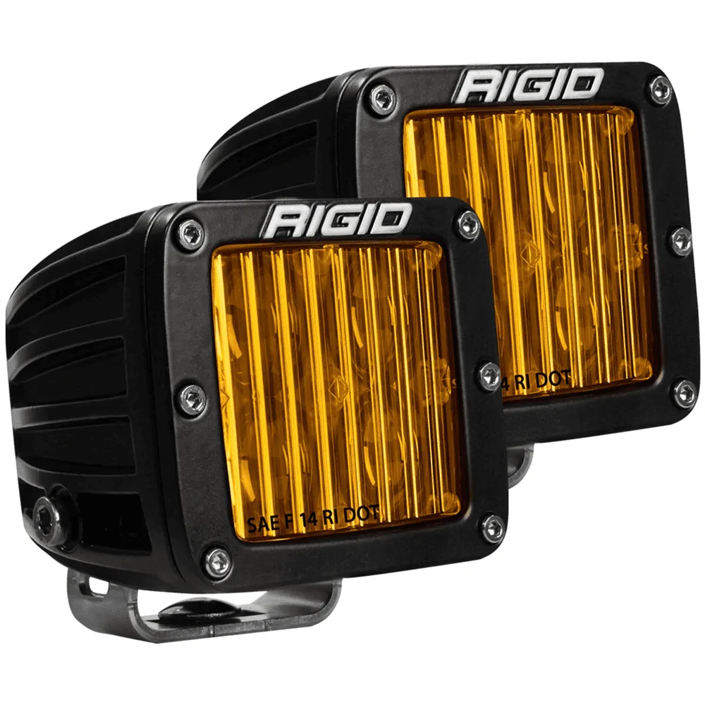

So you are planning on mounting the available Rigid pod lights onto the bumper to use as fogs? You can do this, but it looks like Ford wants to mount them on at the A-pillar when you select them in the build and price, so you might have to move them yourself. Also, the lights available from Ford probably do not have the correct beam pattern to be used as fog lights.
Whether you have factory fog lights or go aftermarket, you should be able to turn them on independently. Meaning, the headlights do not need to be on in order for the factory switch to work. Anything wired into one of the upfitter switches will also be able to be used without the headlights being on.
If you meant you are having two sets of lights, one set on the A-pillar and one down on the bumper, they will likely be controlled by separate switches and definitely can be controlled that way if you rewire them or wire them yourself.
Because the Badlands is not available with fog lights, I will be adding a factory foglight switch or using one of the available upfitter switches to control them. I would prefer integration into the factory switch and harness, but I am unsure how difficult it will be to add.

I plan to utilize Baja Designs lights to be installed after I take delivery. Although Rigid could have similar lights, the B&P did not provide us with the details I needed.
I began by understanding the Lighting Zones so I would select the correct options.
https://www.bajadesigns.com/Science-of-Lighting/Lighting-Zones.asp
I will probably select Squadron SAE Pair LED Wide Cornering, Amber for street legal snow/fog/dust. These will give me coverage in Zones 1 & 2. These will be placed within my Badlands steel bumper.
https://www.bajadesigns.com/products/Squadron-SAE-Pair-LED-Wide-Cornering-Amber.asp
Next, I will select Squadron Sport, Pair Amber LED Driving/Combo for Off-Road Only where snow/fog/dust is an issue. These will give me additional coverage for Zone 3. These will be placed in or on the steel bumper.
https://www.bajadesigns.com/products/squadron-sport-pair-amber-led-driving-combo.asp
For my ditch lights, I will select S2 Pro, LED Spot for Off-Road Only ditch illumination. These will give me coverage for Zone 4. These will be placed on the ditch light location next to the rear-view mirrors.
https://www.bajadesigns.com/products/s2-pro-led-spot.asp
In addition, I will be installing lighting for Zone 7 in the rear and maybe a lower grill level light bar which will not compromise my front trail camera for additional off-road driving/combo lighting at a later date. Rock lights attached to the underbody may be considered. I will be certain to allocate my aux switches accordingly.
For me, it is a more comprehensive plan than utilizing the B&P options.
Last but not least, I will probably be using a dedicated fuse box (space permitting) rather than inline fuses to aid in ongoing maintenance.

I've learned that if you are able to direct fog lights slightly downwards so that it is actually illuminating the road itself, it will diminish glare by a LOT .... goes without saying that fog lights have to be mounted low

"FOG" lights have a shield on the bulb to prevent the beam from being directed above about 80º, otherwise the light is just reflected back at you by the fog, making visibility worse, like turning on your hi-beams, the shield produces a Flat wedge shaped beam that cuts thru and under the fog, illuminating the road, using a pod light as a fog light more than likely will not work out well for these reasons. I am a fan of a very bright RED rear light (drivers side) as most accidents in fog are rear end collisions.
