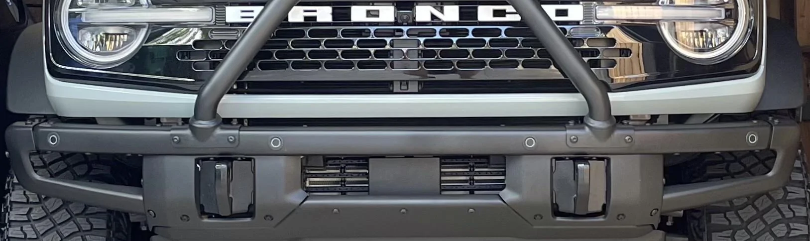

Here is my front bumper, for example. You can see that the right (driver's) side sits slightly lower than the left. Hoping it's an easy adjustment! My rear bumper has the same issue.
Like I said, I've noticed the same to varying degrees in MANY Instagram and forum owners' posts, particularly with the HD bumpers. Don't hold me responsible if you go inspect yours and find similar when maybe you hadn't noticed it before now ;)!
Not an issue.

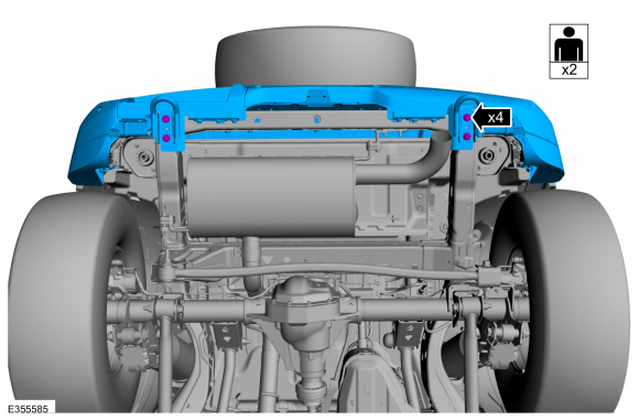

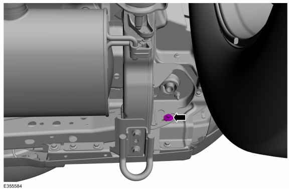

Looks like it's just the 6 bolts in pink.
Rear....
Did anyone try to adjust rear bumper?
From the picture the this is for horizontal adjustment instead of bring it up or down?
Do you need 2 person for this?
Not much adjustment built in unless you slot holes. Best way to do is with two but can be done if you loosen bolts just enough where it moves with some force but not enough where it flops around. If its way off you may have something bent.

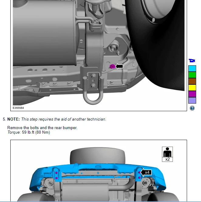

My rear bumper (Bigbend 4dr) bumper was hanging lower on the passenger side than the driver side.
I was able to loosen the bolt on the right side curved slot...raise the bumper with a tall enough floor jack, retighten bolt and it is now level. The bolt was easy to loosen so assume that was the problem.

Removal
NOTE:
Removal steps in this procedure may contain installation details.
  1. Raise the vehicle on a hoist.
    Refer to: Jacking and Lifting (100-02 Jacking and Lifting, Description and Operation).

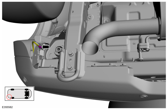

Vehicles With: Rear Fog Lamps/Rear Parking Aid
  1. Disconnect the rear bumper wiring harness connector.

  1. On both sides.
    Remove the bolt.
    Torque: 20 lb.ft (27 Nm)

  1. NOTE: This step requires the aid of another technician.
    Remove the bolts and the rear bumper.
    Torque: 59 lb.ft (80 Nm)
