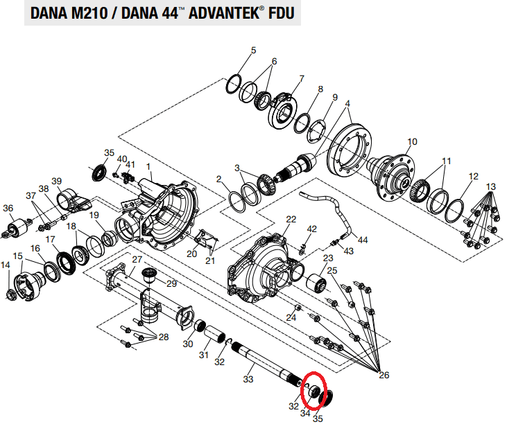

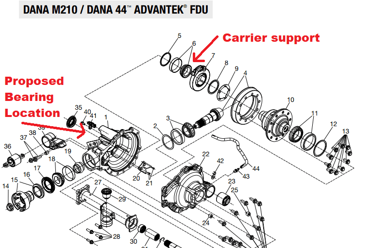

So the differential use the same seals on both ends, meaning they are the same diameter. I am pretty sure we can find a bearing that fits. We could also get a bushing made but I much rather have something more off the shelf as I could see someone charging a huge bronco tax on the item.
The metal on the cv shaft is the carrier. There is zero support for the cv axle! I think this is the reason the Drivers Side CV gets stuck in the housing which has been an issue for a few people.
Ford Bronco Front differential discussion 1697035846455
This is the next upgrade, I do not see this being a huge strength increase as much as a longevity improvement. This should also help with the life of the seal, the whole reason I had to pull my cv was to just change the seal that lasted 7k miles? Should be a popular modification once we find a bearing.
Ford Bronco Front differential discussion 1697036004399
I am back to saving for a m210 since I spent that money on shocks because I can't pass up a good deal. So this project had a financial set back lol.
I originally thought we could use the passenger side bearing but the cv axle race is not long enough so back to the drawing board.

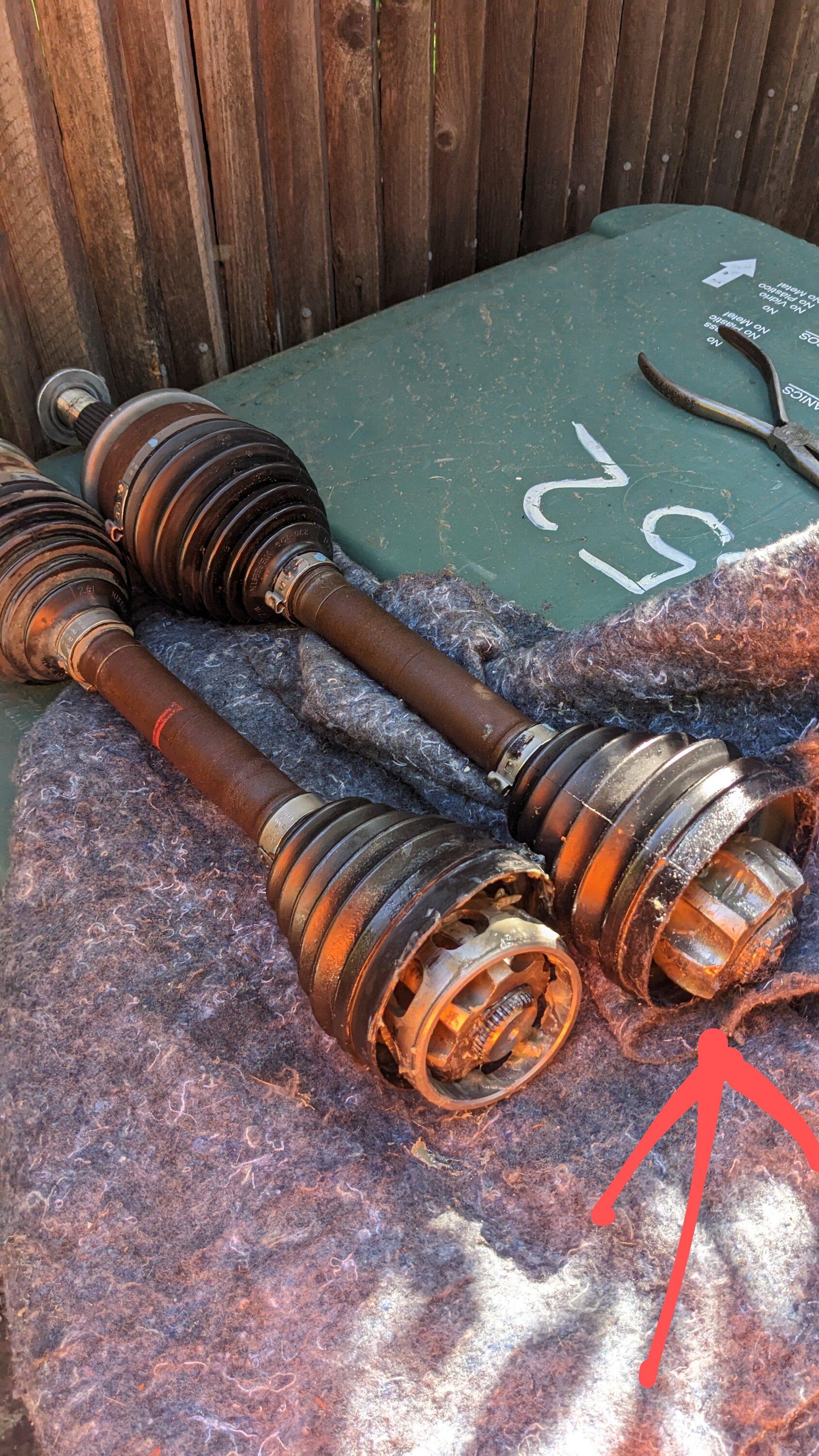

@builtMIbronco Thought you had Fad... That throws a wrench in everything. If your not locking the front when it's happening you might have a cracked star inside a CV axle. Very unlikely but if the star gets cracked you will get loud pops. I have only seen this once on a Toyota with a home assembled birfield (took a bunch of broken parts to make one good one). Or it can be a broken race in a CV allowing the balls to move and pop. Broken races usually fail rather quickly due to stress and you would see carnage.
