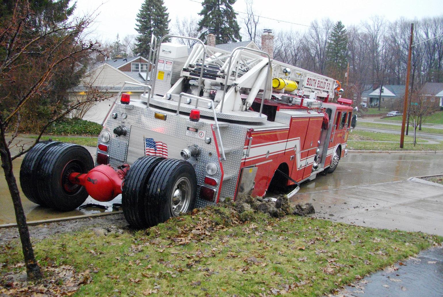

The rule of thumb is that you need to have them within 1% of each other. I've seen Jeeps with a 4.11 front Dana 30 and a 4.09 rear Dana 44 from the factory. That's 0.02 off which is 0.5%.
There's always a little variance in tire size and what not. And the differentials accommodate it pretty well up to a point.
Ford Bronco Front Differential? 1616468211026
