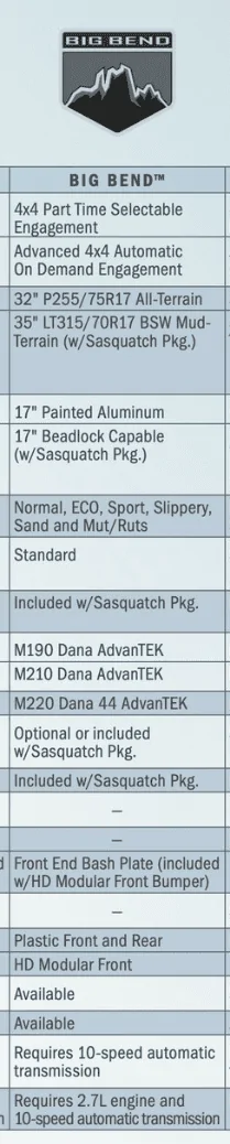

Ford Bronco Front Differential? Screen Shot 2021-03-22 at 12.03.12
AcesandEights
Ace!
Nov 19, 2020
1,229
2,488
Oregon
DR650
I see alot about the different rear differentials but nothing about what do they have for the front differential. Can someone please explain this. Also with the 4.27 locking rear Axle what kind of highway speed and mileage will it get?
The front and rear differentials are "Dana" differentials. Depending on the trim, you have different Dana differentials. The difference is really the size of the gears, the internals. There are larger ring and pinion (gears), and that determines strength. Front and rear differential gearing needs to match (or be very close). If they are not the same, the drivetrain will bind, or the tires will wear more and screech, or they will lose traction off road. Ultimately the tires will turn at different speeds. This will break or wear things out on road.
The differentials are sized (the gearing, for example 4.7:1) to accommodate tires size and how the vehicle will be used off road. Ford has determined the sizes, and either will work fine. The differential gearing will impact RPM, but the transmission is obviously part of the equation and the gearing in the transmission includes overdrive (less than 1:1 gearing) which brings the RPM down to be more fuel efficient. No one knows yet what kind of mileage you will get, as Ford hasn't published EPA ratings yet. You'll be able to drive faster than any posted speed limit in the US.
You have choices in differential gearing which will impact the highway RPM, but more importantly will effect the "crawl ratio" (torque multiplication) off road. That's kind of the point of having those gearing choices, to provide for more off road torque and accommodate for larger tires. The locker doesn't have an impact on your highway speed or mileage. You can use a locker (not necessarily the Ford locker, by design) at any speed, but it impacts the handling. Ford likely has the locker(s), front and/or rear, disconnect at highway speed. This will save wear and tear on the drivetrain and tires and keep it from handling funny at higher speeds. Auto manufacturers will tend to have the locker disconnect at speed so you don't get those quirky handling issues on road.
ETA: as an aside, maybe helpful to the understanding of differential strength, the "number" used is/was the ring gear size in inches or millimeters. So you'd see either in inches, "Ford 10.5" meant a 10.5" ring gear, or something like a Dana 210, which is in millimeters and equates to a 8.27" ring gear. Often you'll hear someone say, a Chrysler 8.25", Ford 9", Toyota 8", etc. and that's kind of an indicator of strength. There are other differences in design, axle diameter, how they are retained, etc. that gets all in the weeds, but you can sort of equate ring gear, and subsequently pinion gear, to axle strength. A Dana 44 is basically the size of a Chrysler 8.25 slightly larger than the Toyota 8" (although the spline count, semi/full-float, c-clip, etc all plays into what is the weakest link in the differential).
