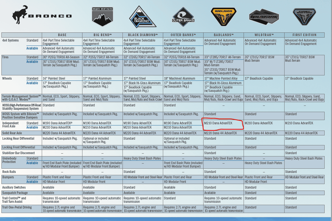

I believe there are 2 front differentials available in the 2021 Bronco. can anyone confirm that a non sasquatch Badlands manual trans has the stronger of the 2 available?

Badlands has the stronger/larger M210 up front no matter what.

It does M210 Cast iron vs M190 aluminum housing

SAS will have the m210 too.
