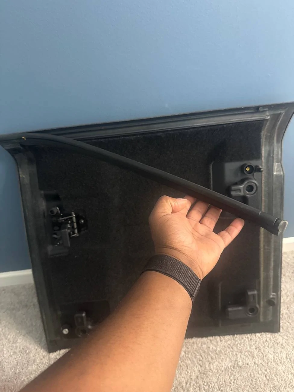

hey everyone!
I recently purchased a 2021 badlands with a hardtop and after taking the driver side front panel off I noticed this strip here is detached. Anyone else run into this? Is this something that can be fixed/ replaced?

I don't have the MIC top, I have a Rally top. It has a similar piece of weatherstripping. I used some RTV and glued it back in place - been holding fine for almost 2 years now.

On my previous Bronco the passenger side was completely missing. It was replaced under warranty.

My passenger side is just like this. I've tried to clip it back in with no luck. Tried 3M tape as well and doesn't stick.
