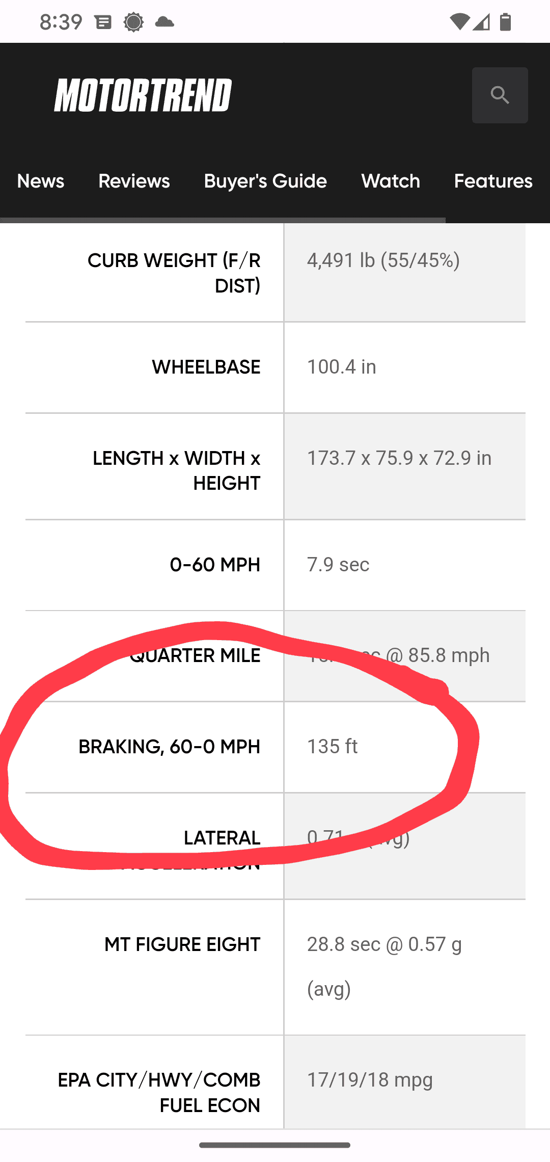

Motor Trend instrumented test of a Black Diamond.
Ford Bronco Help! How do you stop this thing? A stat you probably didn't know (149 feet brake distance). Screenshot_20220920-203956~2

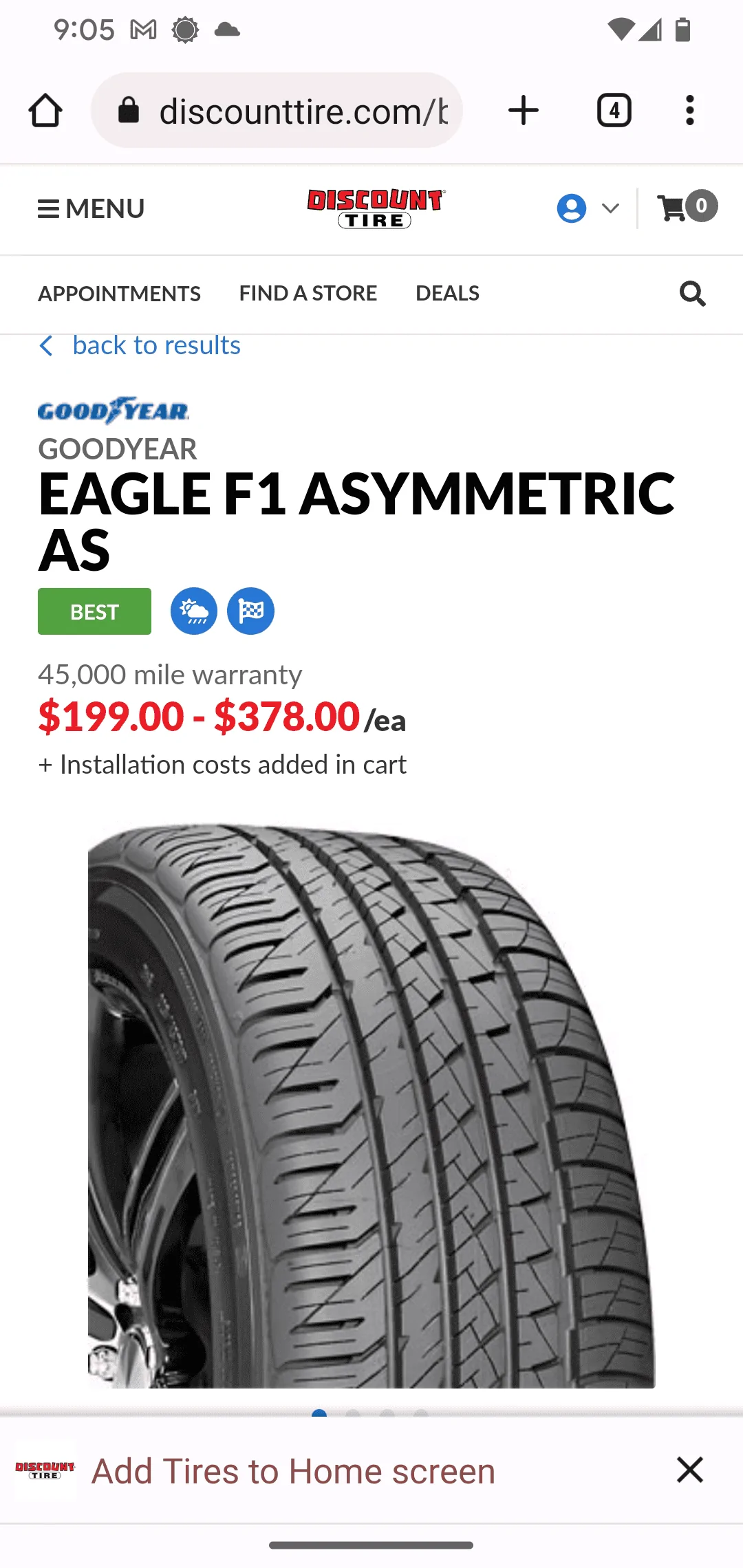

Or, you could mount up a set of these!
