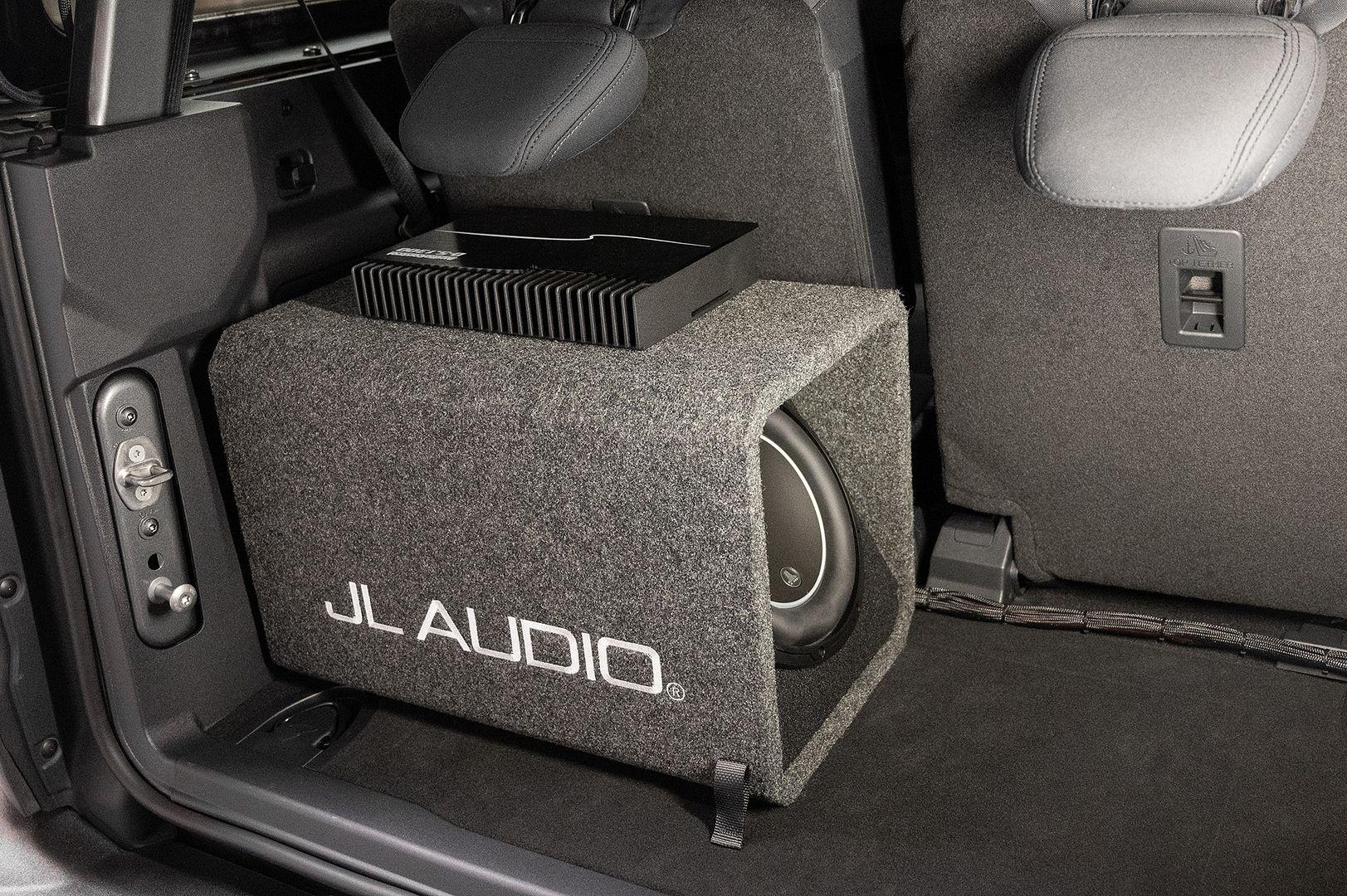

Sub is in. I had thoughts of hiding the amp, but the fact is you can't really see it where it sits anyway. By mounting it on top of the box, it will cool better, and any adjustments are certainly easier to make...

Thanks. This really has turned out as good as I had hoped. I've owned louder systems for sure, but never anything remotely this accurate and clean. It makes driving a pleasure....

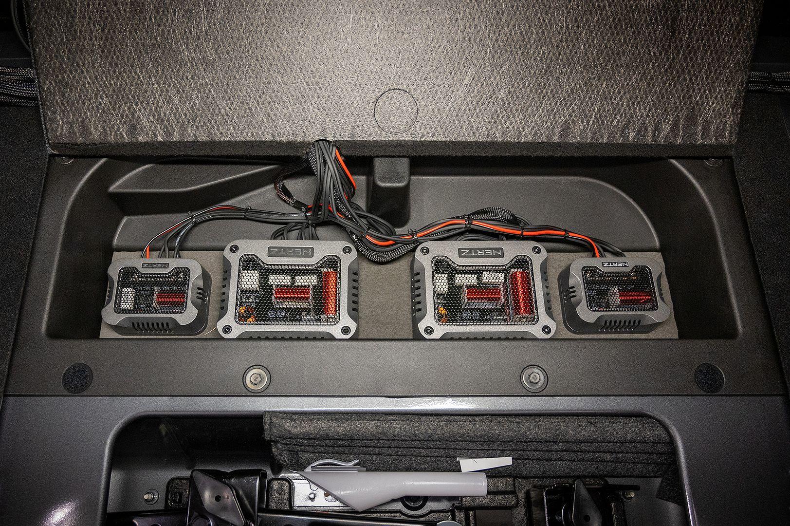

Are these the crossovers that came with the 28.3 tweeters and the 163.3 components?
