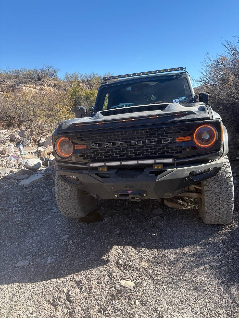

Show us a pic of the front of your Bronco...I've been packed to the gills with a RTT on top, driving uphill in Death Valley in 120deg temps with AC with no issues!
Not great flow to the upgraded IC maybe, but plenty to the radiator.
There’s your problem right there, your bumper is blocking your airway to the intercooler and rad!

And @RHeinz I hear you too; but though not ideal it’s not as bad as it looks, that bumper has more decent air passage to the intercooler and general ventilation not seen in that pic - especially at speed. And it’s a big intercooler with a good spec for heat rejection.
