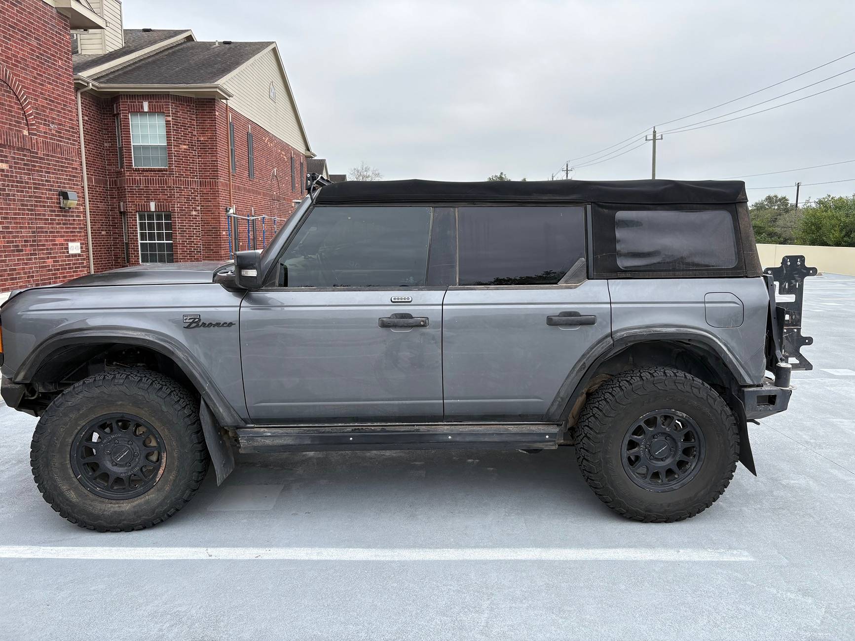

Fully empty today I weighed in on a CAT scale at 6060 lbs, and sit as pictured. Door sill GVWR is 6140 lbs., which I’ll be over with the spare and a passenger.
While I definitely overloaded it, I’ll always be overweight on a trip. Going to try the cooler thermostat anyway.
