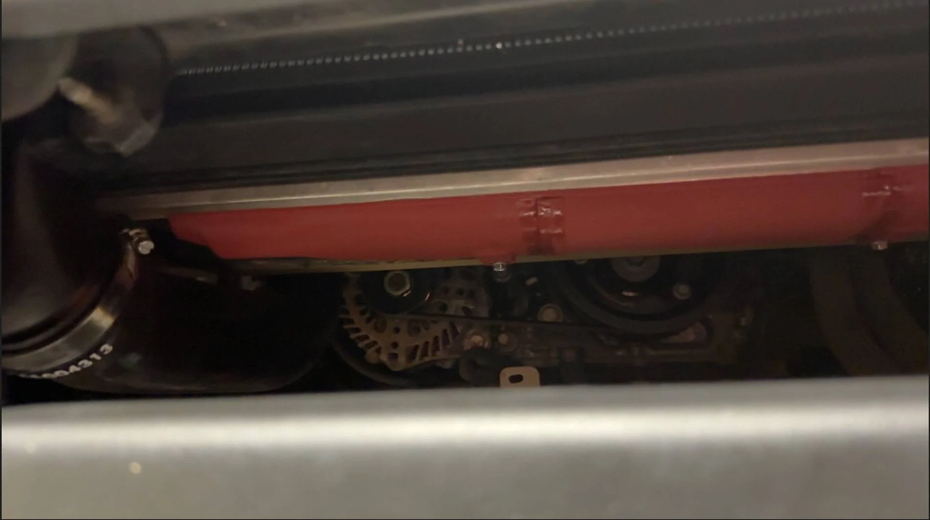

When you remove the stock intercooler you are left with this gaping hole that allows all of the air going through your radiator fans to bypass the radiator. image is from below, looking upwards. This means your radiator fans are effectivly doing nothing and will cause overheating.
Below is an image of the bolted in plastic blocker that I made to force the air to be pulled through the radiator. (Red Piece looking in the front grill opening)
Holy smoke you are right. I’ll do that this weekend.

Feel like the intercooler gets no air with the pic of that bumper. But I guess if it’s high oil temp, then that’s more radiator related? I’ve had overheating while datalogging but that was in the engine
Sorry, I need to take a better pic. There is air to the intercooler, and at 85 mph into a 30-40 mph head wind - this is West Texas we are talking about - there is plenty of air In and low back pressure underneath to release it. My inclination anyway is the radiator, as you mentioned and and @GreyZ did, particularly that the incoming air is finding a path of less resistance around It.
The truck is at the dealer through the weekend, so I will dig into that process next week. Easy fix, plus throw my cooler thermostat* in, and see how it goes.

Have you blocked the lower radiator shroud as suggested by @GreyZ ?
I swapped my intercooler as well but did block that part with a piece of polycarbonate as it didnt seem right to leave it open…
In oem config air still bypass the radiator but less so than fully open with aftermarket IC.
