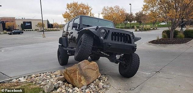

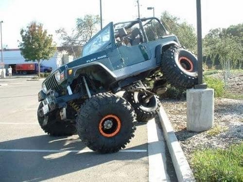

Toccoa
Jan 30, 2020
82
6,012
30,526
Isuzu Rodeo Sport
Ford Bronco How important is the stabilizer bar disconnect? 1612993868916
Ford Bronco How important is the stabilizer bar disconnect? 1612993917461
How else are you gonna park? 😁
