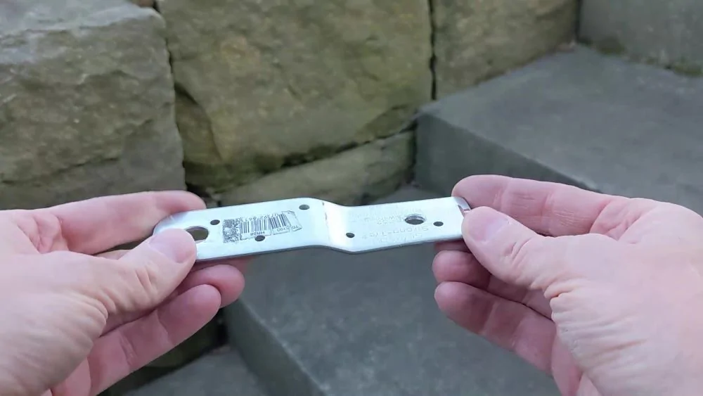

I took a steel strap I bought at Lowe's for $3 and bent it in to the shape below, and drilled mounting holes on each end:

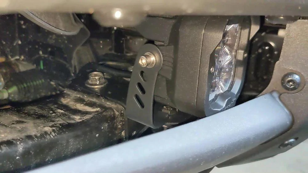

And then painted them and used that to mount the pod light to the outermost bolt that hold the front crash bar:
