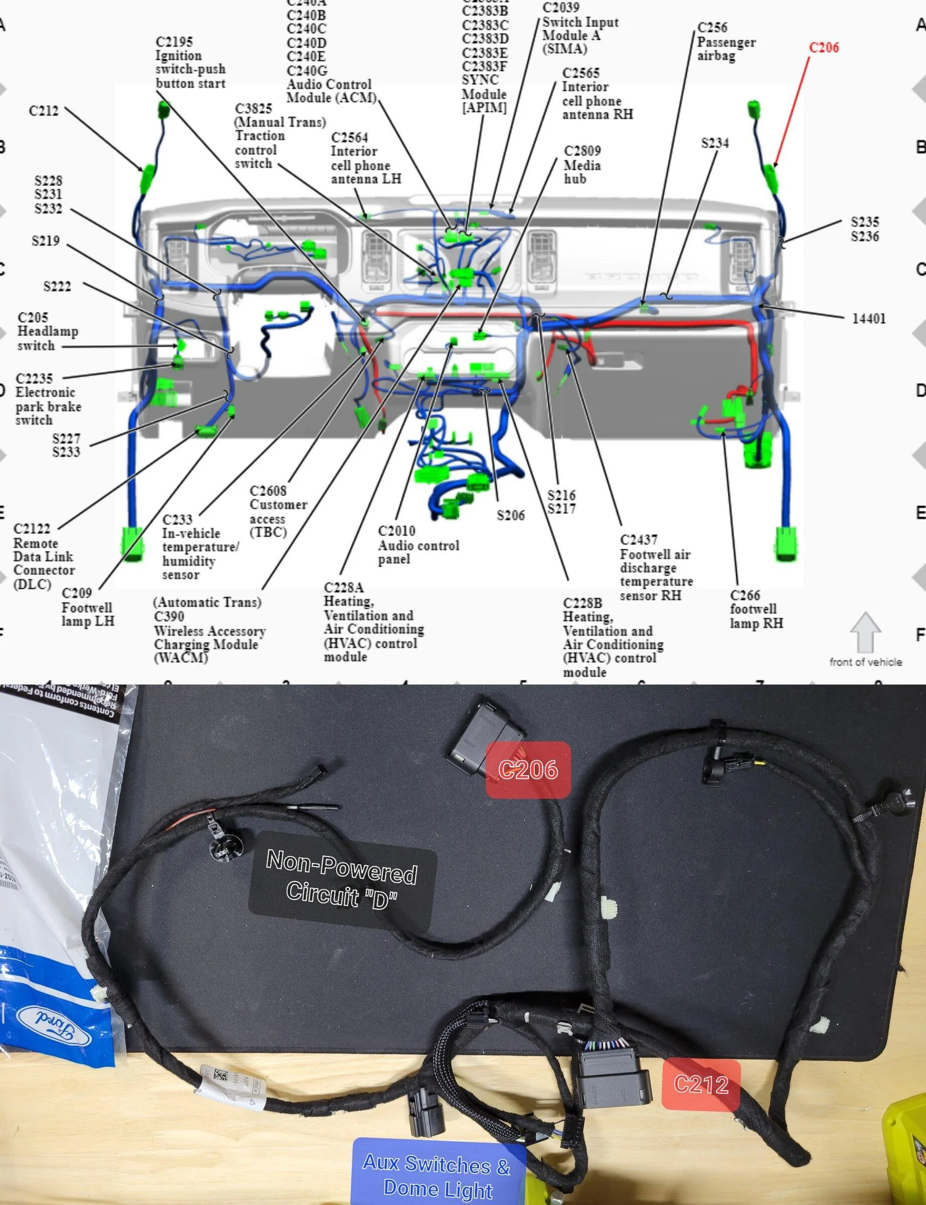

While reviewing the diagrams uploaded by @flip (THANK YOU) and comparing against the wire harness received, I may get lucky and not have to yank the dash apart to get to the BCM. I hope that the harness that I'm swapping out is all I need & no other harness swaps are necessary.
If there are any Ford Tech's on the thread, please feel to opine. These are just my suspicions based on the diagrams that have been shared thus far and my exercising of some of that old school common sense.

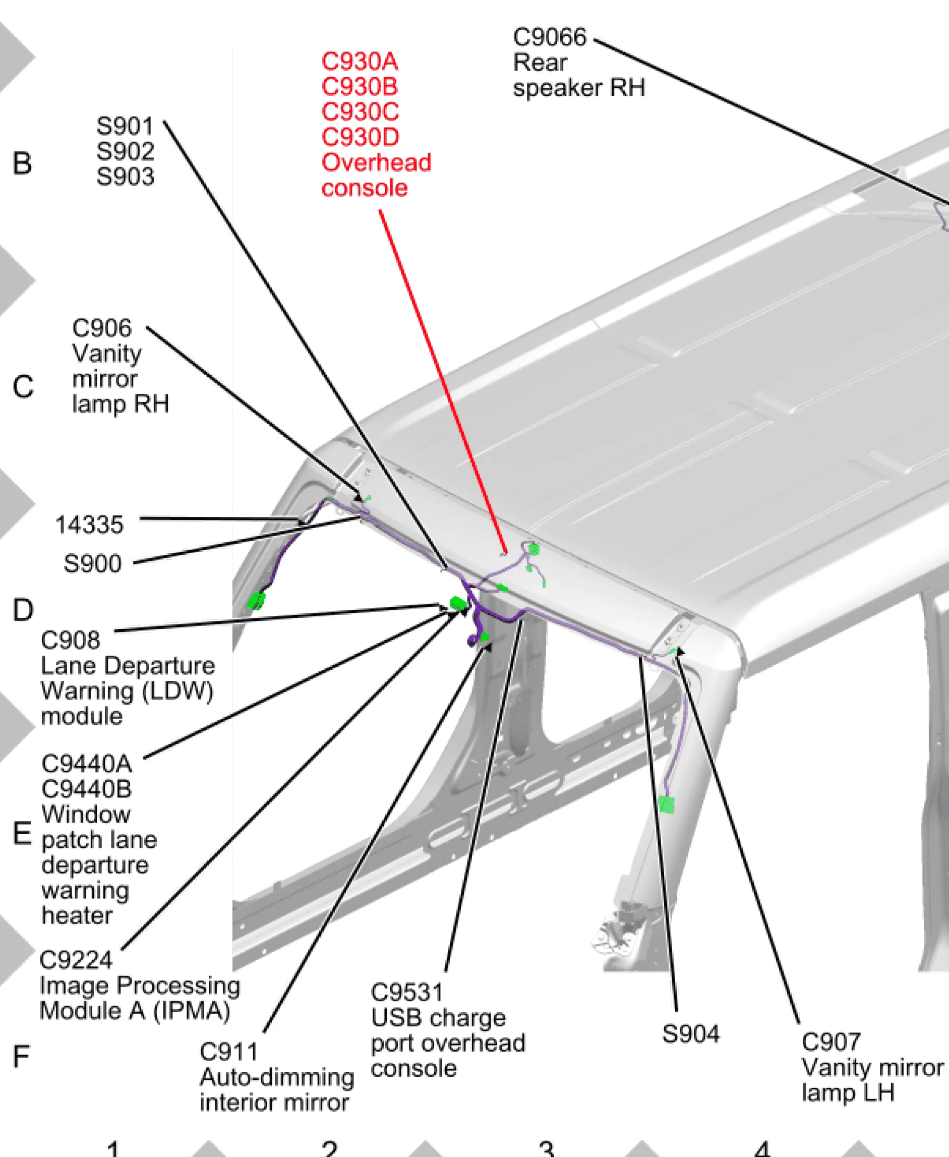

Further confirmation of the overhead harness connecting to C206 and C212.
So common sense would tell me, the wire harness needs to get swapped out and plugged into the locations of the driver and passenger A-pillars. What I don't know is whether the C206 and C212 hookups & their related harnesses also have the supporting wiring for the switches routed to the BCM & out under the hood. So if there are any Ford Techs out there who can confirm one way or another, that'd be awesome. Otherwise I'll be planning for a weekend of trial and error. šŸ™‚

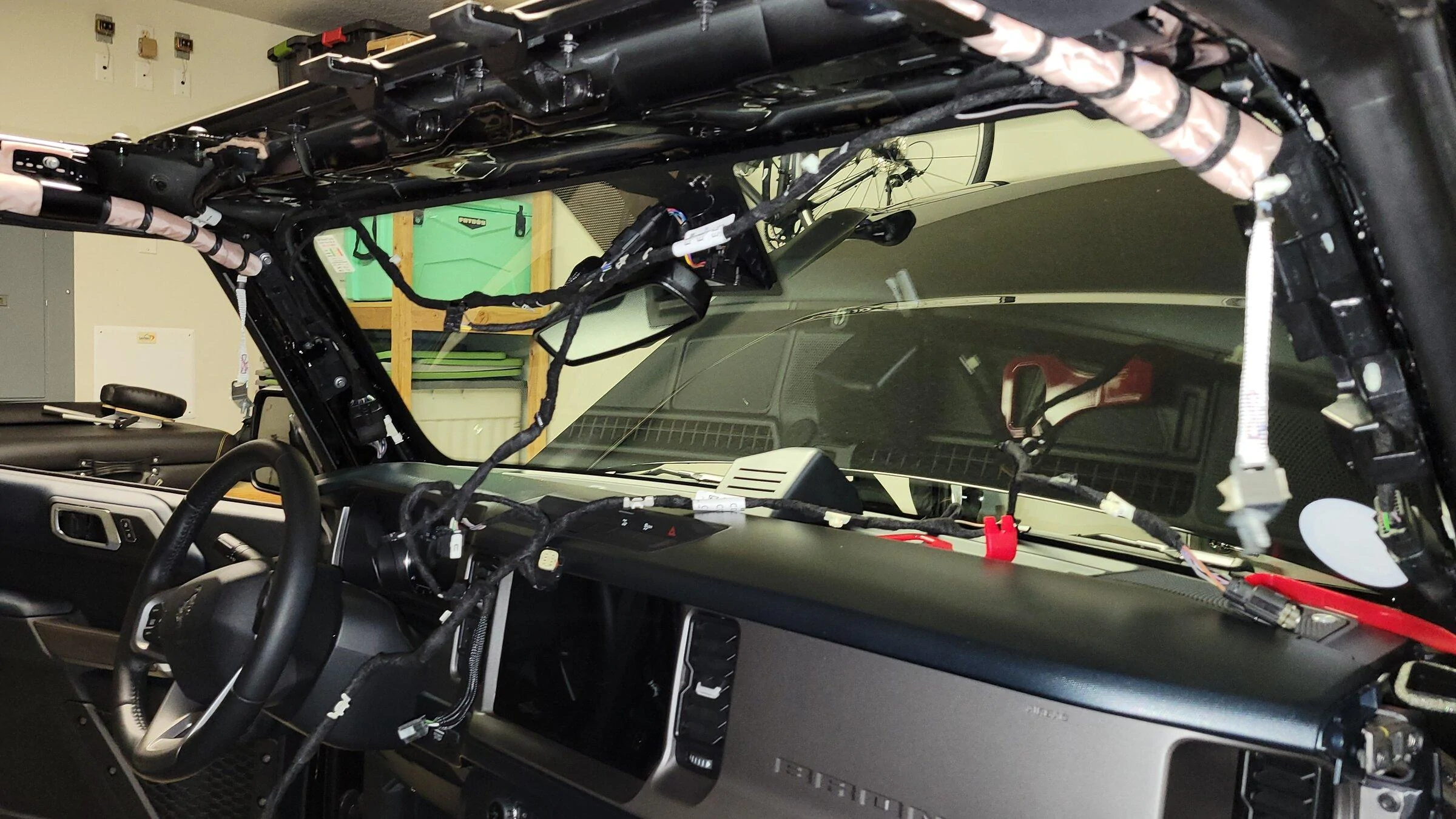

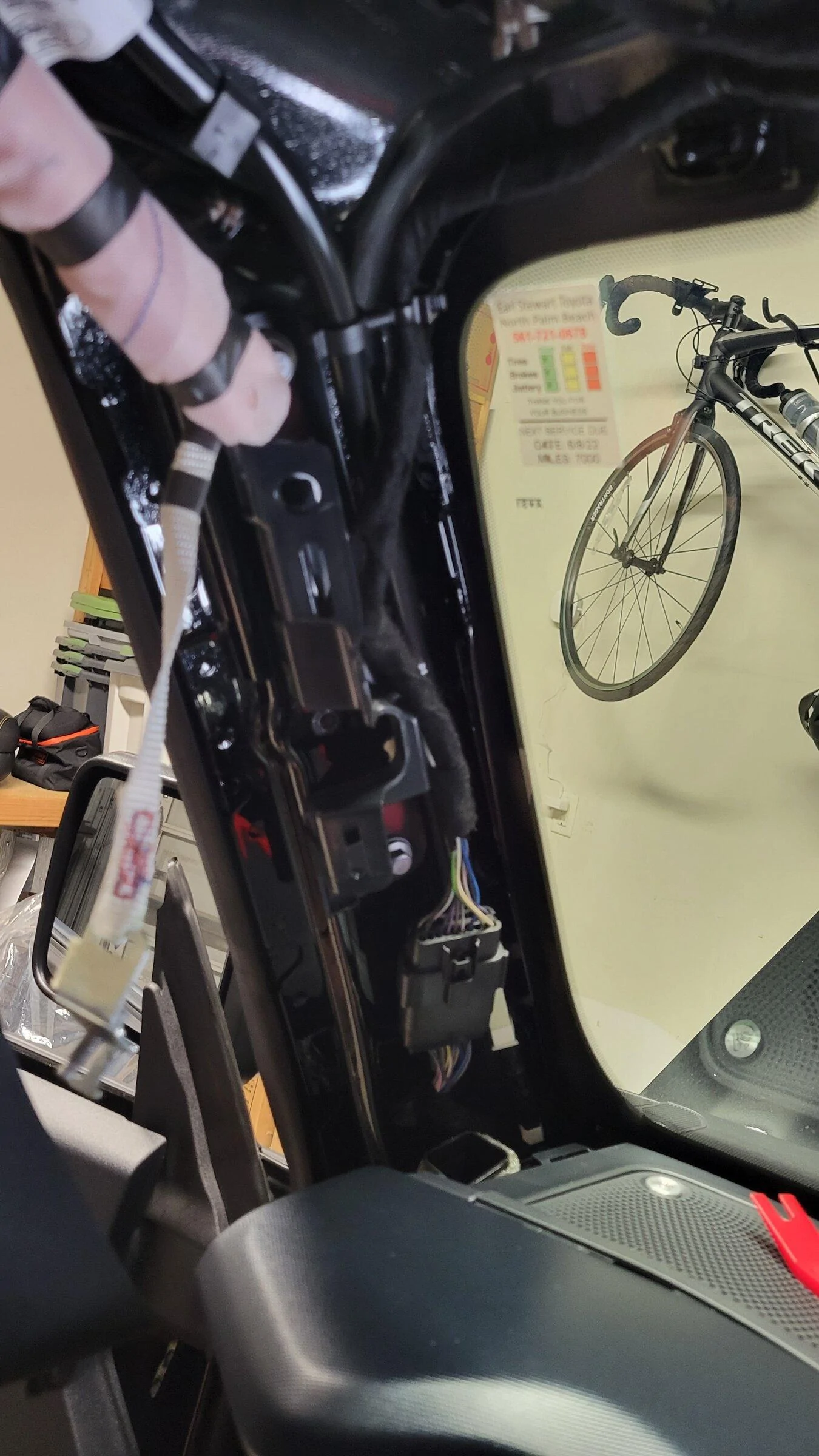

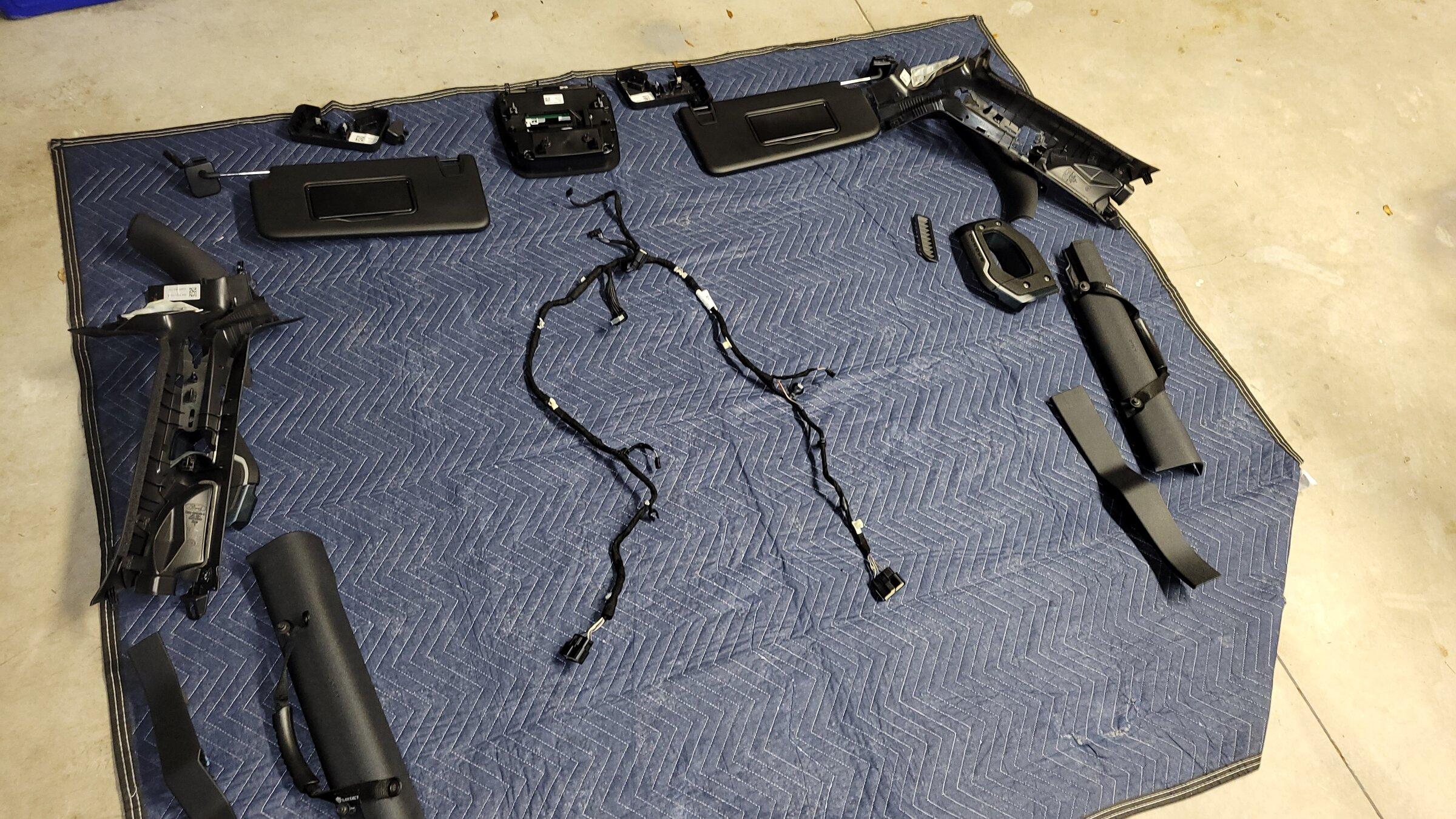

So good news. I started the project tonight & can confirm a couple things.
1. Wire harnesses are tucked behind the drivers and passenger side A-Pillar.
2. The harness coming up driver side, coming off the BCM to the A-Pillar connection was pre-pinned with the connections for the switches. The passenger side is also pinned to match the switch harness from the factory as well.
Putting the Bronco back together & should have a final answer for everyone tonight (God willing).
