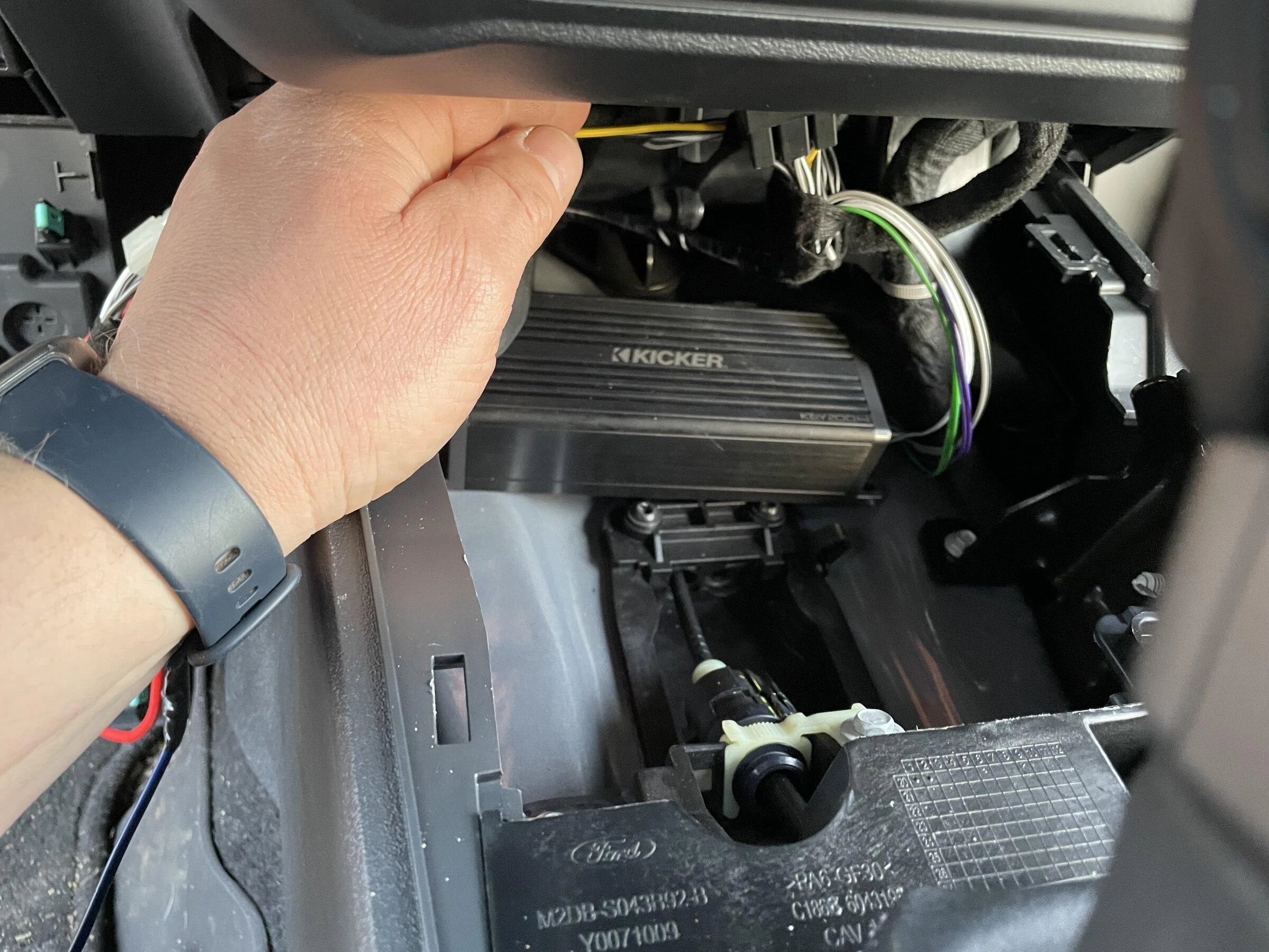

Hey all well got my son out with me today and replaced all the speakers to the reference 4032cfx, huge improvement with just them. Then got our wiring from plugnplay today and installed the kicker key. Ran out of time to install the subwoofer but it still sound a lot better and worth the $$ I believe.
I decided to install the key under the console area all the way forward. It fit nice. I do have to go back in and use some heavy duty Velcro as I do not want to drill into my floor. I have it duct taped down for a few days until I get time. I did use the boom mat pods these speakers already have capacitors on them and when I wired in the skar 300hz blockers I got no sound at all so there’s $20 wasted. In this picture it is just resting there but it ticks up even farther nicely

Really easy unbolt the handle then everything just has clips. The front little panel under the hvac controls has to come off first then gently start at the back of the console. I used a plastic trim tool but I guy could use old credit card to slide in the slot then pull up. You do have to unplug the goat mode connector. And release the four clips on the gear shift boot. Again a credit works well. There was a post on here somewhere that I followed.

So on top of the trans tunnel? Might be a decent amount of heat there. And heat isn't friendly to electronics.
