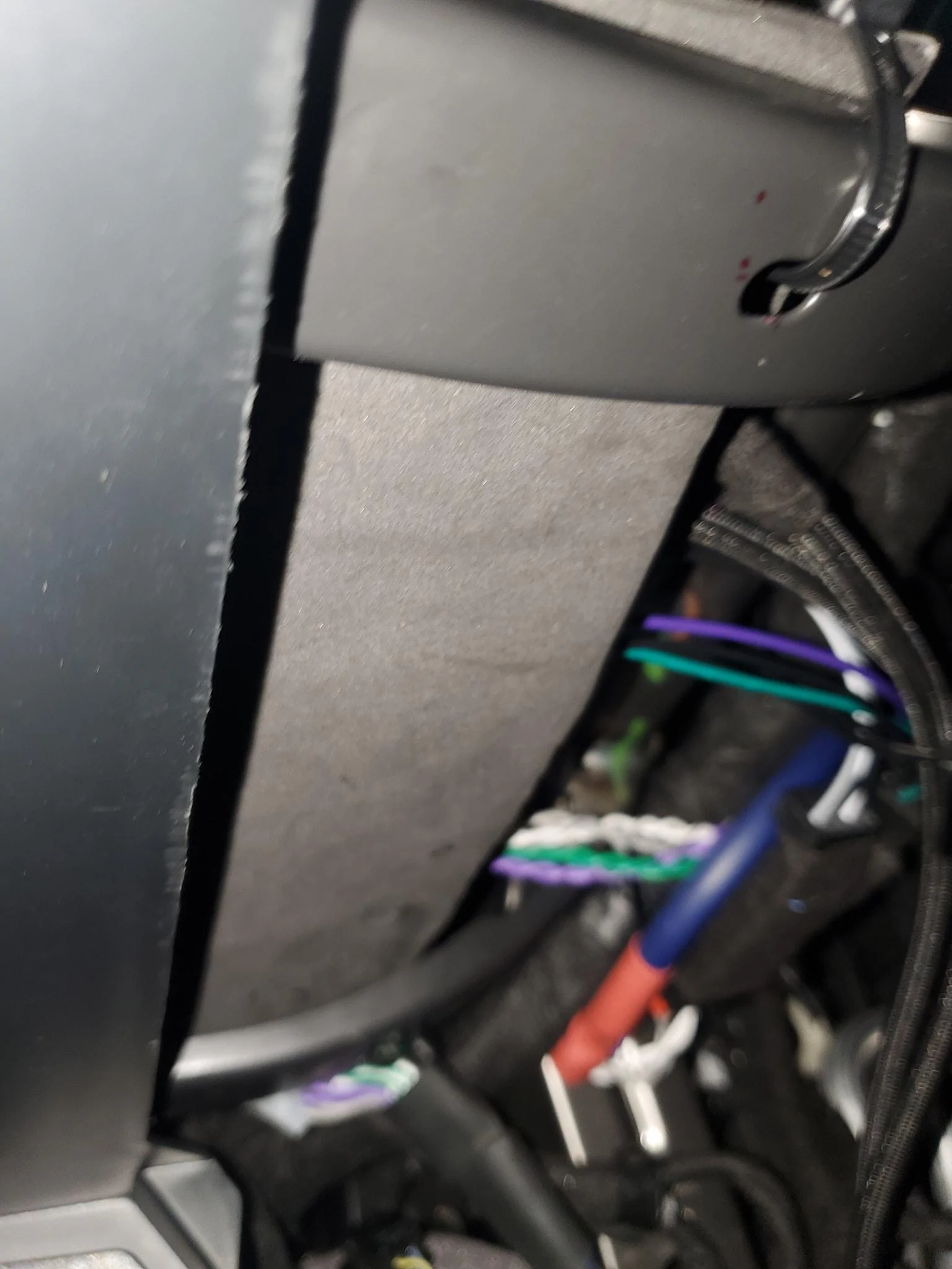

Terrible picture, so I apologize for that. I did mount my AudioControl ACM 4.300 on those curved brackets noted in your video. I affixed the amp to a scrap piece of acrylic with some velcro and glued some closed cell foam on the bottom to provide some cushion. I drilled two holes in the acrylic and used zipties to hold it to the braces. Works great, its hidden above the glove box and doesn't interfere with anything under there.

You're killing it with these vids. I installed my amp right under the stearing wheel behind the metal plate. Perfect place and easy to adjust when you need to.
Same! Fits so well there and easy to zip tie it on.
