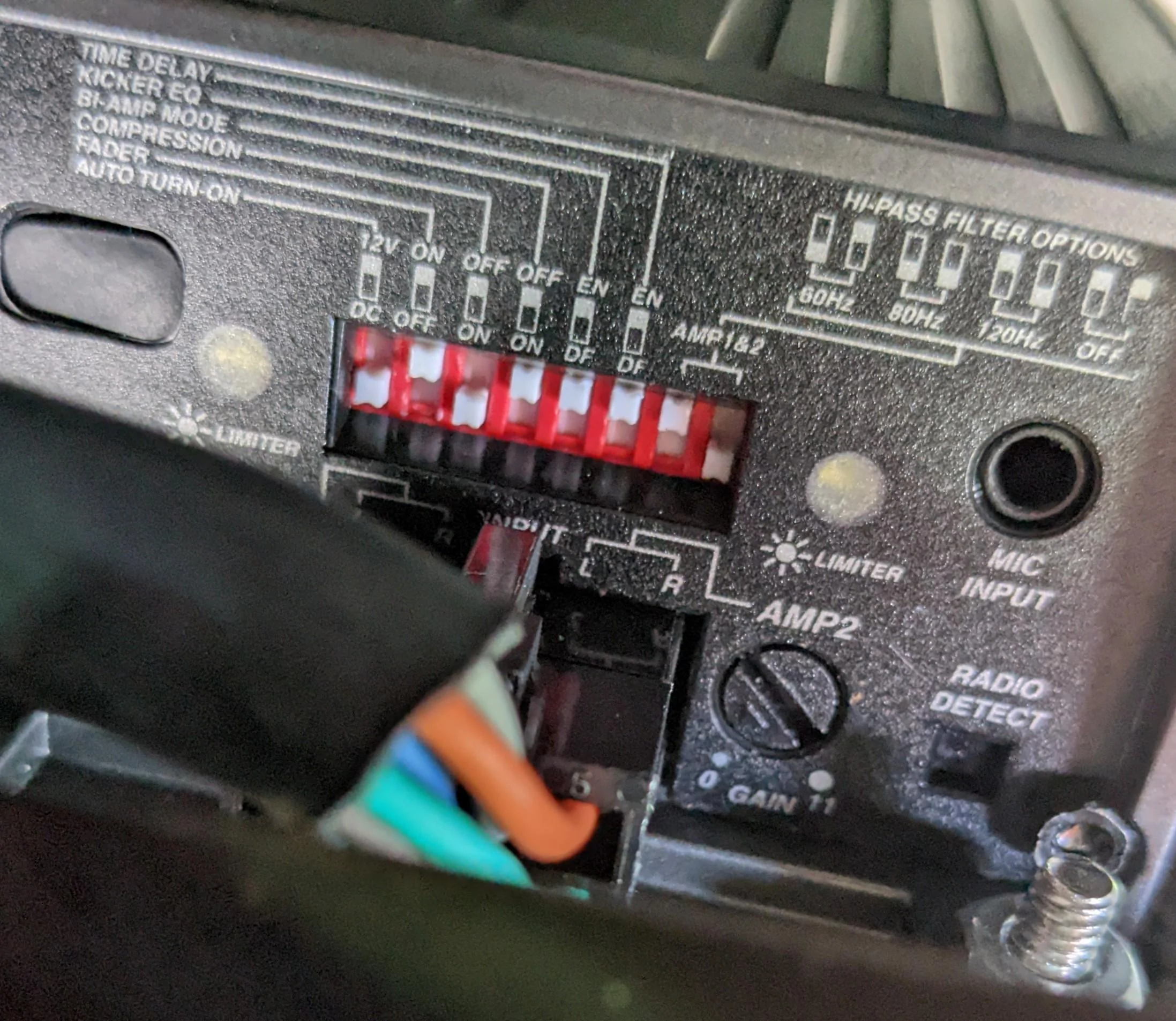

I did the Kicker Amp 200.4 install with the plugNplay harness. Install was nice and easy with that harness. I have the 7 speaker non-B&O stock setup.
Maybe I'm too picky, but it did not do much for the stock speaker sound in my opinion. Basically I lost all low end range/bass and sound adjustment. The mid/highs do sound a little clearer, better than stock, but you lose so much all around sound that I do not think it was worth it. I will say after re-doing the kicker mic setup routine for the amp a couple times, it got a little better. just my experience, but i expected more from all the other post i read.

There are not really many settings to that amp. I went off the recommendations here for the dip switch settings. Anything specific you're thinking of?

Dip switch pic settings is showing u have the 120 HZ filter set….somebody correct me if I’m wrong😑? That would explain why you don’t have any low end…..

Did you go through the DSP setup? It isn't going to make it an audiophile system but it is a huge improvement for a relatively small spend.
Yes i did the DSP setup multiple times, it did get a little better on the 3rd try.
I was planning to start replacing speakers next as you all mentioned with JL.

Also make sure you have "speed volume" turned off in your audio settings when you do the DSP setup...I forgot this and it really does make a difference!

Also check the "gain", my speakers (rear) were quiet until I started messing with that. But don't turn it up too much that will cause a crackling sound. I didn't read this entire thread, did you do any of the Forscan changes?

EQ on for me has abysmal sound, unlistenable (after successful auto EQ). However, with no EQ is completely transformed my stock system. I'd suggest to not just set no EQ (press mic button until 2 beeps) but rather clear the EQ (hold button for 10 sec until beep). Mine has unexpectedly auto reverted from no EQ to EQ.

A simple flip of the EQ dip switch is the correct way to disable the applied EQ settings following auto-tune. Using the mic to toggle reverts back to factory, reduces output, removes speaker time delay / alignment, etc.
