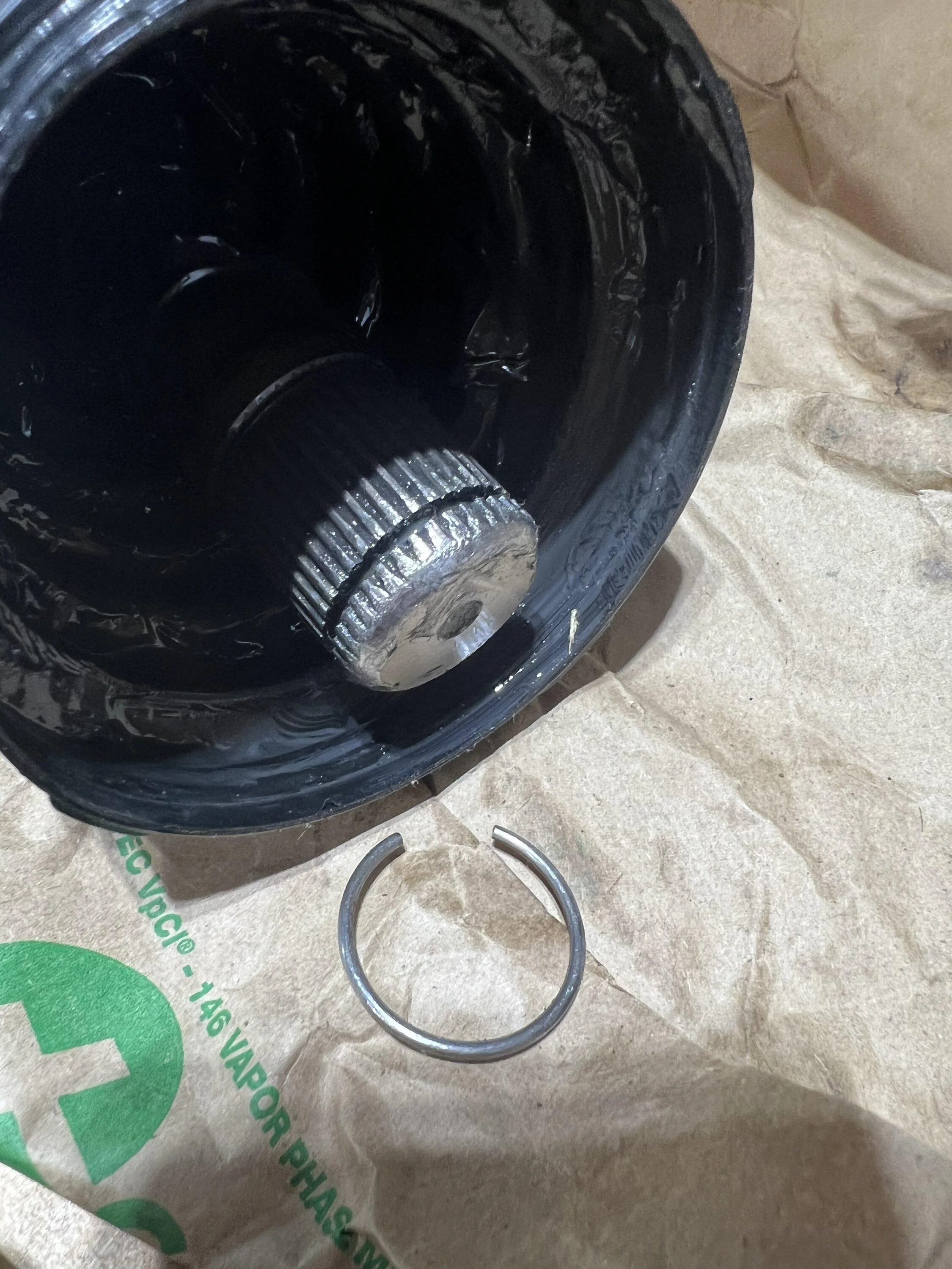

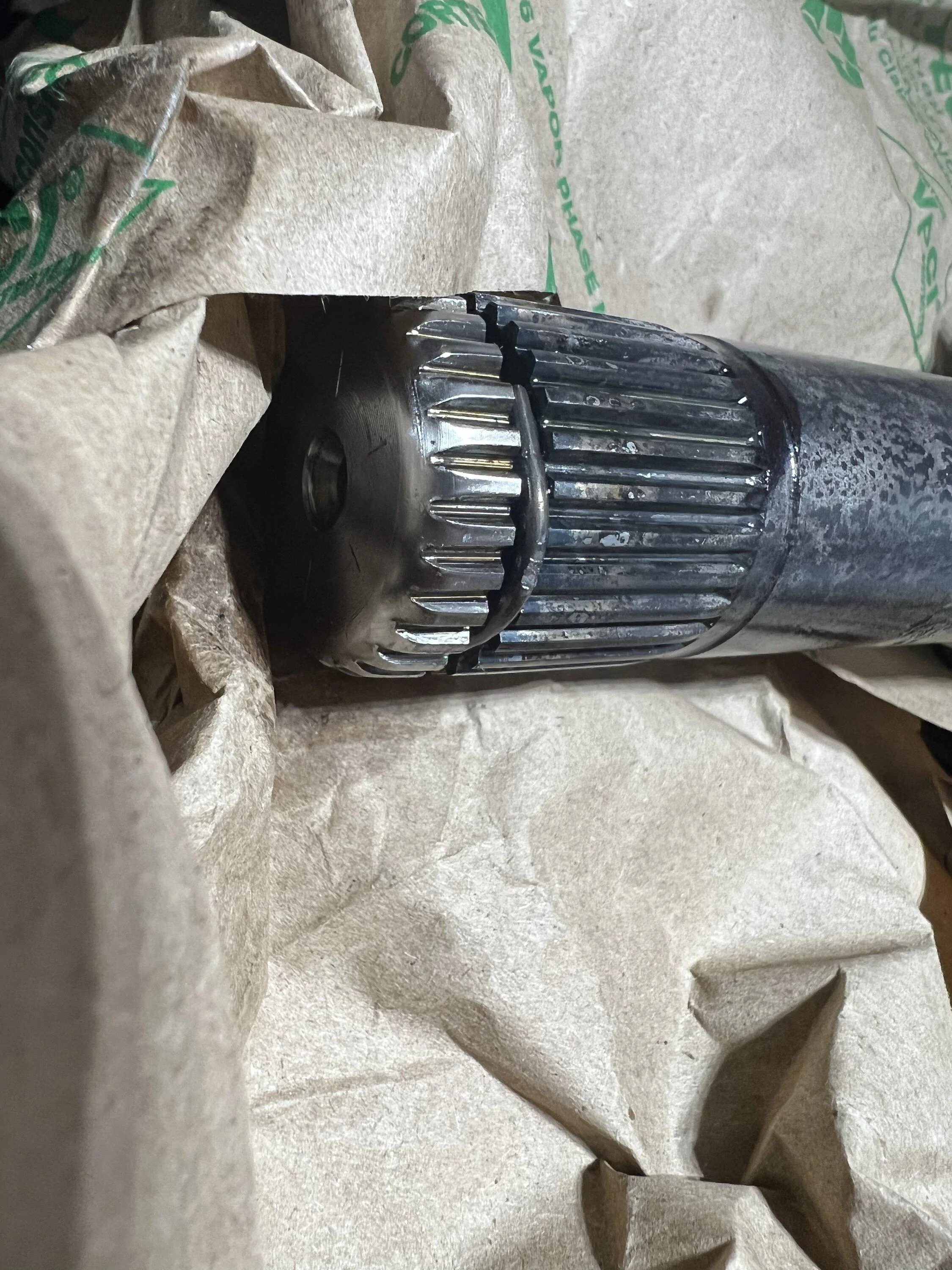

Do you have a pic of what you think failed? Maybe I missed it as I was looking at the PDFs and your pic. I already have odd (scary) sounds coming from the front end and haven't even installed my leveling kit yet.
see how the the clip in the first pic isn’t round and the second pic it’s round? First pic is inboard (not damaged) second pic is the outboard. I’m assuming when it was pressed together it wasn’t fully seated or the wrong clip was used. I’d suggest taking it to the dealer so you can get it warrantied. You won’t know it’s damaged unless you pull it apart. I’m saving the bad axle in case this becomes a recall. Probably won’t help but I’m a little salty over it so I’ll try
