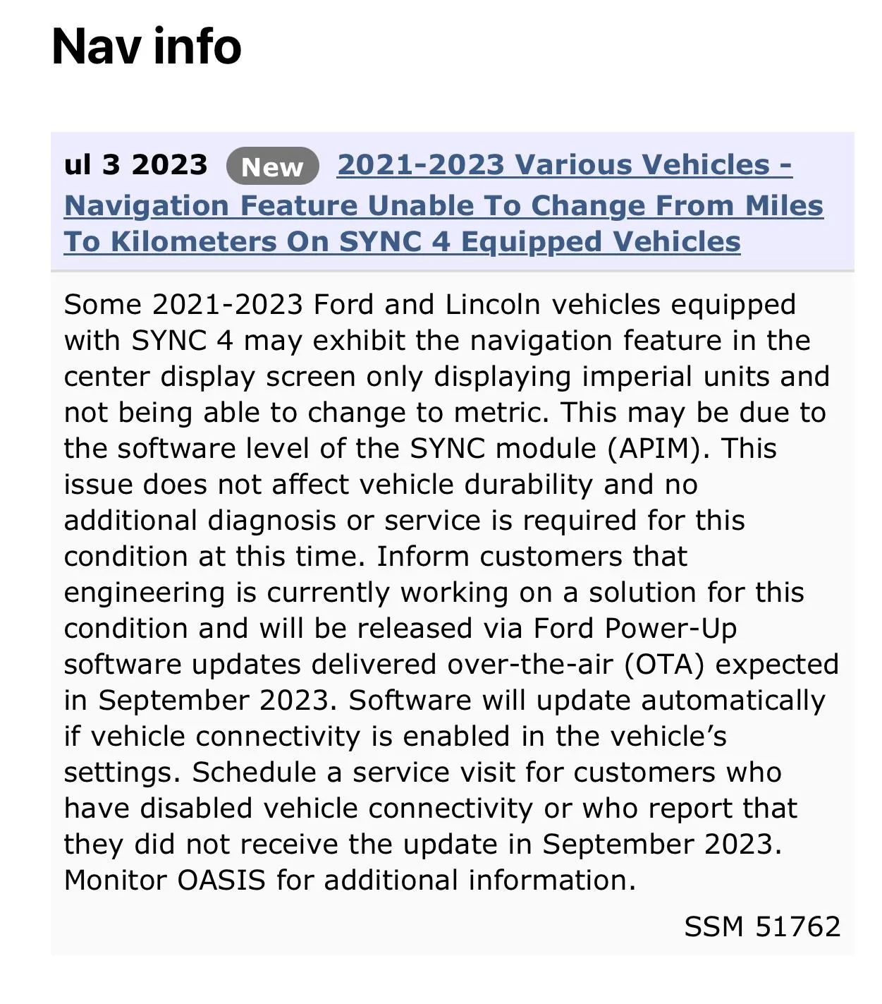

I have a 2022 badlands with lux package 12” screen and connected nav. In Canada When I am using the built in Nav for the life of me I cannot get the distance to turn and distance to destination to be in metric literally everything else in the vehicle is in metric but the nav will not give up on miles. This has persisted through multiple updates. At this point I mainly use CarPlay but I am wondering if I’m the only one with this issue?
Not the only one, I can assure you of that.
If you go into the settings and toggle to standard and then back to metric, it will revert to “normal units” as we expect to see… but it only lasts that Start cycle of the rig.

Thanks for the responses! I guess I need to wait patiently for that power update and until then be happy with American units of eagles per freedom.
