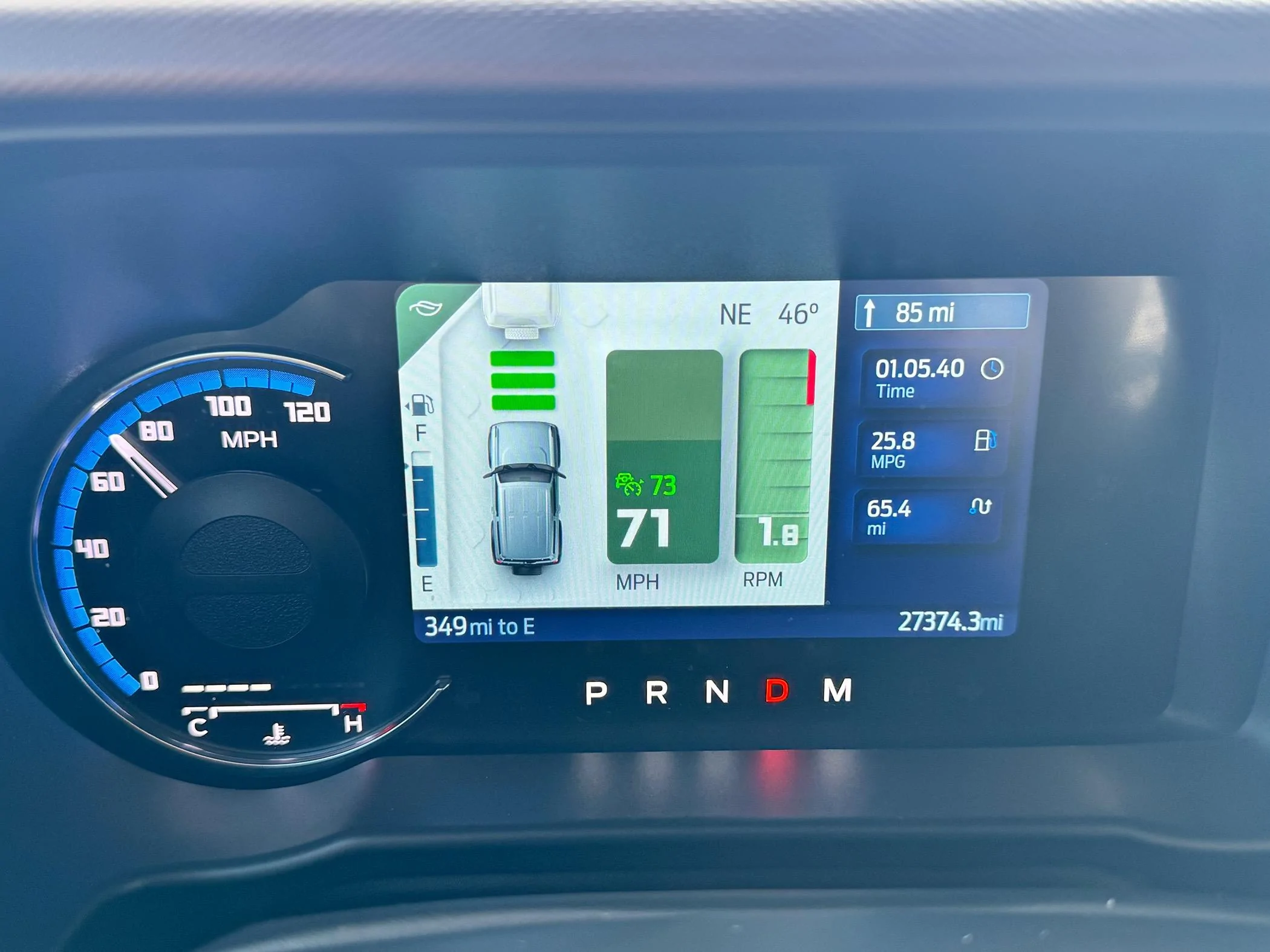

First the specs: 2021 OBX 4D 2.3L non SAS. 3.73 ratio auto Lux package with original 18" wheels & tires (Mall Mom version) with no drive train changes or off-roading equipment added (with these tires, seriously? Grin!) delivered in Nov 2021 w/28,000 +/- miles. I have only used Premium since delivery. Below is a dashboard screen shot from an early March trip from Newnan, GA to Greenville, SC. Virtually all interstate, rolling hills, no significant traffic slowdowns. This reading was taken at the beginning of the trip (about an hour in). I intentionally switched to Eco mode for this trip because I hadn't checked it on a trip recently. I typically use Eco mode only about 20-25% of the time when on the interstate and virtually 0% on surface streets. And I rarely use Sport mode.
This is the best MPG I've seen. I normally set the cruise 5 MPH over the limit and leave it. Yes, I know, the onboard computer lies. But even if it's 10% high I'm still getting over 22 MPG. My next few trips I'll calculate the MPG manually and compare.
Even for day-to-day driving (small town, many traffic lights on my usual routes, frequent stop and go traffic, etc.) I'm averaging 21.3 MPG. The worst I've gotten was low 18 MPG. I do not think about MPG while driving so I am not consciously trying to 'drive responsibly'. I have no hesitation putting my foot in it when the need (or desire) arises. What am I doing right? I have no idea, but I am seriously considering the wisdom of my original plan to replace the tires and wheels with something beefier when the current tires wear out! LOL!
