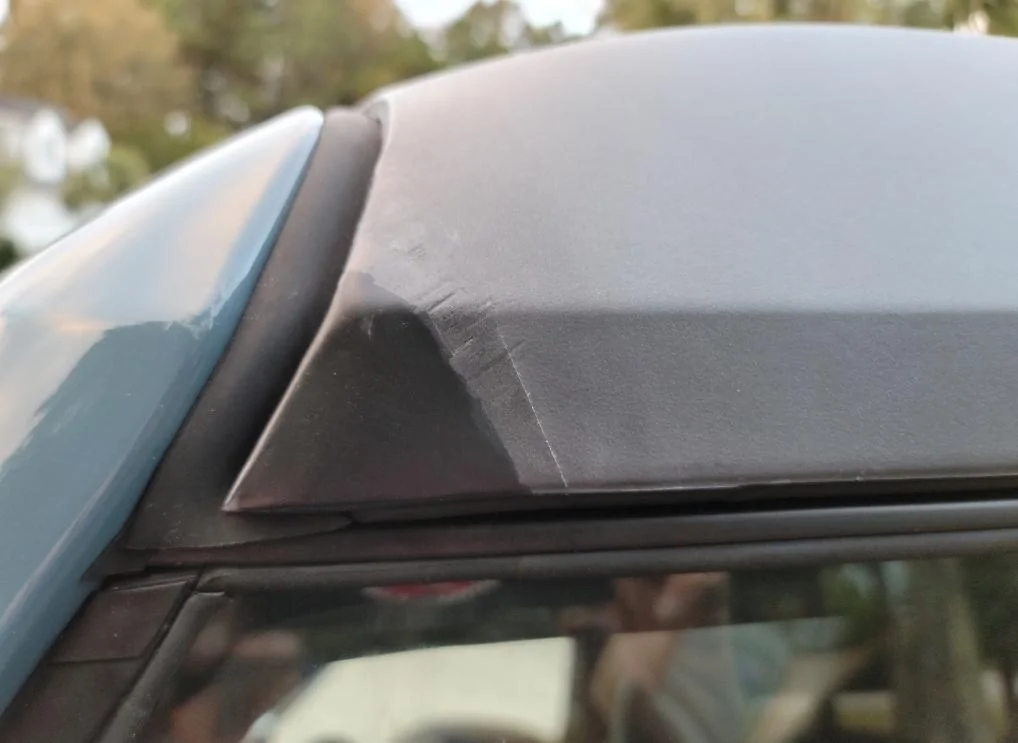

I can't believe Ford thinks these roofs are acceptable.
They should all be replaced, Ford's cost of course. I would suggest full fiberglass just like truck toppers are made or an all aluminum (which they should have done in the first place). From what I heard long ago, the test tops were all made in Webasto's Europe plant.....no issues. All these retail tops are made here. You would think it would not be that difficult to figure out what is going wrong with these. I have tagged FORD multiple times here on this issue....crickets.

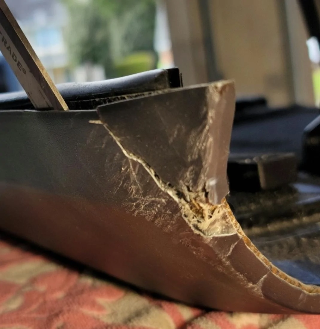

There is no gel coat on these tops. The exterior is the plastic sheet. But a delamination due to process seems like a good guess.
You’re right, poly urethane foam core probably not bonding to the poly plastic.. damn you Germany! Webasto is the company that makes them

Everything your dealer told you was false. Webasto still produces the MIC in greater Detroit. The location in Europe is where their R&D center is, that produced their first prototypes in a lab setting. Some of the early tops did come from there, but not for quite a while. And the tooling for the tops did in fact come from Wuhan, but not the tops.
I’ve been told the resin material comes from China. A little birdy told me a US resin company is trying to get their material qualified at Webasto due to “numerous quality issues with crappy Chinese product”. 🤞

I blew my driver's panel off the car in October 2021, becoming the inaugural member of the Bronco FRC. Mine tumbled down the highway at 50 mph. I was impressed at the strength. It is a heat fused laminate: plastic sheet, fiberglass cloth, resin, and in the thick areas, a resin-infused corrugated paper . . . Same as some aircraft construction. I repaired mine with epoxy and carbon powder for color, and its held up well. (I was a boat-building repair amateur for many years). Very strong and light construction. My opinion is that 99% of these tops work well and hold up. 1% have construction flaws that show, like the OPs rear cap. You note that the OP's other panels are fine. Below are pics of my panel before and after repair, when i forgot to latch it.
