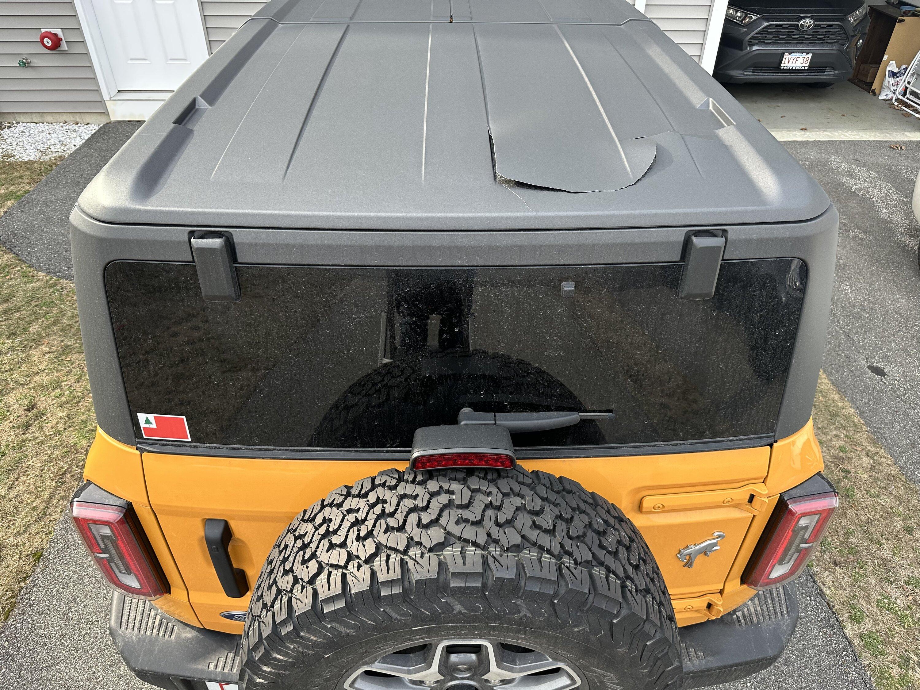

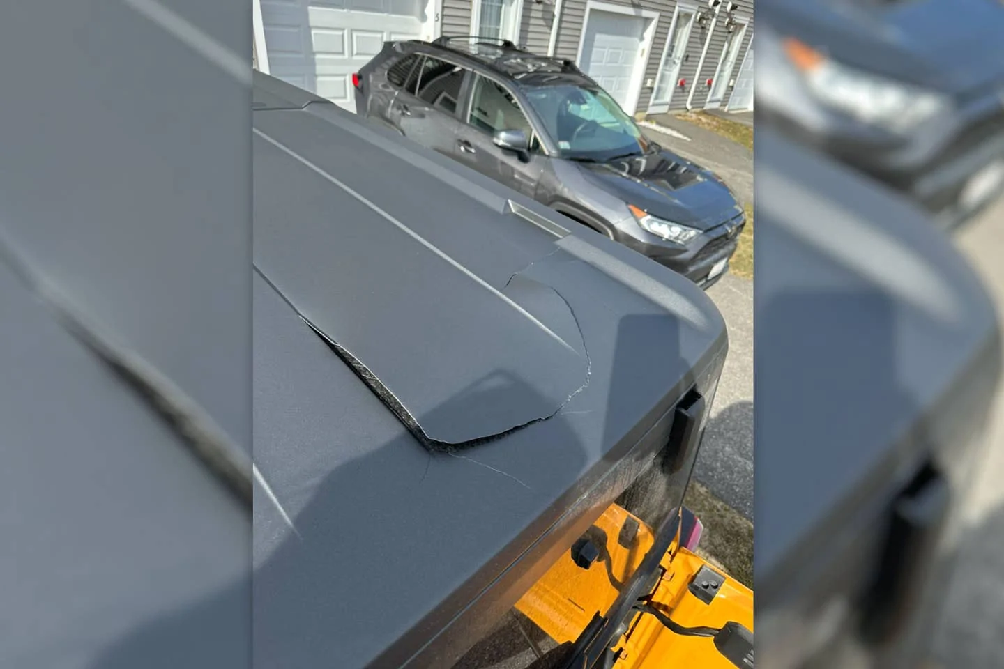

My 2021 2-Door Bronco's hardtop cracked in the cold this weekend. Posting for visibility and to see if others had the same issue. For context it was -11 degrees here (-28 with windchill) this weekend. Here is a link to an article about what happened to me: https://www.thedrive.com/news/ford-bronco-owner-says-sub-zero-temps-ruined-his-trucks-hardtop
The owner of the vehicle, who prefers to be identified only by his first name, Frankie, states he went outside to his truck on Sunday morning following the bitter temperatures on Friday and Saturday. That's when he noticed the damage to his two-door Badlands' roof. Like us, he's seen plastic Bronco tops with minor cracks online but not "anything this bad."
I reached out to Ford for comment, and a spokesperson responded: "We test to -40 degrees and have never seen this condition before. The customer should visit his local dealer so a replacement top can be ordered free of charge."
Frankie said his local dealer was initially hesitant to approve a warranty claim because they deemed it a cosmetic issue. However, Ford reached out to him directly saying they'll get involved if needed.
"I had someone from Ford’s SUV team call me and tell me that if it gets denied as a warranty claim to call her back and Ford may provide financial assistance, but she doesn’t foresee it being denied by the warranty department," Frankie added.
In the meantime, Frankie's first priority is to keep his roof dry. He says he took the truck to the dealer primarily to get it under a roof. He currently does not have access to covered parking, and he's clearly worried about what rain or snow might do to the top. "I have to leave it in my driveway, I have nowhere else to put it," he told me.
Updated: Frankie reached out as our story was published to say the dealer ordered a new roof for his Bronco. What’s more, they’re storing it for him and giving him a loaner until it’s road-ready.

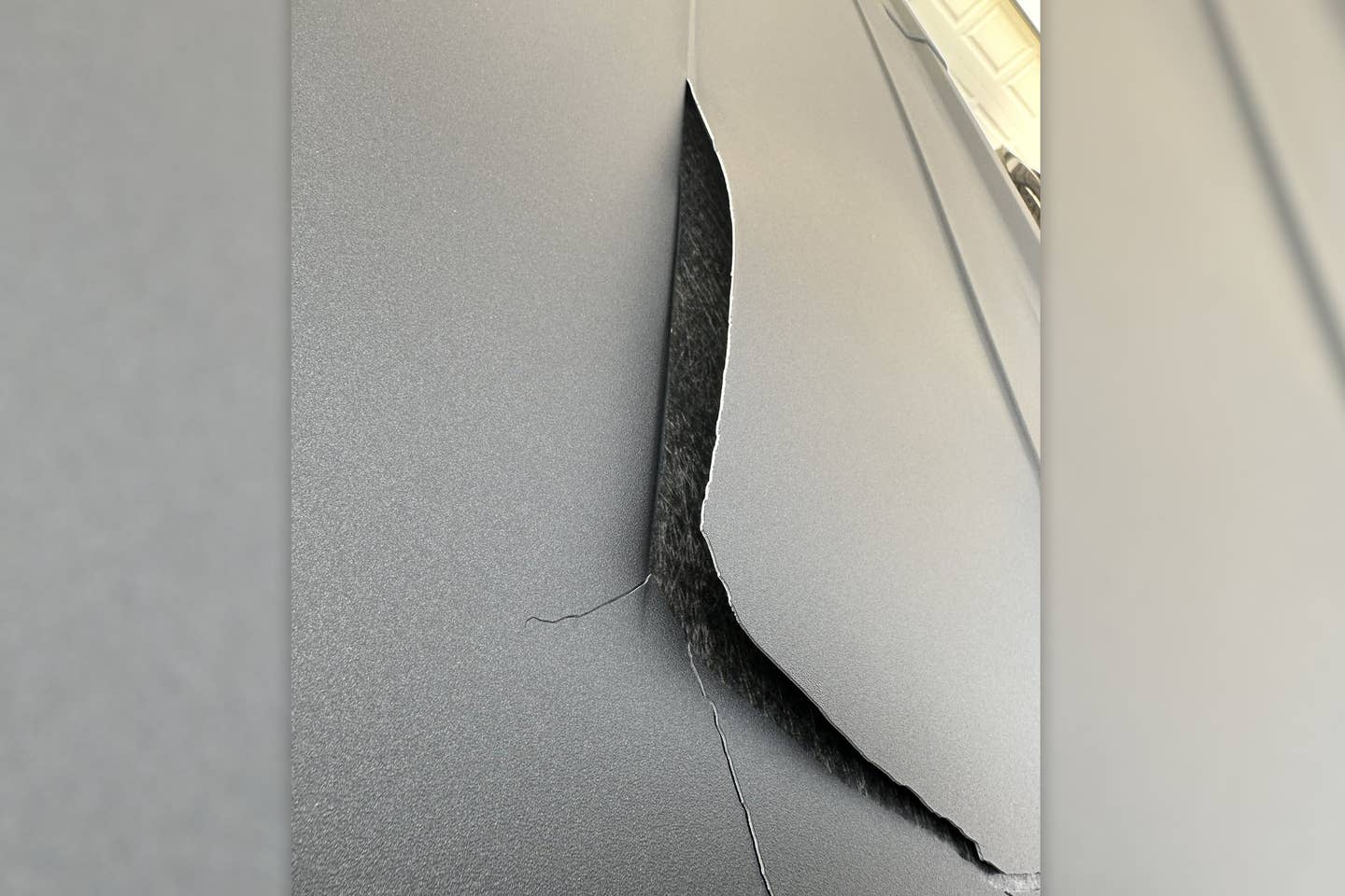

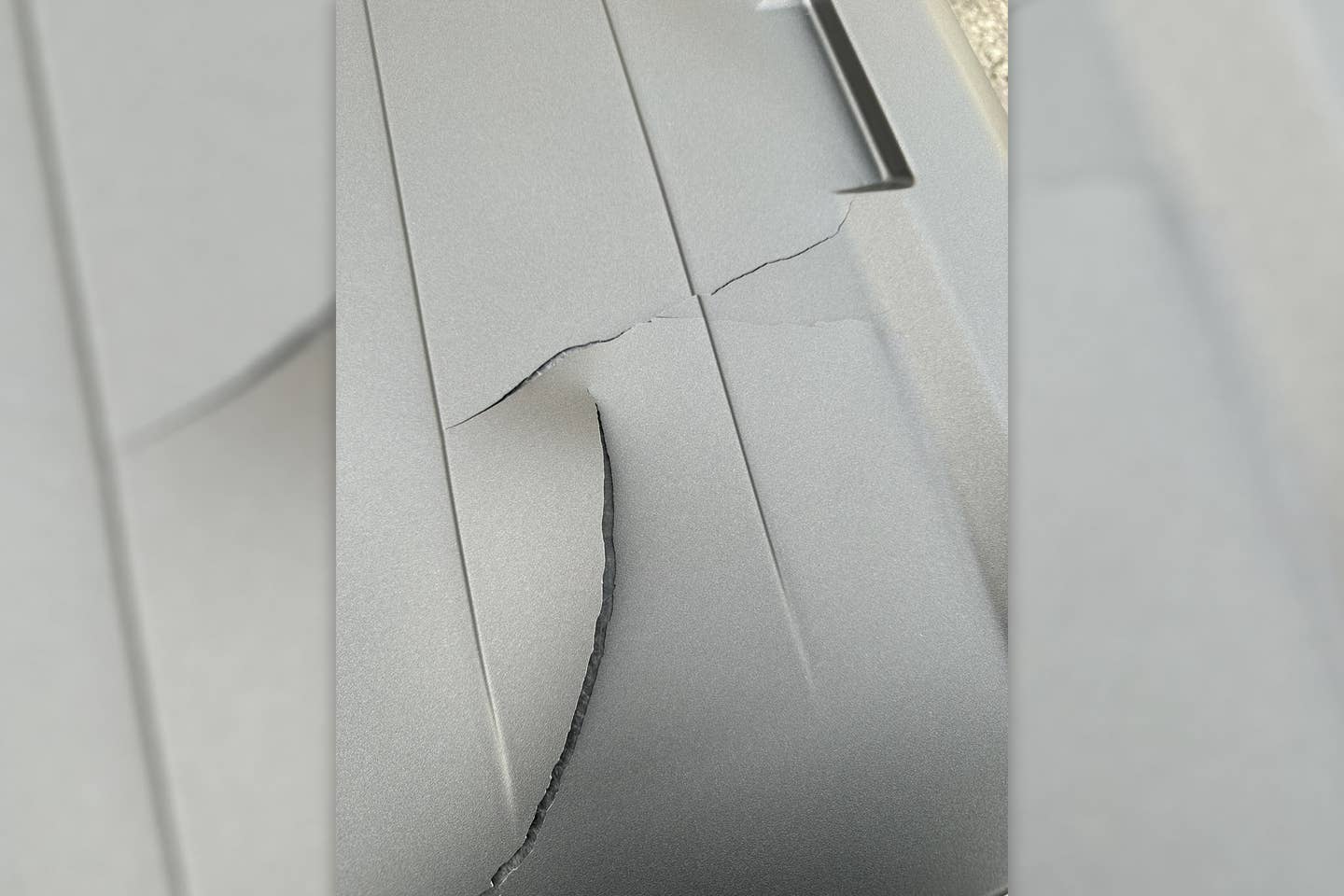

That’s not a crack that is a delam probably a flaw. Looks like they let the gel coating cure to long before applying the fabric
There is no gel coat on these tops. The exterior is the plastic sheet. But a delamination due to process seems like a good guess.
