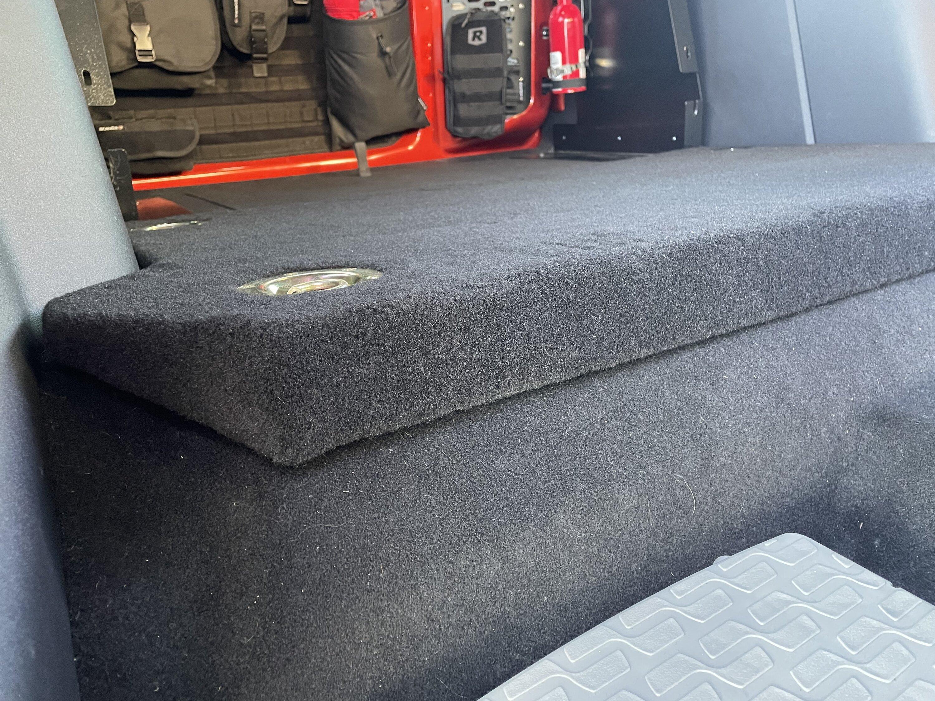

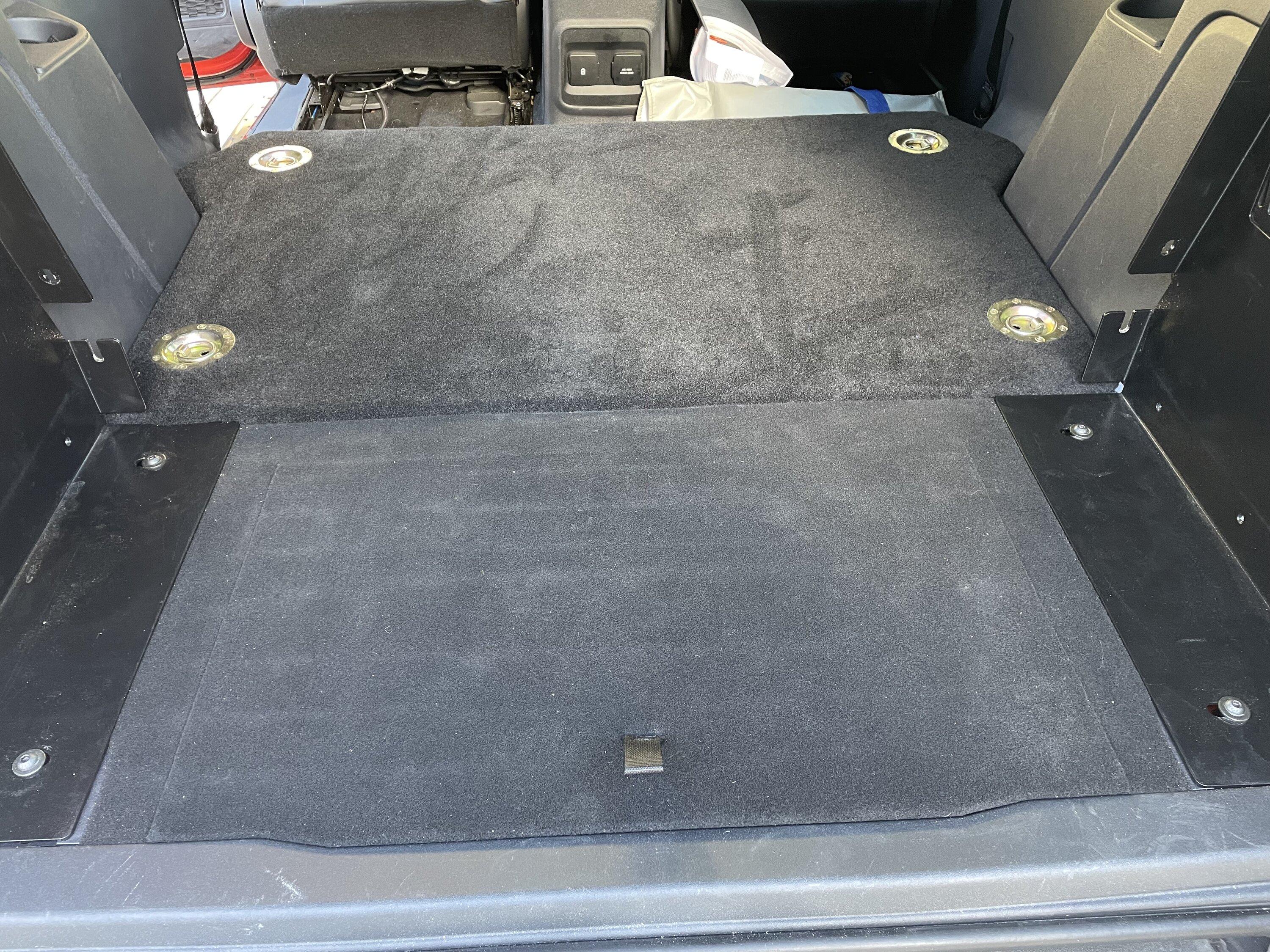

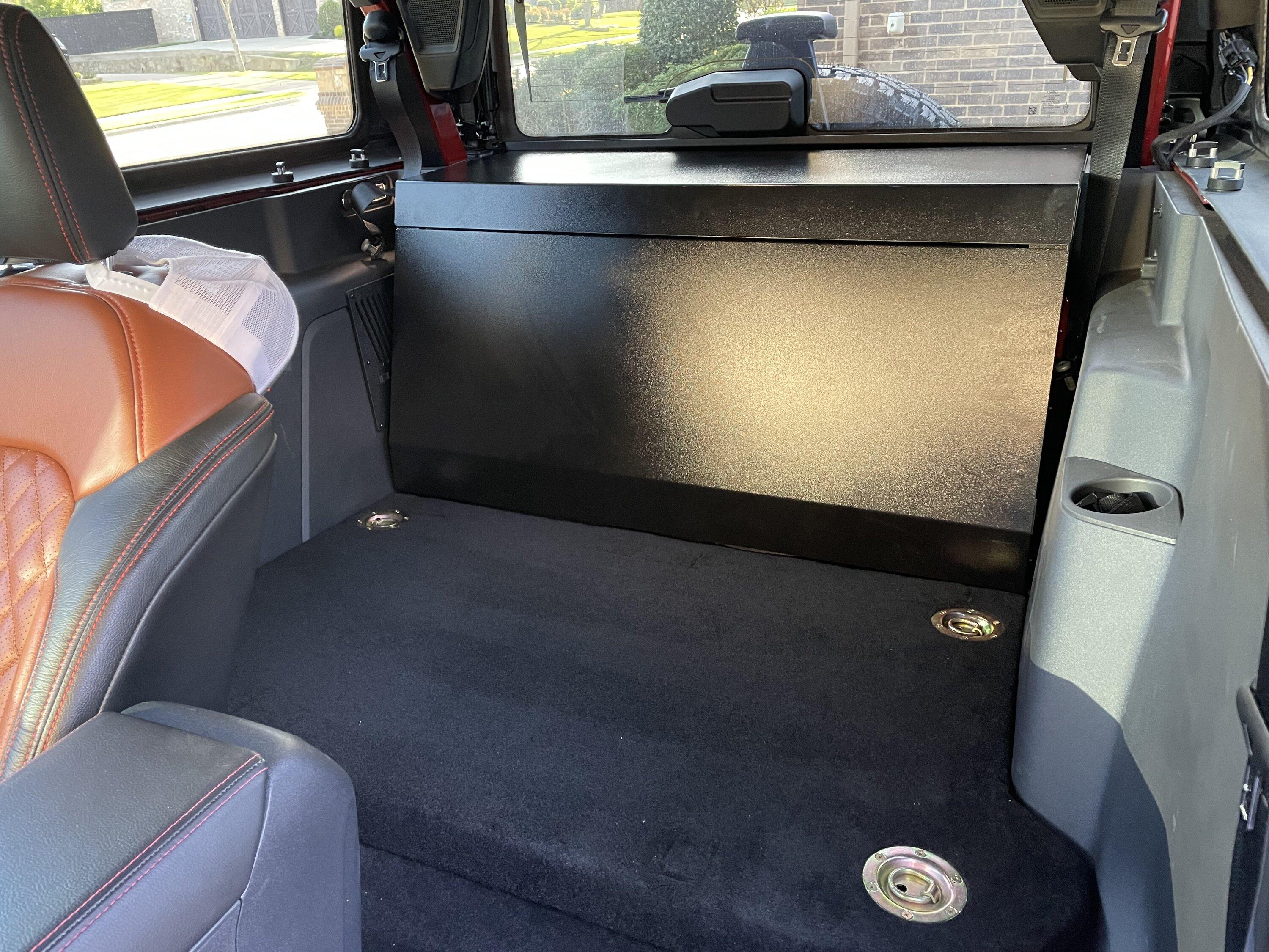

As much as I like the Goose Gear rear seat delete system, I was looking for something with carpet and that wouldn’t interfere with my Diabolical Inc Slipstream. I’m no professional woodworker but figured I’d tackle the project myself.

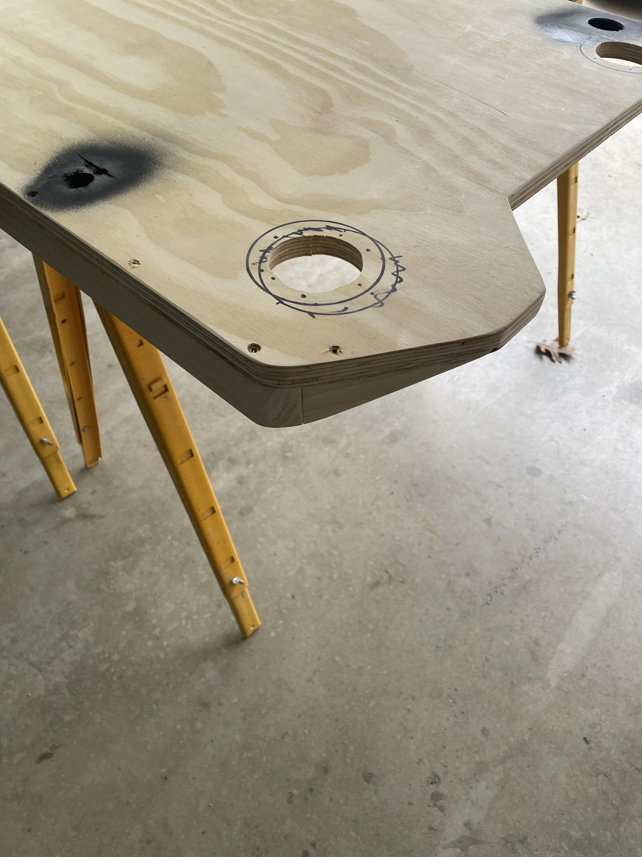

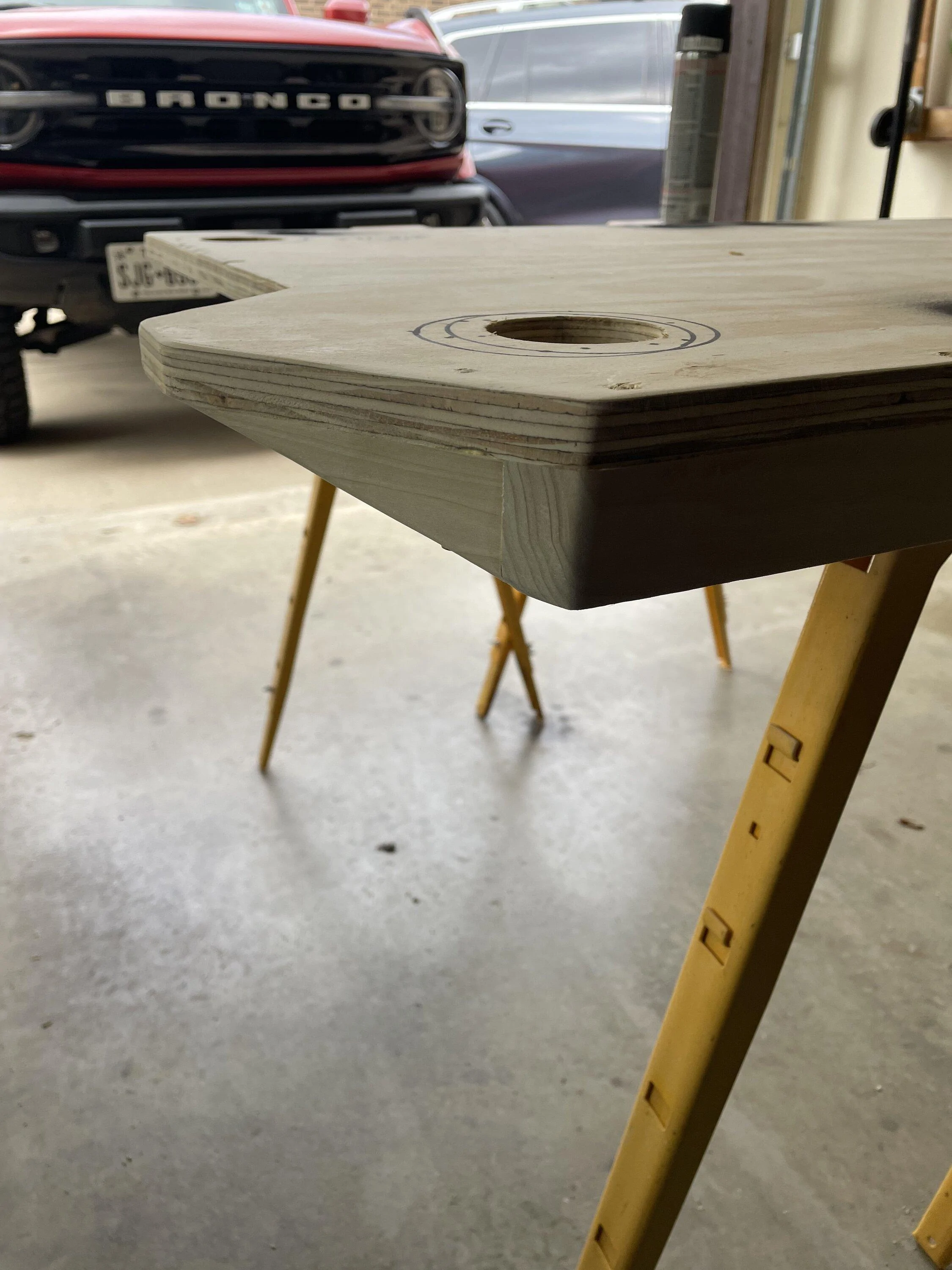

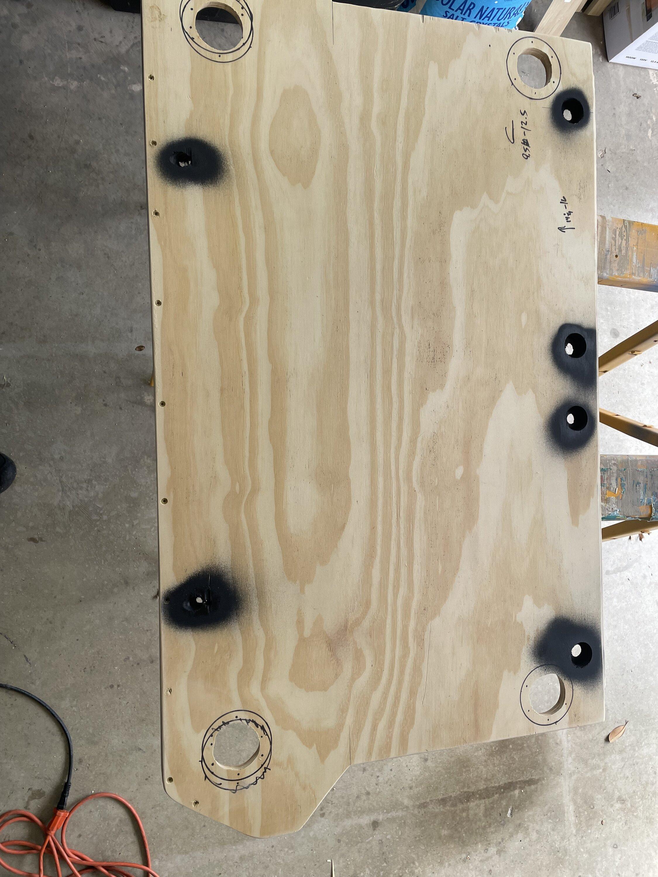

I picked up a 4’ x 4’ x 3/4” piece of plywood, a 1” x 2” x 6’ board to cover the gap at the front edge, some recessed tie downs and some unbacked automotive carpet.
I attached the board to the four rear seat studs and two of the four front threaded holes. I routed out the bottom of the board about 1/2” to clear the sockets the seat belt buckle cables plug into to keep weight from pressing on them. I also routed out where the seat belt studs are at the sides.
While the 3/4” plywood sits a little taller than the floor at the back, I cut a 45 degree bevel into the edge to help ease the transition between the two panels.
To access the bolts and nuts I cut flaps in the carpet and attached Velcro to the board around those spots to hold it down.

Whats that massive steel box in the back up against the tail gate

It’s the Diabolical Inc Slipstream. It basically creates a modular trunk behind the rear seats so you have a secure storage area especially handy when the truck is locked with the top off.
