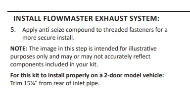

Forgive me if this question was asked already but I’m assuming the cat back for a 4door will not fit a 2door correct? That outlaw high clearance cat back is calling my name but I don’t see an option for a 2 door on your site. Thanks in advance for the clarification!
ya gotta trim 15 3/4" from the rear of the inlet piece to fit the 2-door.
