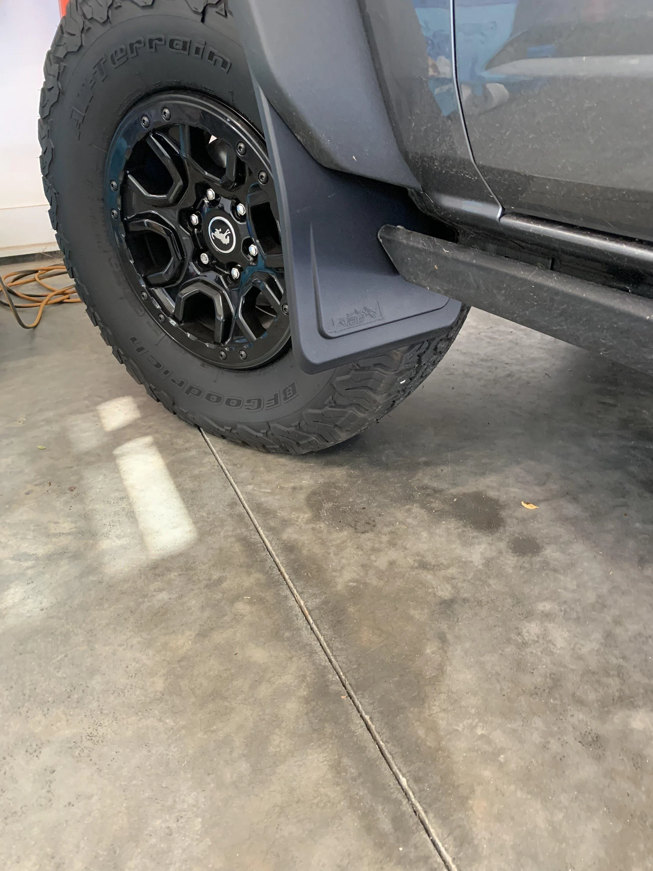

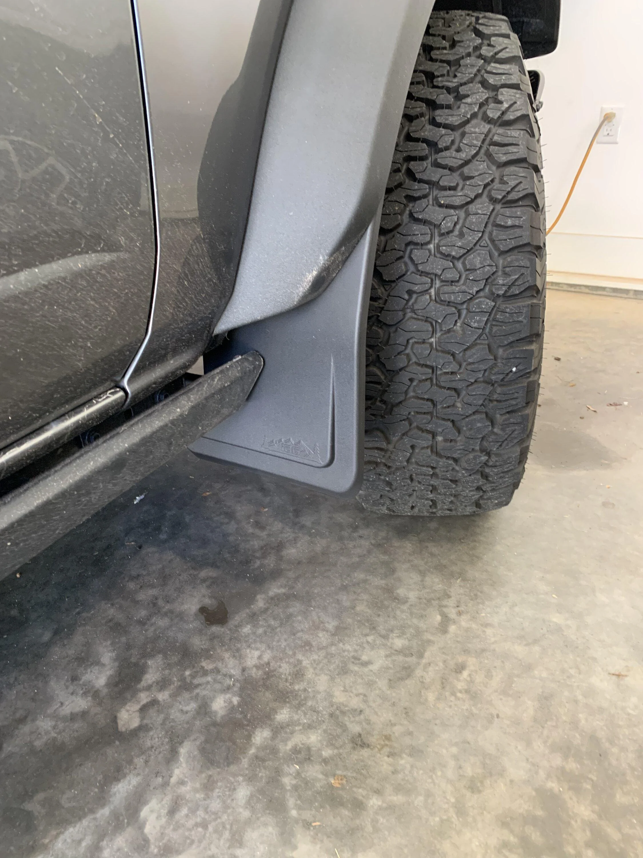

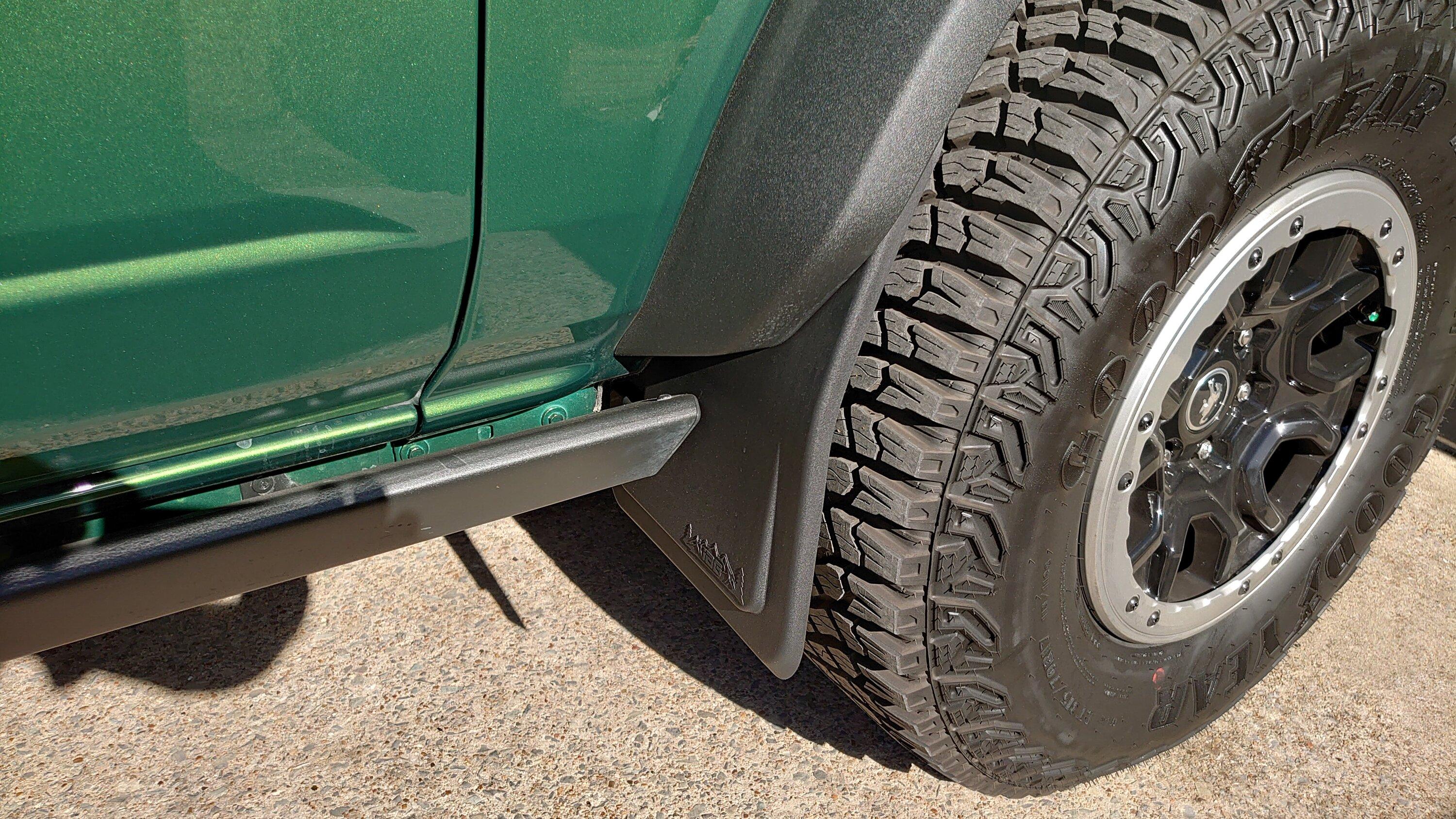

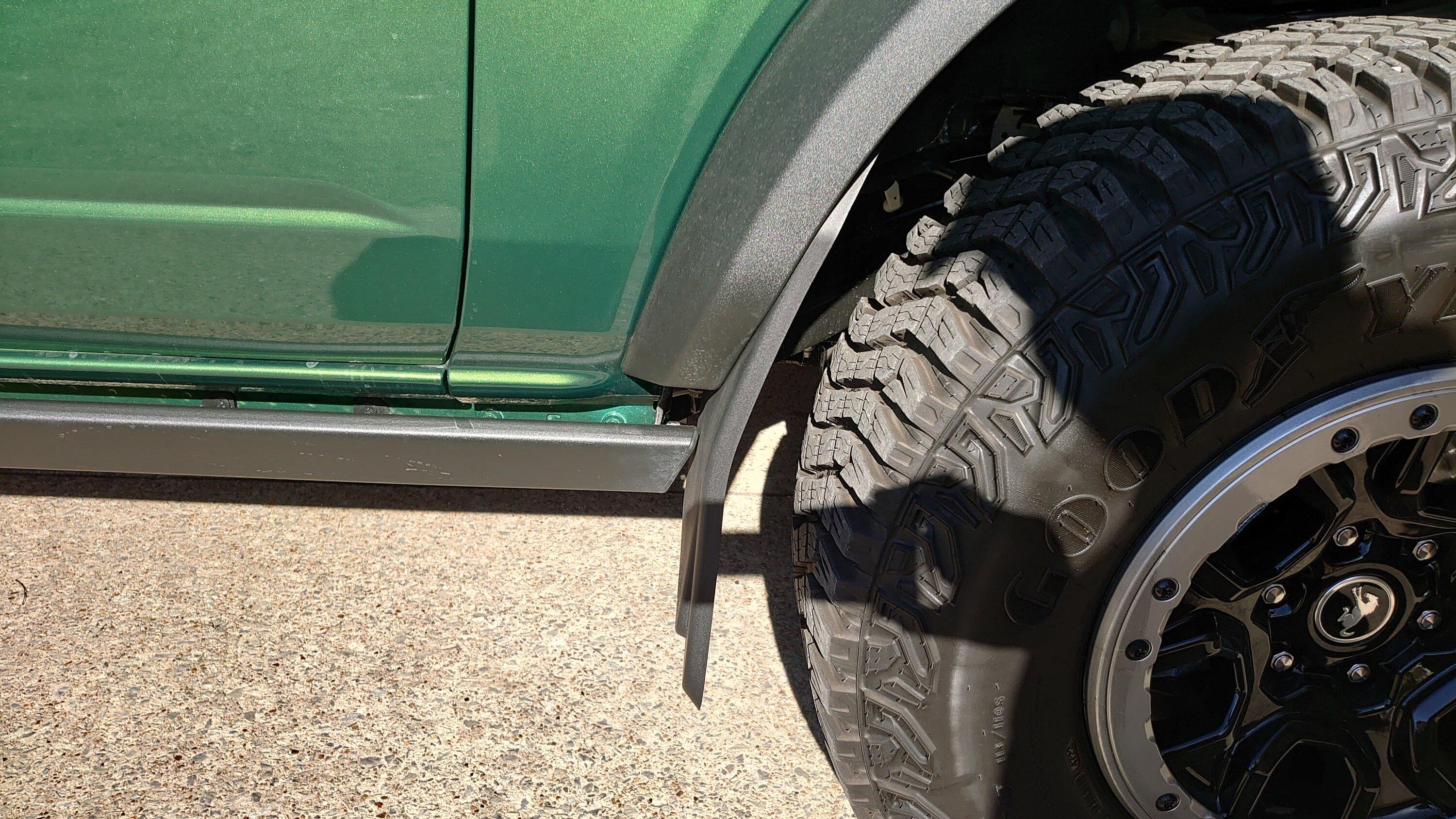

Got mine (fronts) installed today. Looks great! Not a hard install. Something always gives a little trouble (clip not wanting to come out) but overall a problem free install. I had put Gatorbacks on my previously owned Badlands but I actually like the look of these more- and they were WAY less expensive.

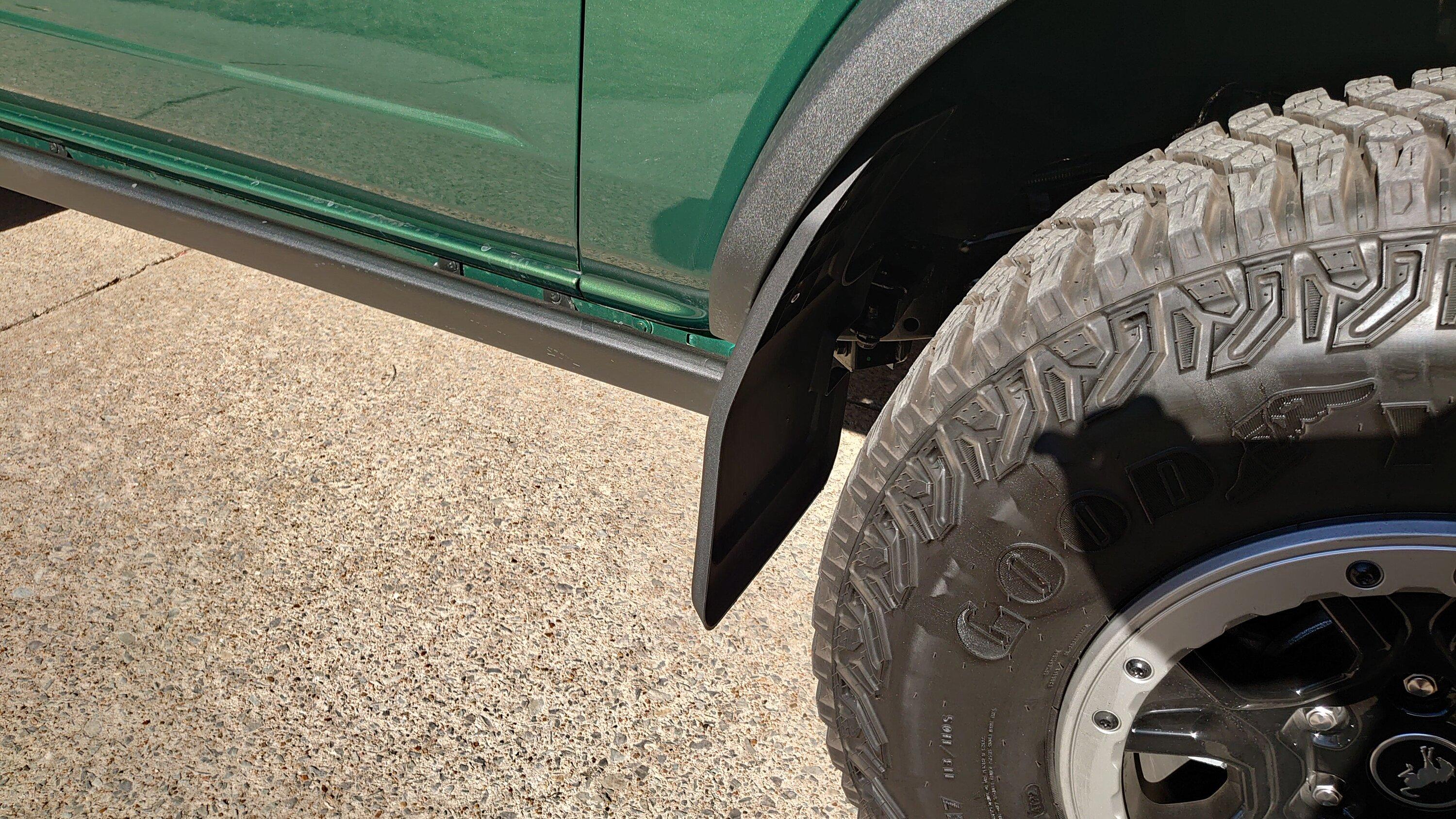

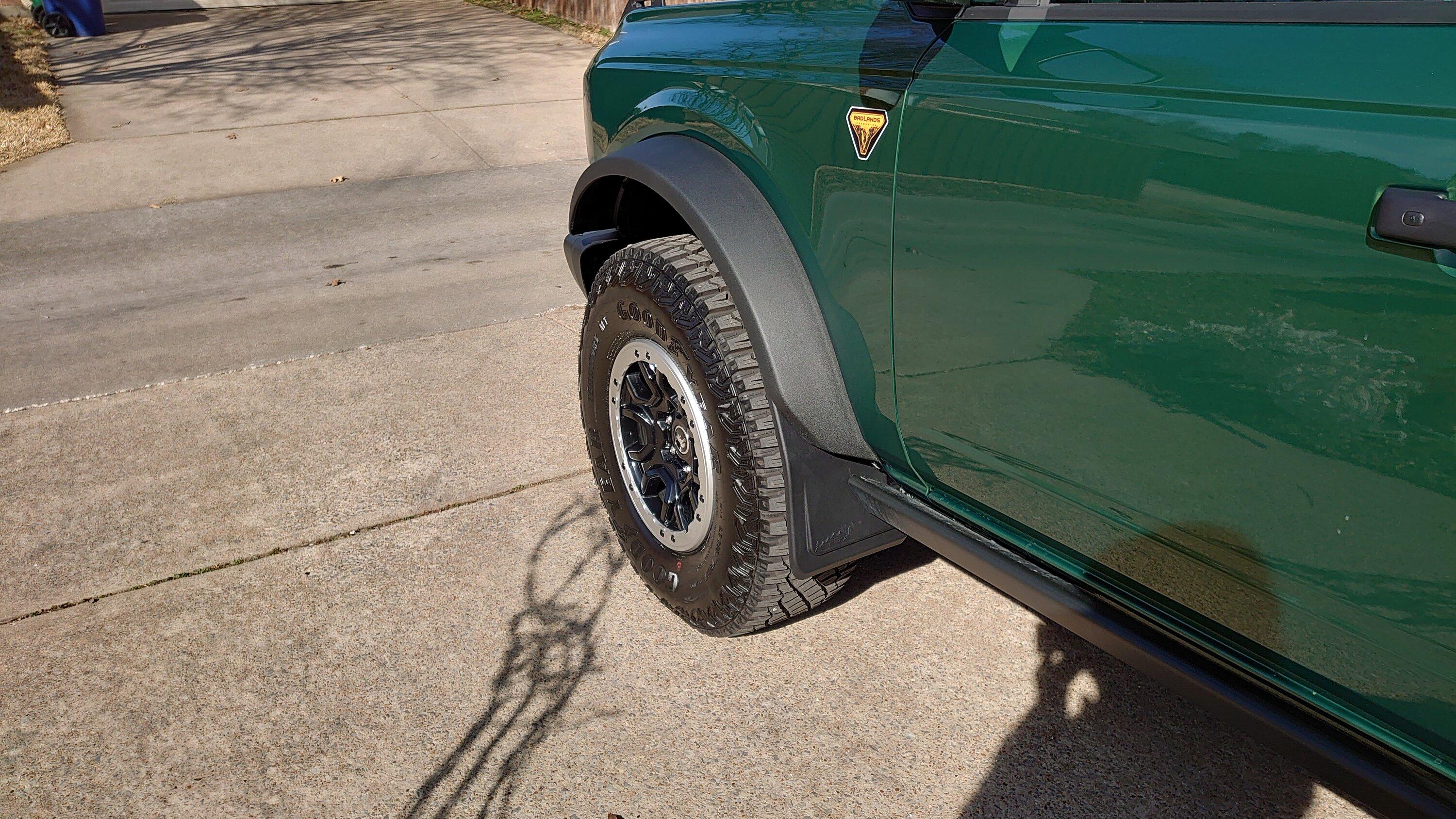

Installed mine (fronts) today. I'll take some better close-up pics tomorrow and post here. Easy install. They are very subtle and look very OEM.
I did what someone else mentioned and put some electrical tape over the painted surface before sliding on the slip nuts, to protect the paint.

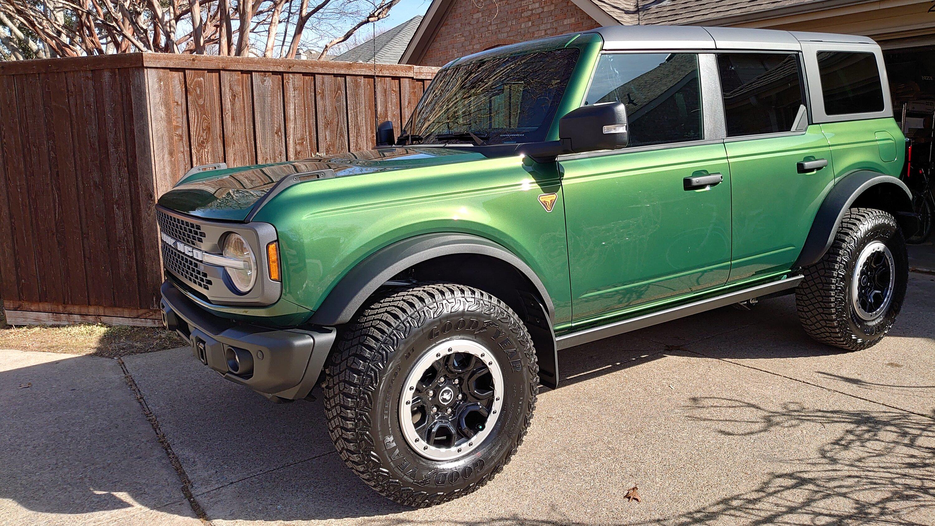

Some additional pics ...

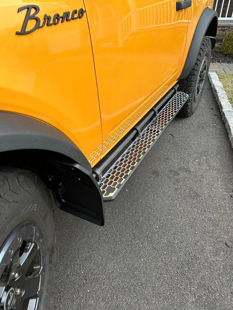

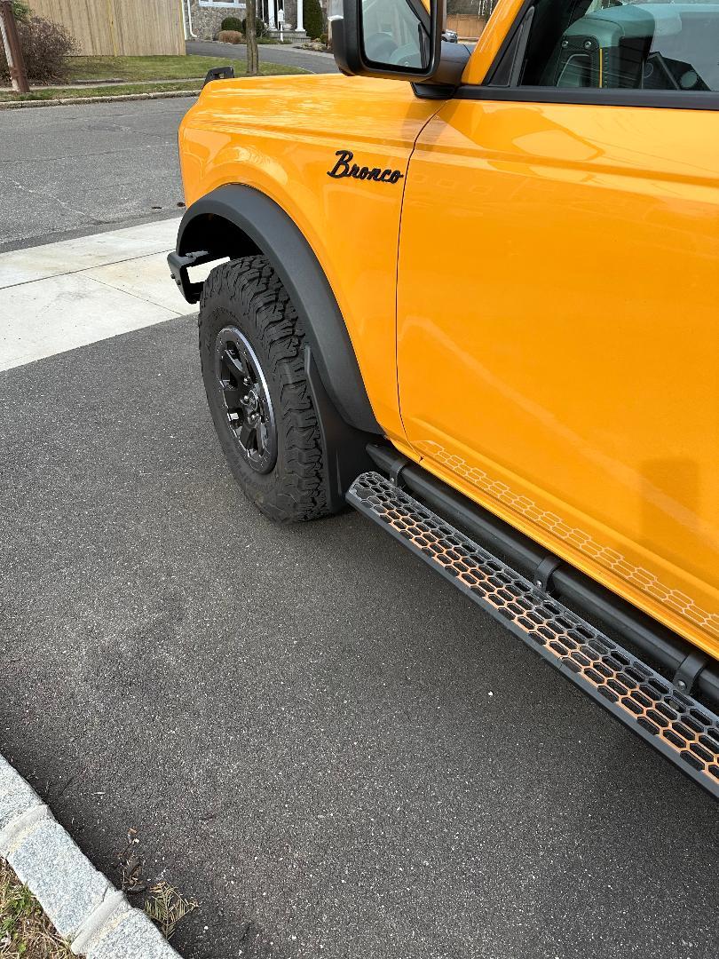

Finally got them on today.
The fender push pins drove me nuts. Had to get replacements at Auto Zone.
For the mechanically challenged (like myself) . . .
1. Tape on the fenders where the Mud flap clips are mounted is a wise choice to not scratch the paint.
2. Getting to the inner most push pin in the wheel well was frustrating - until I figured out that turning the steering wheel hard left or right gave me more access/clearance to get the push pin out/in when the damned tire wasn’t in the way. To be fair - there was too much alcohol involved at this point of the day.
3. The hard plastic mud flap & clamp need to be pushed in/adjusted to get the screws in straight.
Overall happy with the IAG Mud Flaps.
