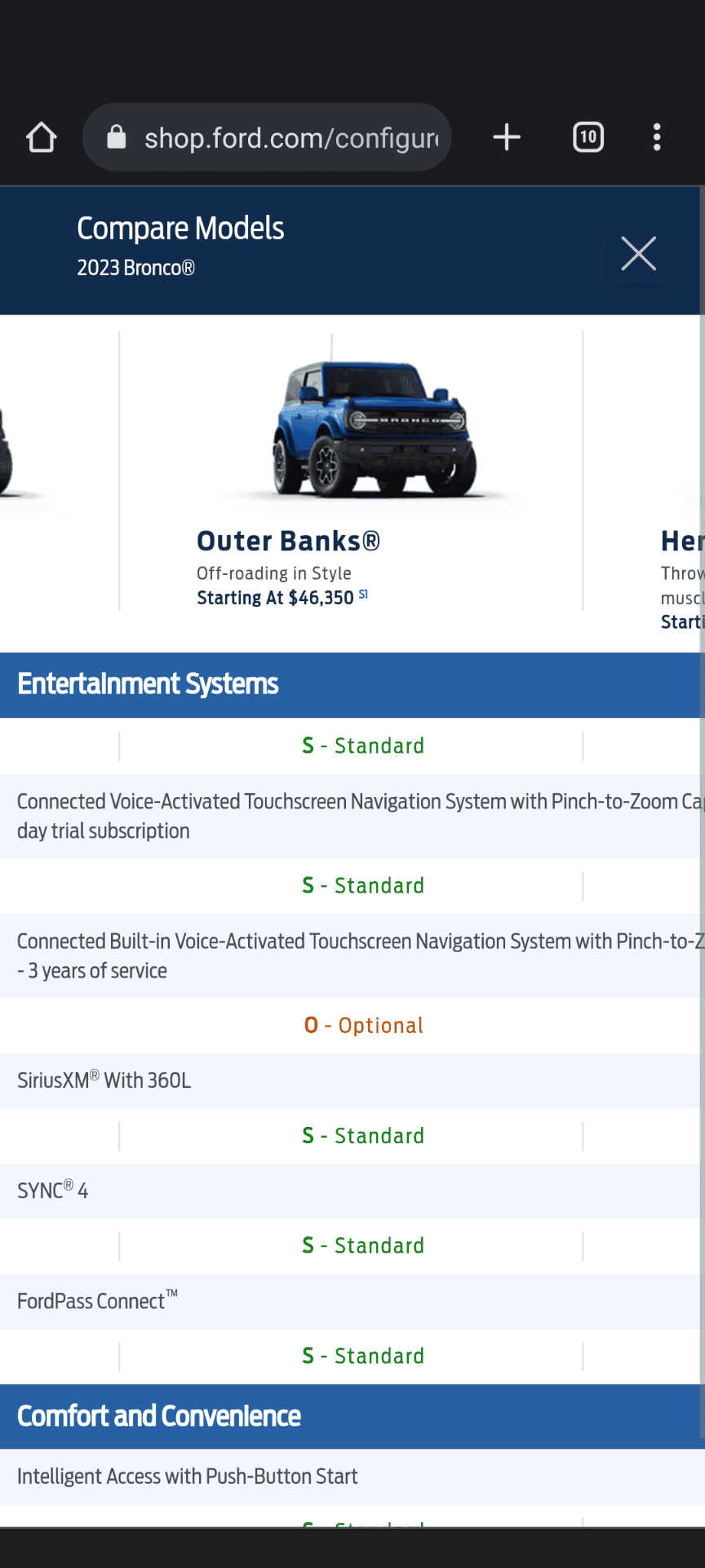

Should, don't know how to access since I'm waiting but ...
Ford Bronco No XM Radio? Screenshot_20230727-220046
Here's the owners manual too ...
