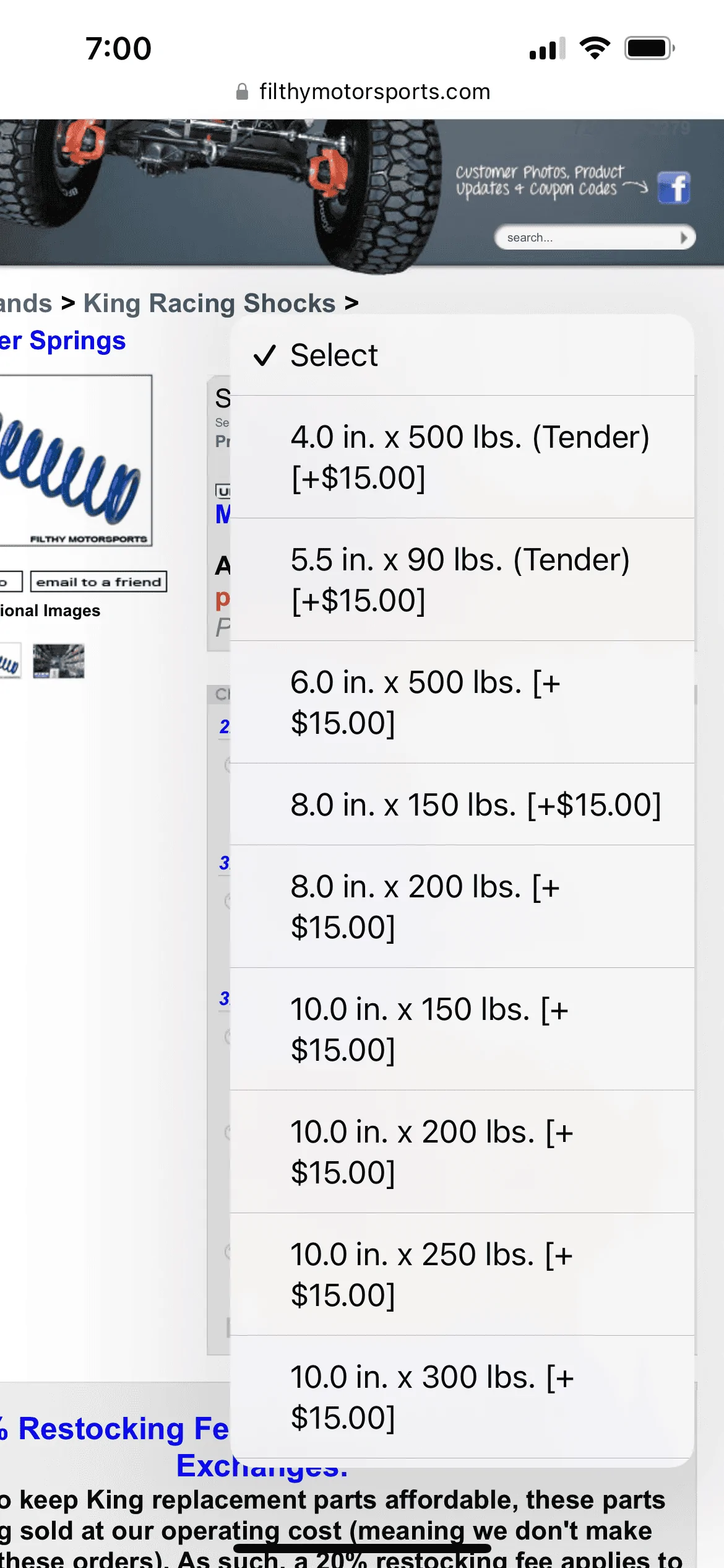

That is a tender spring that king uses. Tender springs are designed to be almost completely compressed at ride height. They help soak up smaller bumps and help keep tension on the springs when suspension droops out. The lower spring is a heavier rate, it hold the majority of the vehicle weight and kicks in when you hit bigger bumps.
Sorry, but this is incorrect. The Kings use a true dual rate rear, with the top being a stiffer 500 lb/in spring. It is not a tender spring. Just a secondary dual rate to get the total rate where King wanted them given the total length.

Well, King did respond back and they indicated they had not seen this issue for the Bronco yet. I assume they will get back to me on which springs to buy and replace. I think the total weight of my "stuff" in the rear is about 100 lbs. I would just think the factory setting would have easily handle 100 lbs back there. Later today, I am going to remove the fridge and the drawers to see what the results will be. FYI the top spring is SPR 3-4-500 E22 and the bottom is SPR 3-14-350 E22. Looking at the King spring catalog, the top spring is the only one they offer, for the lower spring they offer every rate from 150lb to 700lb in 50lb increments.

You need different springs for your kings

Engineering team got back to me and had some advice as they’ve encountered heavier Broncos already. We don’t make a heavier coil in that length. The 500lb coil on your shocks is what will work best. What can be done is to have the coil stop nuts, those silver rings that sit above the black divider, be turned to sit lower or right against the divider. This will allow the coil to lose some of the bind but will also result in lifting the rear up slightly. I’d recommend having a shop do this if you decide to go this route. The second option is to simply leave the top spring as is and let the shock ride completely on the bottom spring while the top spring serves to handle the weight of the vehicle.

You might have to check with eibach and see what they carry for that top spring
