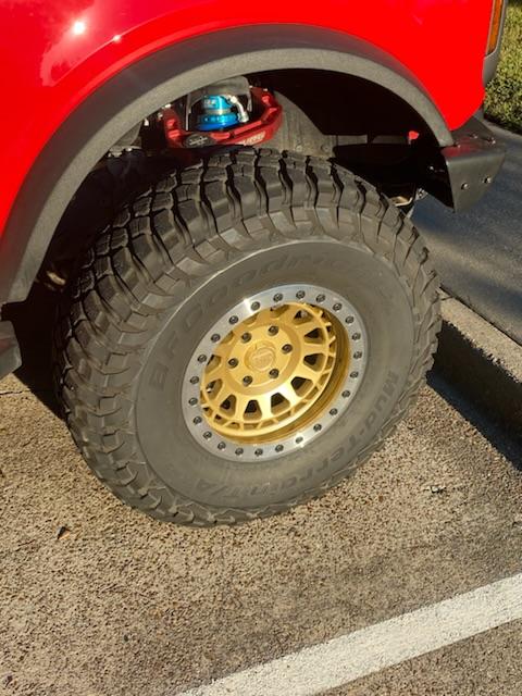

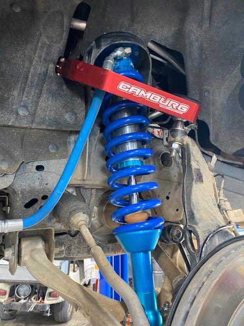

So I just purchased the King shocks and am pretty stoked. Of course I found this thread after ordering them haha. I was also about 1 day away from ordering the Icon billet UCA's too so thanks for that save!
I'm curious if the tubular Icon's will work with the King's... They seem to have more clearance than the billets. RPG is a decent option too I guess.
I am pretty light in the rear right now but have an aftermarket rear bumper on the way as well as a front bumper (only 37 lbs though) and a winch... Hope I don't have sagging issues. Really wondering on what UCA to purchase now though
FWIW, I put Camburg billet UCA’s on mine at the same time I installed the Kings and have had zero issues. Really happy with this setup.

Camburg tubular also no issues with clearance
