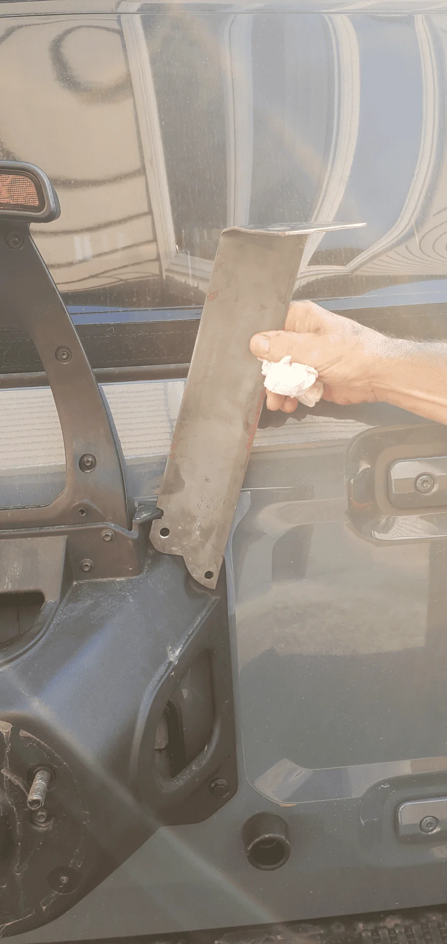

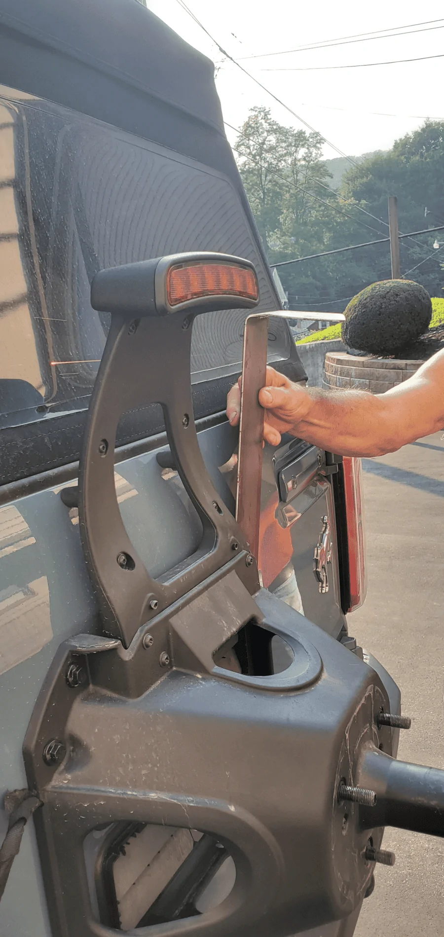

Just finished the rough fabrication of my antenna bracket. Still need to straighten it a bit, grind, sand, paint. Will also be adding some rubber to the back side just to be safe. I'll post more pics this weekend when I get time to clean it up.
@Cousin Eddie Any luck getting any further on your install? I think my CB antenna will be best suited for the rear tire or tailgate are too. Curious to know how your bracket worked out. I like the looks of it.

It works well; however, I did snap an antenna after driving aggressively on a bumpy dirt road. Too much flex in the bracket whipped the antenna to the point it failed at the plastic base. The bracket needed some stiffening or more padding between it and the tire/tail gate to stabilize it.

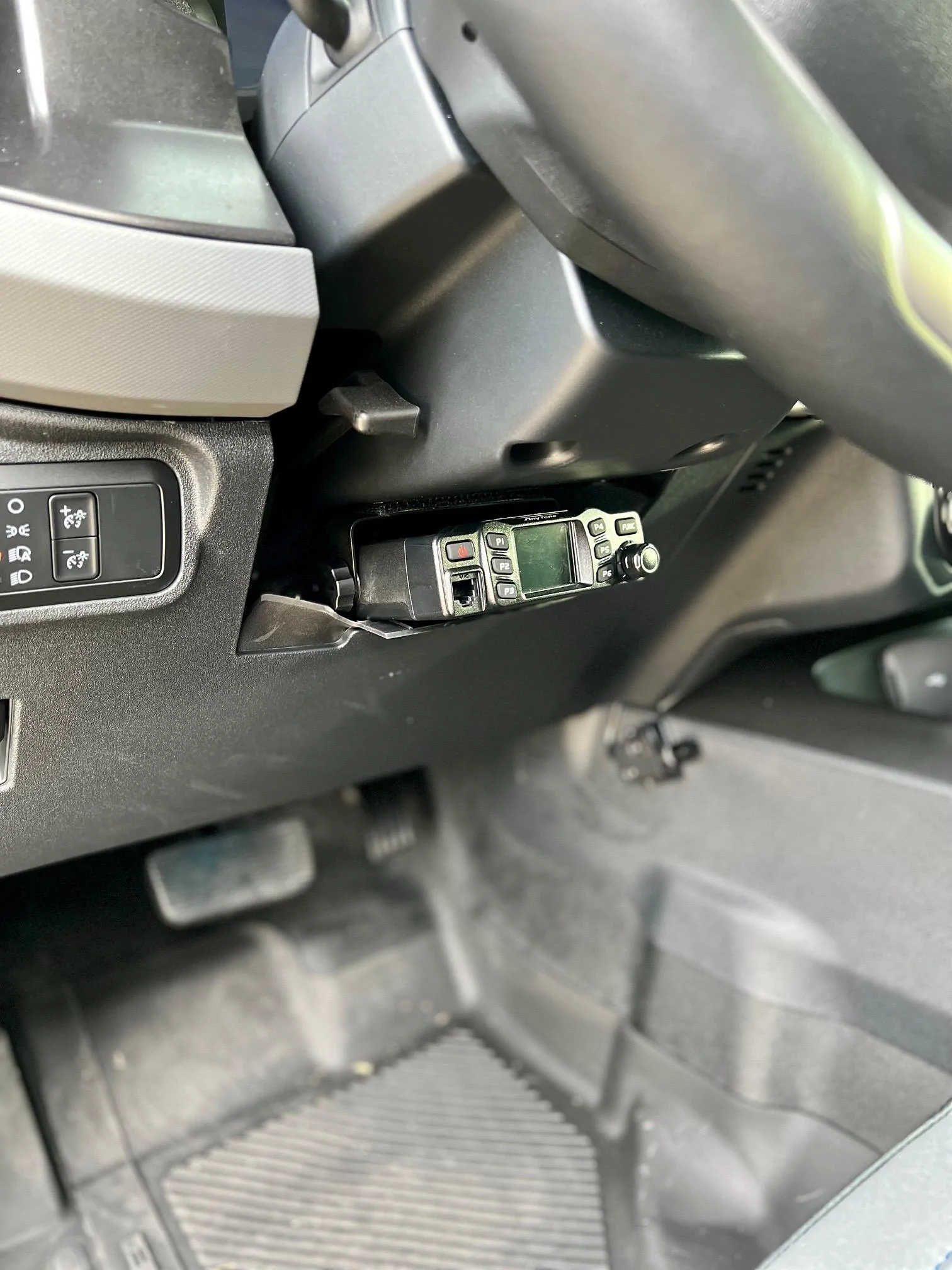

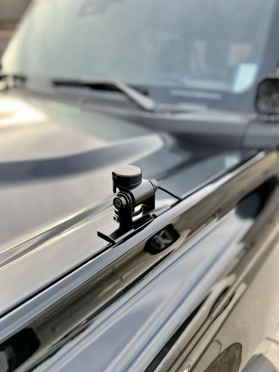

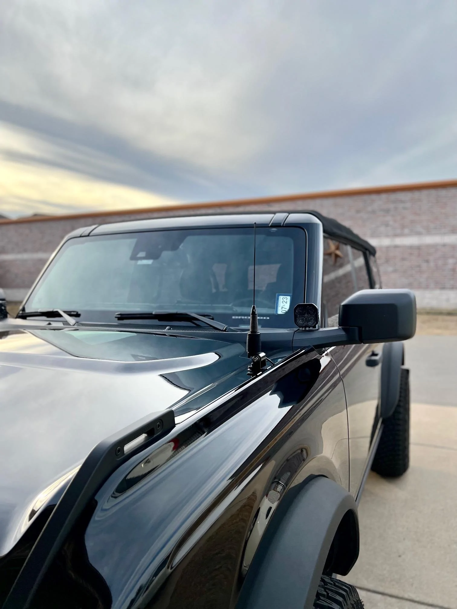

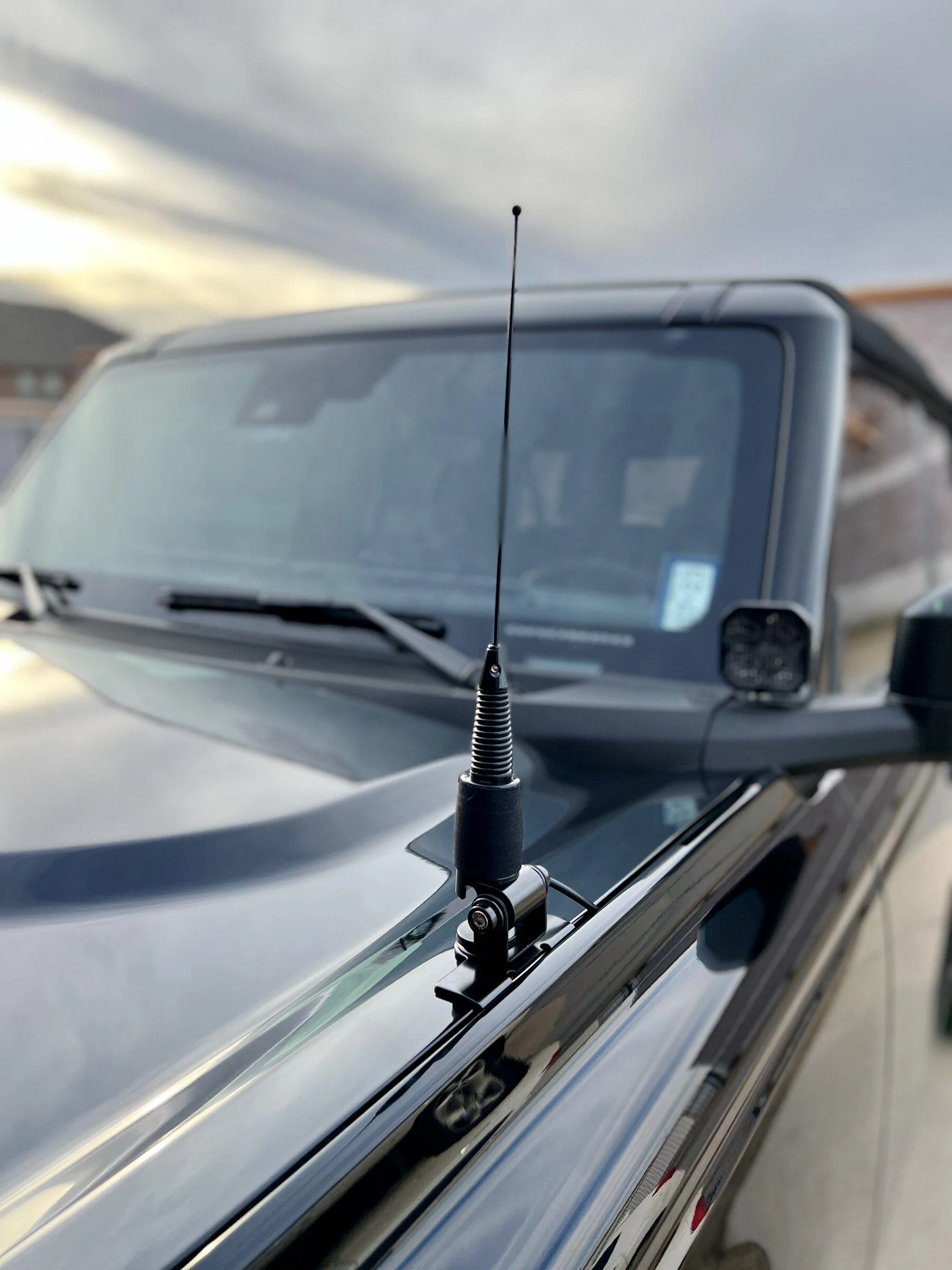

My setup
Nagoya NMO Lip Mount
Browning Antenna (GMRS tuned)
AnyTone AT-778UV Radio (temporary, Wouxun KG1000 on order)
Powered by Aux switch #6

Exactly, I forget its there half the time. I noticed there was a bunch of space underneath the steering column (after that metal bracket is removed) so I threw some velcro on the radio mount and just stuck it underneath. Those rubber flaps really sandwich it in there so it doesn’t move at all.
