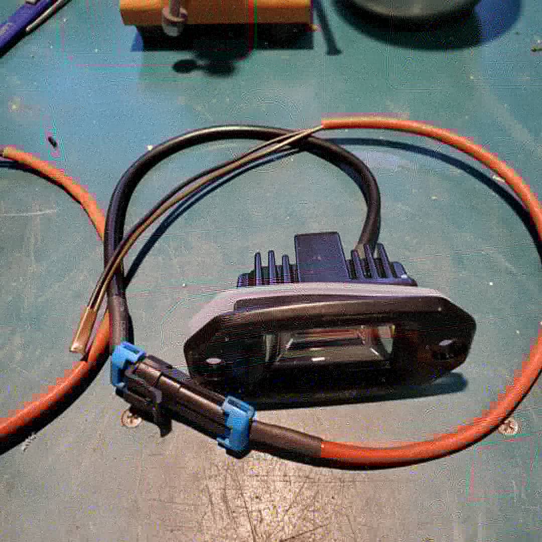

There are a 100 ways to achieve good lighting. You do need super high power lamps. I have a pair of these cut into my bumper. They pull like an amp at best and are way more light than I need. I swapped LED's for the factory incandescents and the combined load of all 4 LED's is less than stock. The Bronco will be different but it is a simple add.

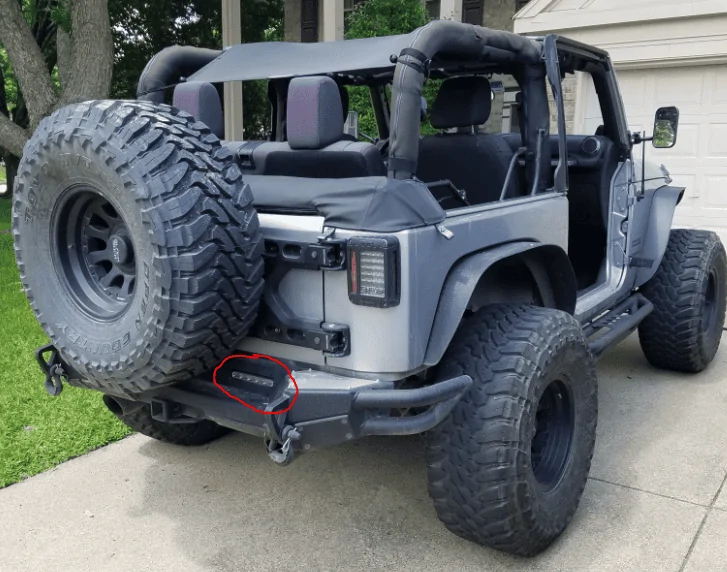

I'm sure there will be some aftermarket bumpers that integrate the rear lighting. This is what I had on my Jeep. I wired them to come on when I put it in reverse.

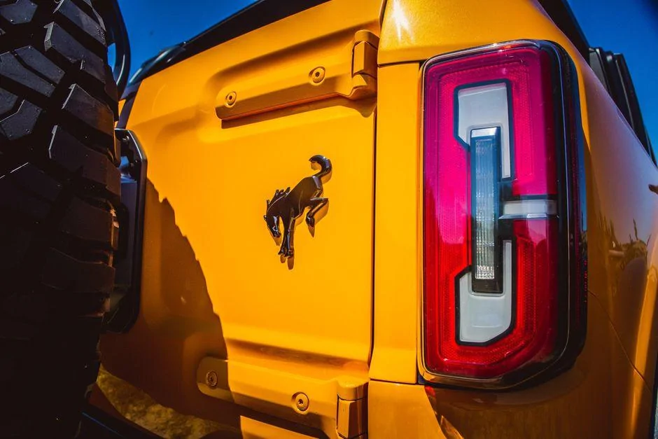

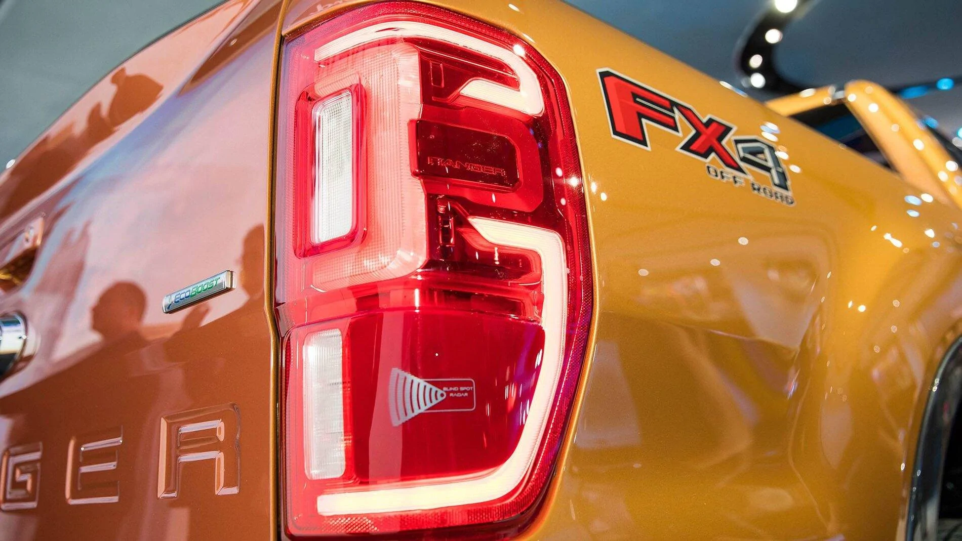

The reverse lights on Ranger with the BLIS package (LED tail lights) are quite bright, great dispersion and do an excellent job of lighting the area where the camera captures.
I am expecting the LED tails on Bronco to also be excellent as they appear to be comparable LED configuration for the white (reverse) section.
The big question is will we get these lights on the mid package Black Diamond?

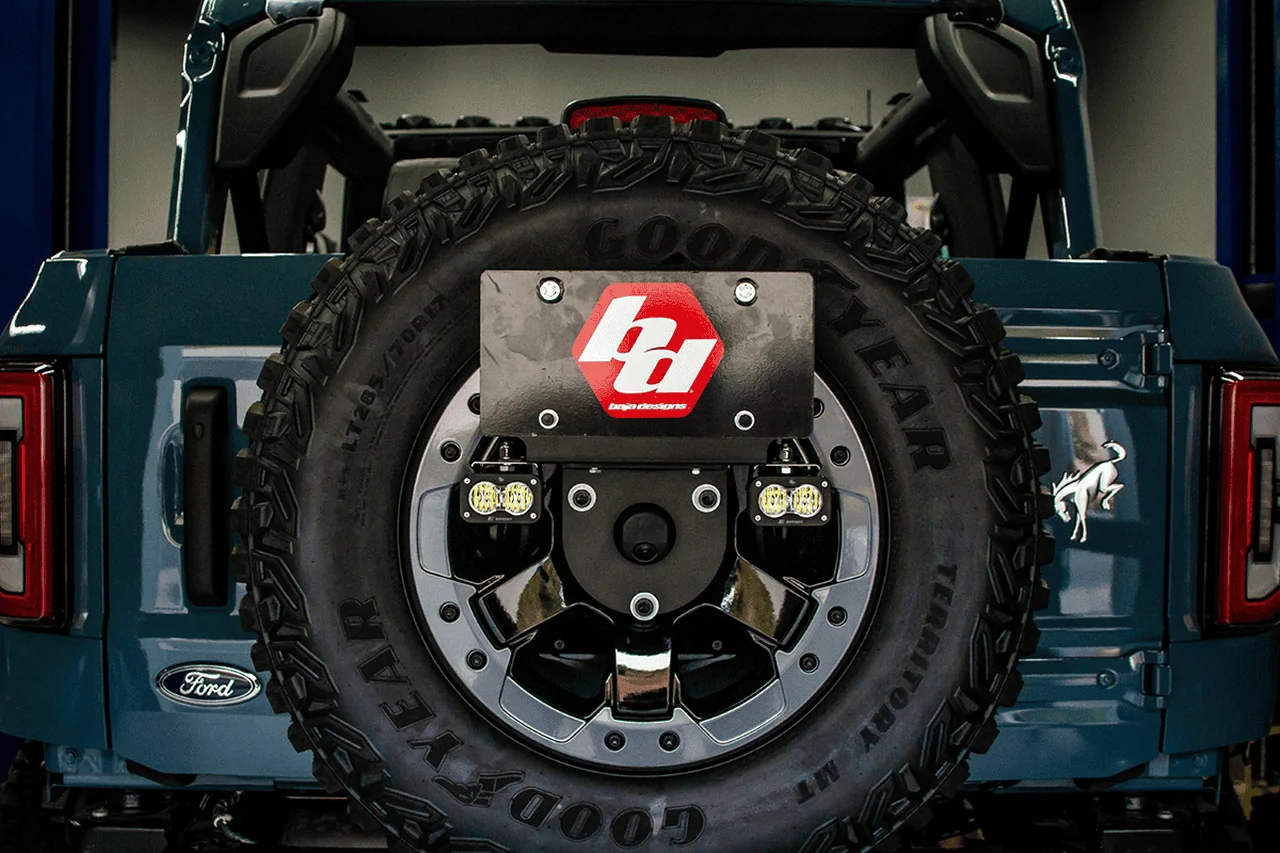

You can do the Baja Designs kits... 2 options
1) This kit attaches to the spare tire. It's a bit more "out there" in terms of styling:
https://www.4x4truckleds.com/baja-designs-reverse-kit-for-2021-ford-bronco/
(The license plate bracket is optional)
Ford Bronco Reverse Lights 1634578519895

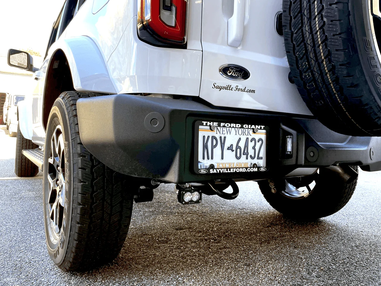

Another option, still using Baja Designs lights but we put together a kit that puts the lights under the bumper. Out of the way, note as noticeable and my preferred method (as I want them low and not screaming "hey look at me!!!")
https://www.4x4truckleds.com/2021-ford-bronco-reverse-kit-w-baja-designs/
Ford Bronco Reverse Lights 1634578569056
With the 2nd kit, this taps into your reverse lights automatically so when you go in reverse, they come on (you can also turn them on from a switch as well)

That’s second kit is pretty slick!

I see for the bumper mounted option there is a harness for tapping into the reverse circuit. Is this also available for the spare tire mounted kit?

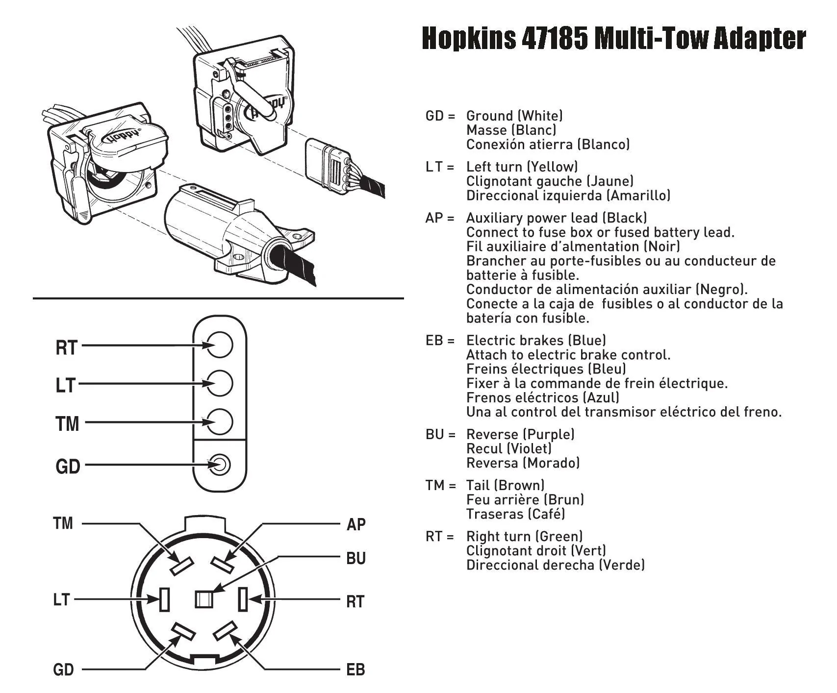

If you are ordering the tow package, the 7 pin connector will have a reverse (BU), ground (GD) and 12 volt battery source (AP), you could wire in a light package on these circuits for something with no manual engagement...
Ford Bronco Reverse Lights SchmTRL
